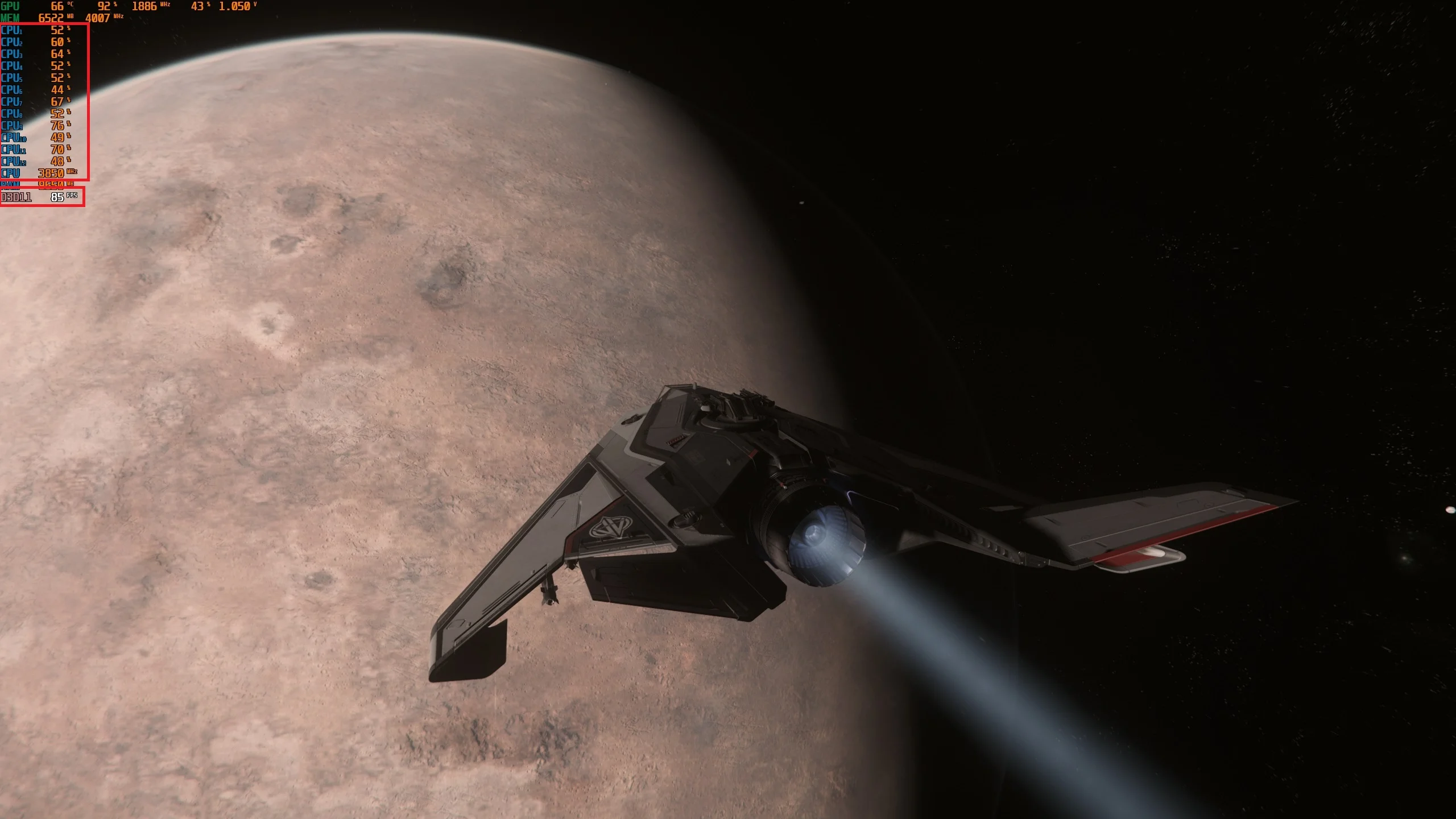

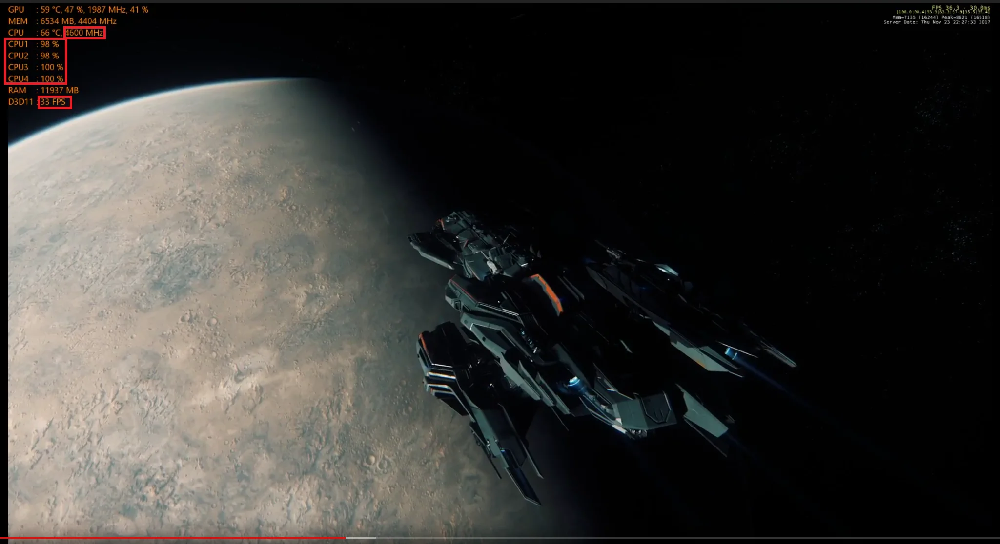

Core i5 4690K at 4.6Ghz. Notice the CPU is hard locked at 100%, the GPU is heavily bottlenecked and 33 FPS.
Second image is of my Ryzen 1600, about 70% load on it, GPU is at 92% and 85 FPS.
This is why i switched from Intel to Ryzen.
