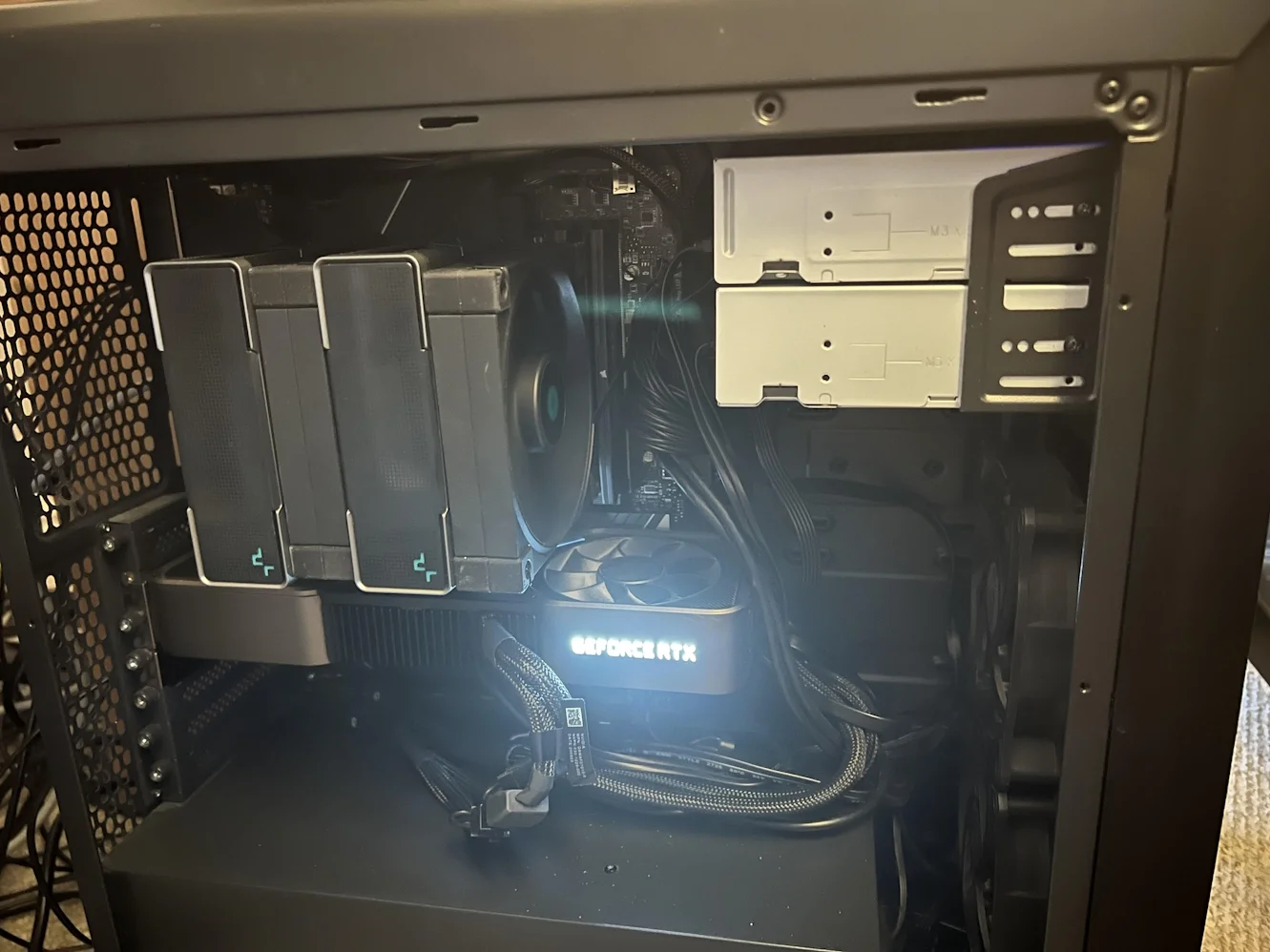

Sorry, would've helped wouldn't it. Case is a fairly cheap Falcon GameMax midi tower, which I don't think gives the best airflow, especially with my crappy cable management. I tried removing the side panel of the case, and it helped slightly - managed to do a complete Cinebench multi run without hitting 100C - only 98C :D
Other specs are 3080FE, DDR5 6400MHz RAM. Mobo is an MSI Pro Z790.

Side shot of case, for what it's worth:

No fans in the top of the case, but there is a decent sized vent:

Yeah, that system is going to need quite a lot of attending too in cooling terms. Turning the front fan speed up and adding an exhaust fan would be a good start. I would be tempted to fit a 240mm AIO in the front or go custom loop.

You need a rear exhaust fan. move one of the front fans to the rear for now
