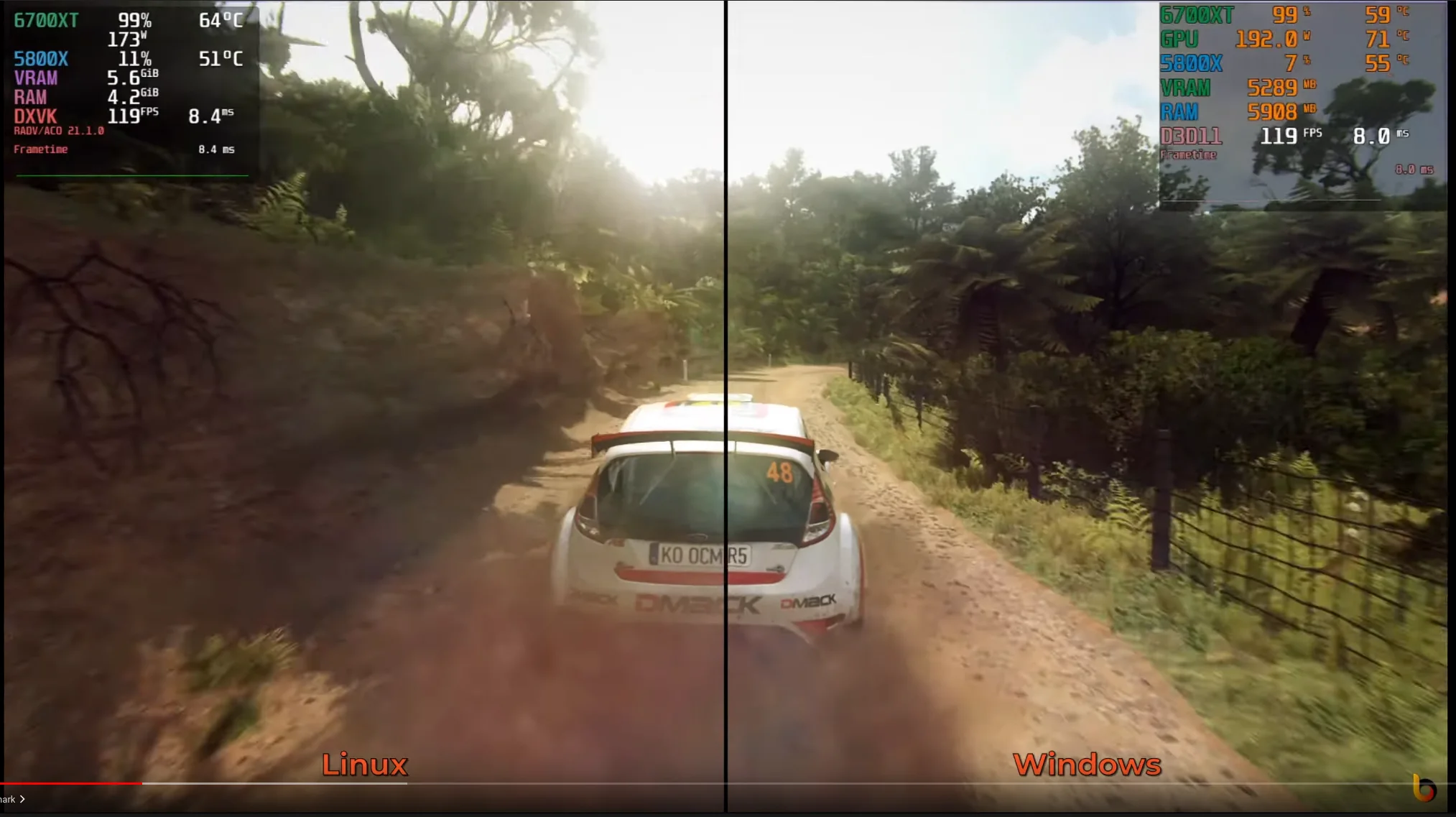

Now here is where it gets interesting. That is when using Windows. I'm currently using Pop_os(Linux) and while I haven't found a program that can read the hot spot temp the normal edge temp is lower compared to when running the same game in windows using stock gpu settings, card is being utilized 99% in both scenarios.
There are videos on youtube by a guy who does comparisons between Windows gaming and Linux and in one showcase the fps was identical yet in Linux the 6700XT sipped 20 watts less. It's weird and interesting.

Just the core power of the GPU dropped 20watts. I'll try and find the video and link it.

Source: https://www.youtube.com/watch?v=ywJUyUG3qWM @ 0:43
