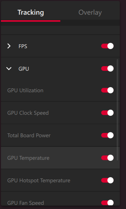

Does anyone know why half the metrics have disapeared off Adrenaline? I'm on 23.7.2. It's the same with CPU side as well. All I have is utilisation and temp.
I can't find the wattage anywhere on GPU side.
This got me too. The main sections are expandable now, just click on the arrow;
