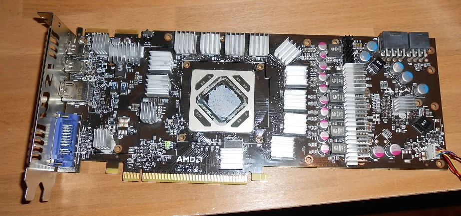

This is the best possible heatsink placement for the best possible VRM cooling on this card using the stock heatsinks.
You need to use Accelero permanent adhesive to get the best possible hold on the heatsink. Using thermal tape/pads or the included G1 glue is not ideal. It doesn't hold well like the adhesive does. Depending on where you get the accelero from it may come with the adhesive as standard. If you get an old accelero it will come with G1 temp glue.
You can buy Adhesive from Accelero here. It will he shipped from Hong Kong. If you want the best vrm temps and the best hold, i highly recommend you use it. - http://www.arctic.ac/en/p/accessories/587/thermal-adhesive.html
Notice there is a black heatsink. That is from this piece of kit here. - http://www.overclockers.co.uk/showproduct.php?prodid=HS-038-AL&groupid=701&catid=2330&subcat=787
It was only slightly better than the stock Accelero long thin heatsink which i had there before so you can use either.

As for your question, just try placing them on (no TIM) and see if they fit :)
I wondered the same thing about the small heatsink at the bottom when I fitted mine. In the end, I went with playing it safe and just stuck to exactly the sinks in that picture as I went from the same review.
After getting it all together and in place, the only thing I would do differently would be to use the larger, angled heatsinks on the right hand side with the overhangs pointing towards the power connectors on the card. This wouldn't have any issues with clearance in this area, and it might keep what's under them (memory?) a little cooler, which never hurts.
I've seen some people moan about the glue not seeming like it's going to work, so they used thermal pads, etc. I simply used the glue they provided, put the heatsinks on at 10pm then returned to finish it off at 9am the next day. All the sinks have stayed in place during use and I've had zero issues.
I was pretty nervous doing it, but it actually was easier than I thought it'd be from the pictures, reviews, etc, and I've loved the difference in noise, temperature, noise and noise! :D
Which one do you mean? Could you mark it on the picture.

Before you fit the heatsinks you remove the mounting bracket from the cooler and temp fit it to the card. This enables you to space all the sinks correctly as the mount covers part of the bottom memory chip.
I used the right angled sinks on the PWM chips the rest as the pic above.

At work at the moment (and sneaky posting) so better not fire up MS Paint! I was referring to the last long line of sinks on the right hand side of the picture, the ones next to the line of black square boxes with "C" on the top of them. The top one is a thinner sink, then the rest of the line are slightly thicker ones. Looking back I would have replaced all of these with the angled sinks just to give a little more surface area, but not sure this would actually make a blind bit of difference in real life.
