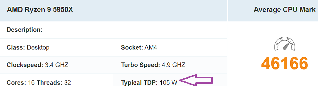

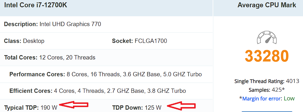

When the AMD typical TDP IS LOWER than Intel's TDP Down :cry::cry:
