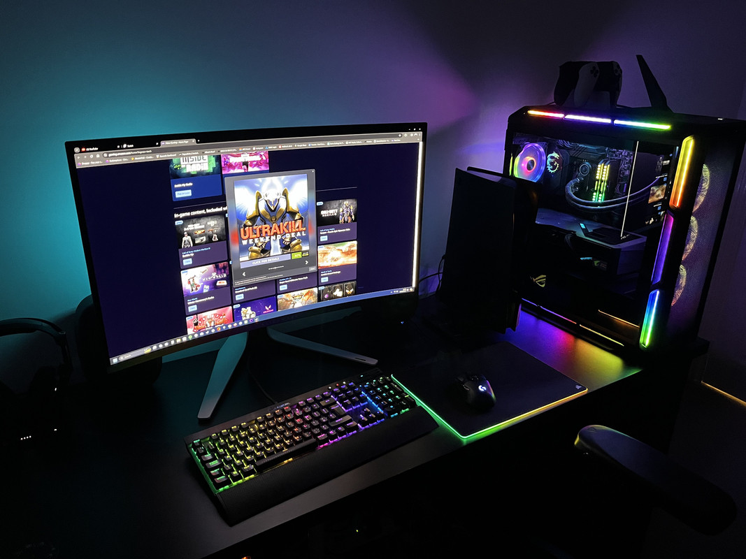

Set these up, got them for £90 from the rainforest. Wow, wasn't expecting much but the speakers are a good size and pack a punch! Anyone wanting to use these they work perfect, got them running Bluetooth to the PC, connected instantly no dropouts that I've noticed. Then running them via the ARC connection to the Dell eARC port. Working perfectly! So anyone wanting to use a PS5 and the AW3225QF I can confirm this works 100% via ARC. Tried USB to USB to PS5 but that didn't work at all. Might help a few people!
Glad it worked out for you :D
You seem the type of guy who even has an RGB bog-roll holder!!!!
:p
