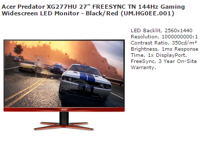

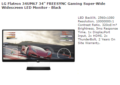

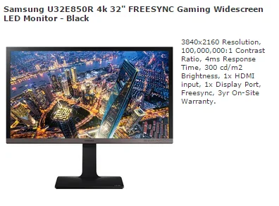

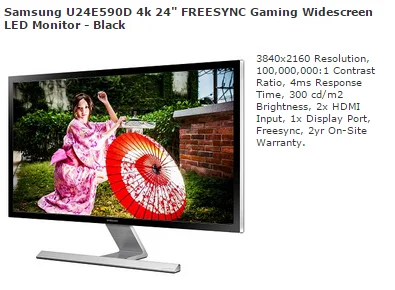

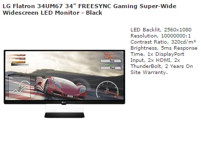

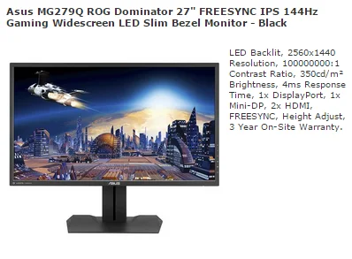

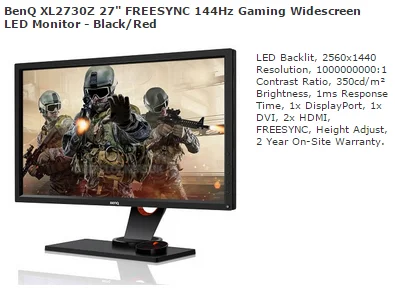

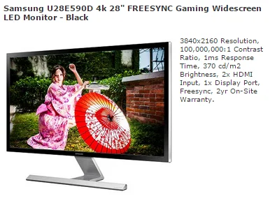

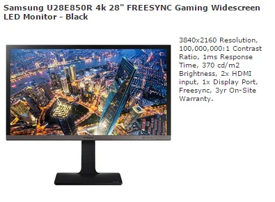

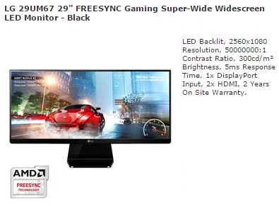

http://www.overclockers.co.uk/showproduct.php?prodid=MO-127-LG&groupid=17&catid=948
https://www.overclockers.co.uk/showproduct.php?prodid=MO-128-LG&groupid=17&catid=948
http://www.overclockers.co.uk/showproduct.php?prodid=MO-078-AC&groupid=17&catid=948
http://www.overclockers.co.uk/showproduct.php?prodid=MO-113-BQ&groupid=17&catid=948
https://www.overclockers.co.uk/showproduct.php?prodid=MO-083-AS&groupid=17&catid=948
https://www.overclockers.co.uk/showproduct.php?prodid=MO-213-SA&groupid=17&catid=948
https://www.overclockers.co.uk/showproduct.php?prodid=MO-214-SA&groupid=17&catid=948
https://www.overclockers.co.uk/showproduct.php?prodid=MO-215-SA&groupid=17&catid=948
https://www.overclockers.co.uk/showproduct.php?prodid=MO-216-SA&groupid=17&catid=948
https://www.overclockers.co.uk/showproduct.php?prodid=MO-217-SA&groupid=17&catid=948
