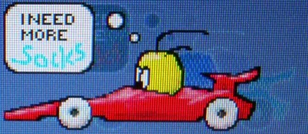

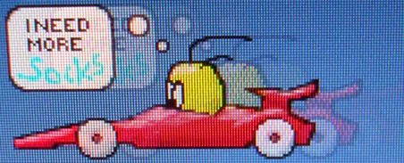

I switch it off on both my BenQ monitors. I see it added more ghosting with it on.
That's incorrect I'm afraid mate, switching it off actually increases G2G response times.
Here is an image with it off:
Here's with it set to high:
Here's with it set to premium:
As you can see neither is ideal but the high setting has the least noticeable ghosting.
