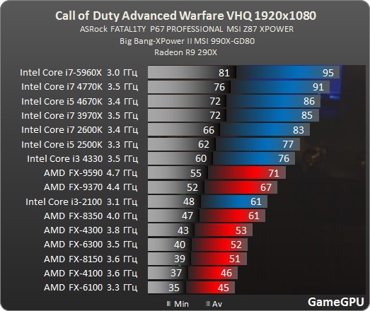

It's just about the extra performance a I5 would give you in games, compared to an AMD chip.
Even when overclocked to 4.7Ghz+, they are still slower than an I5 at stock.
See below as an example:
The top AMD CPU is an FX 9590 - which is running at 4.7Ghz. It's an identical CPU to the FX8320 - just with a higher stock speed.
FX9590 has a listed TDP of 220W, so it's safe to say that those overclocking their CPU's to 4.8Ghz or even 5.0Ghz are using at least 220W, most likely more.
That's a very hot CPU consuming a lot of power.
The alternative? I5 4670K, which is considerably faster in games than a 4.7Ghz+ overclocked FX chip. It has a TDP of just 84W, will run much cooler also (at stock, vs heavily overclocked FX).
Bear in mind that you can also overclock the I5 if you want to, which would give it even more of a performance advantage, though the temperatures and TDP would obviously increase from stock.
Also, the graph only shows the I5- 4670k, which is an older model. The I5 4690k is now available, which would be a few fps faster than it's predecessor (88W TDP, small increase from the 84W of the 4670k)
My point is, if someone is buying a new CPU/Motherboard today for gaming, then it's extremely worthwhile to save the extra £70 or £80 for a I5, as you'll get a much faster CPU in games, up to date motherboard technologies, cooler running and quieter system.
If someone really can't or doesn't want to spend the extra £70 then the AMD setup is viable, though I'd still recommend they just saveup for the I5.
</Plug>
This I'm afraid I cannot believe. I won't go to the trouble of finding benchmarks to counter this as I am sure it is already a biased horrific example of a proper comparison benchmark.
Just throw in a handbreak rip or the cinebench to see how they outperform i5's especially stock ones!
Also you keep mentioning the TDP which many people on here do not understand. As soon as you overclock (even an intel) your TDP references go out of the window!
My last point as I grow tired of these pompous intel posts, you always use the 9590 as a tool to prove a point. Savvy users will pick up the new 8320E and overclock it to speeds as close to 5Ghz as they can push. For a £100 price tag this cannot be beaten by any intel offering. The price/performance of this combination is a great budget solution. If people are willing to pay for the higher binned models or crazy enough to get the 9590 then that is their choice (where I would switch over to an intel for that price point - i.e. an increase in budget of £100+).
