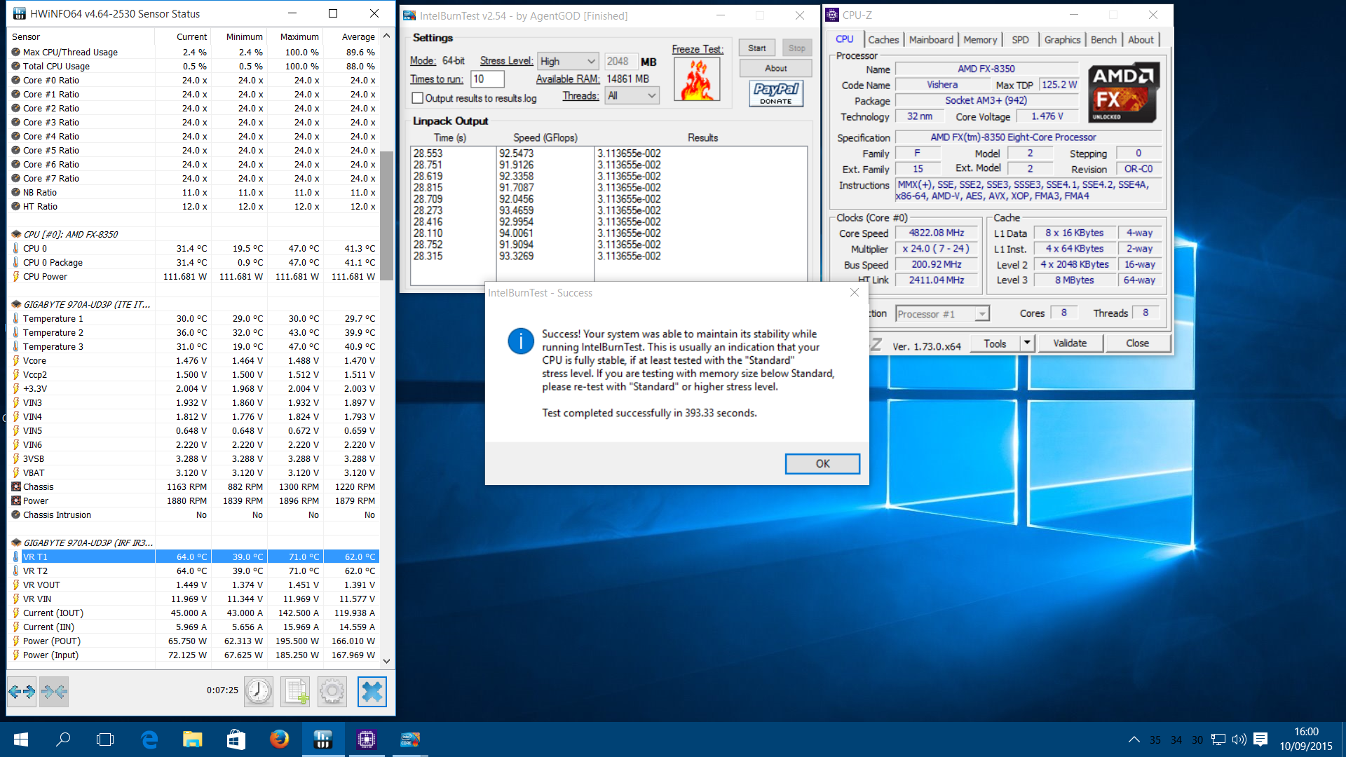

Ok so should run at full speed then and i done a run of ibt with a 8350 @4.8, with a custom loop, these are the temps i get
