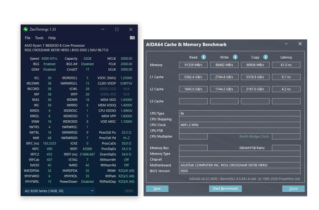

here's my tweaked ram settings.
https://imgur.com/a/6McZWKS
Any idea why is CPU VDDIO 0.87?
Your latency is sky high. It’s about 10ns higher than it should be.
Your TRFC is double what it should be, and
Trefi is only 15,000 when it could run at 65535
Tras and trc are at least 5x higher than they should be too.
Although X3D chips aren’t RAM sensitive, you’re totally gimping your system running timings this bad.
My first time playing with DDR5 so just banged in some numbers for my ram to get the ball rolling as I don't have an expo profile, I'd imagine there is quite a bit of headroom once I dial it in fully.
Those are some bogus aida numbers - looks too out of date I think - single CCD chips cannot hit those read speeds for example :)
I haven't played with timings at all I just set expo and some voltages that's it.
I'm using this ram: https://www.gskill.com/product/165/390/1723430443/F5-8000J3848H16GX2-TZ5NR
DDR5-8000 CL38-48-48-128 1.45V
So recommendations welcome!
Well, even easy YouTube Buildzoid (Actually Hardware Overclocking) timings would be vastly superior to those god awful timings. Look up his easy Hynix timings. Given you have an 8000 kit, it’s guaranteed A-Die.
However, I can provide you with some tighter timings myself that ‘should’ run, but I can’t guarantee it. All this assumes that you’re comfortable doing timings in the BIOS.
My suggestions just off the top of my head for A-Die would be -
Set trfc to around 500 and trefi to 65535 asap. Those are killing your latency.
Then TRAS to 52. Set trc to 100. Tfaw to 32. Twtrs to 4. Twtrl to 16. Twr to 48.
RDRDSCL and WRWRSCL both to 8.
Trp to 16. RDWR to 20. WRRD to 6
Put 1.45v into VDD and VDDQ
