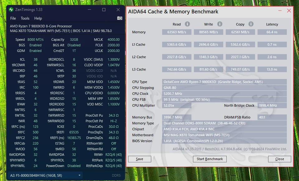

Those are some bogus aida numbers - looks too out of date I think - single CCD chips cannot hit those read speeds for example :)
Yeah I think you're right, updated aida now.

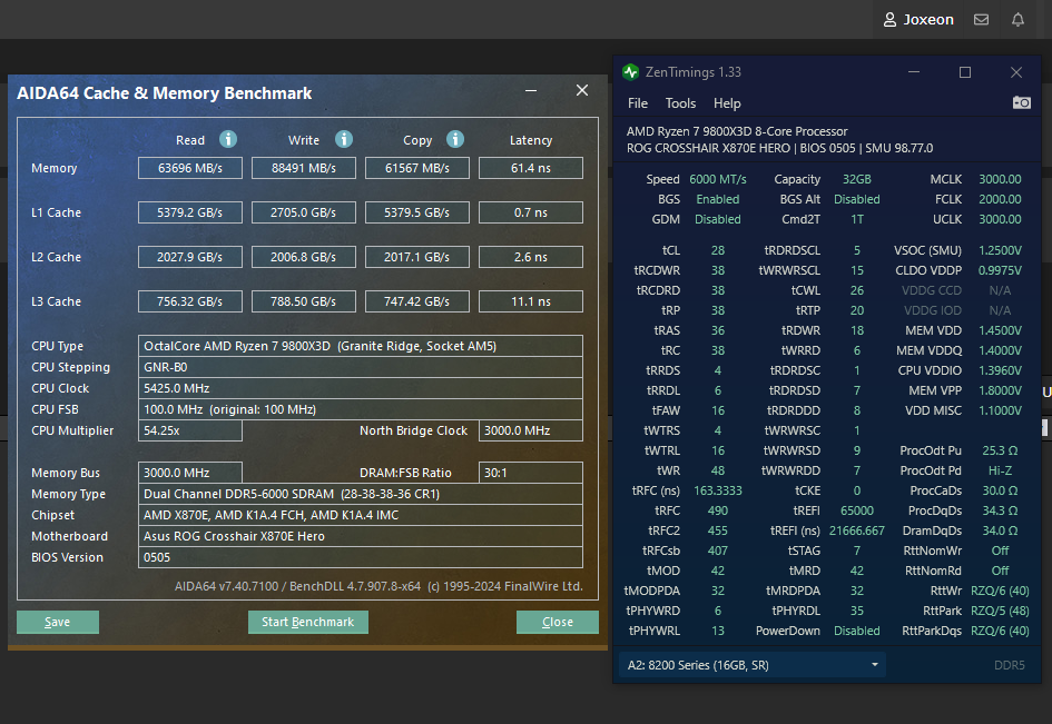

how do I post a picture in the chat posting the above link with https or http doesn't seem to work lol

cinebench 24
from 1420 > 1470 multi core
137 > 141 single core.

Ahh, so my timings were mostly good? Nice. That latency is so much better. Game performance should have increased a lot too.

Been playing a few games today, and virtually all of them show some improvement at 2200. Others are around the same. But yes, I thought it was true that latency will rise slightly when going higher and out of ratio.
In my case though, it’s 0.2ns, and the performance increases far outweigh that.
