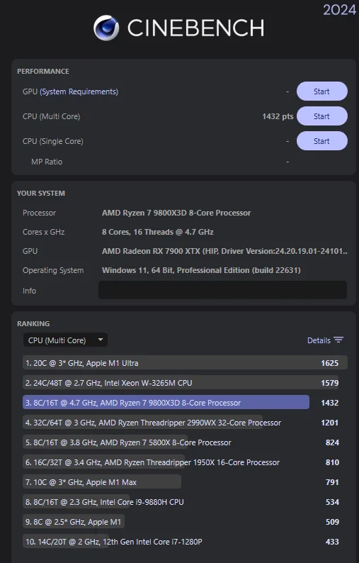

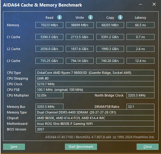

Results of testing 2133 vs 2200FCLK at 6400CL28
2133
2200
TLDR
2200 FCLK yielded around a 25-30pts improvement in CB24 and about 60pts in Timespy. Very slightly higher latency in AIDA64(0.3NS) but higher R/W/C figures. The gains in Black OPS 6 were actually quite significant, improving average frames by 24fps, and the 1% lows by 10FPS. Of course that isn't really percivable at these high frames, but it's an improvement nonetheless and more than I expected to be honest.
After testing in Linpack Extreme, I did see some GFLOP dip, meaning that 2200 was unstable at my previous VSOC of 1.27v. I was able to lower the VSOC to 1.18v and Linpack GFLOP throughput now seems consistent. Will need to retest RAM stability again, but suspect it should be fine.
2133
2200
TLDR
2200 is not stable, try 2167. Aida latency should go down, if it goes up or stays the same FCLK needs to be dropped.
In general or for me personally? Isn’t it typical to see a slightly higher latency when raising FCLK past 2133?
I have lowered the VSOC from 1.27v to 1.18v and the GFLOP figures in Linpack are consistent. Testing with P95 Large FFT’s now. Currently at 1 hour with no errors.
As far as I know, raising FCLK will also increase latency, but in turn, increase bandwidth. I think it is typical to see a slight latency increase when going from 2133 to 2200. It does not mean it isn’t stable.
Unstable FCLK is hard to test for, but fluctuating GFLOP throughput on Linpack report is one sign. I was getting throughput drop at 1.27v VSOC, but am not at 1.18v. Testing Large FFT on P95 is also another way to test FCLK stability as it is very hard on the IMC. No errors at one hour.
