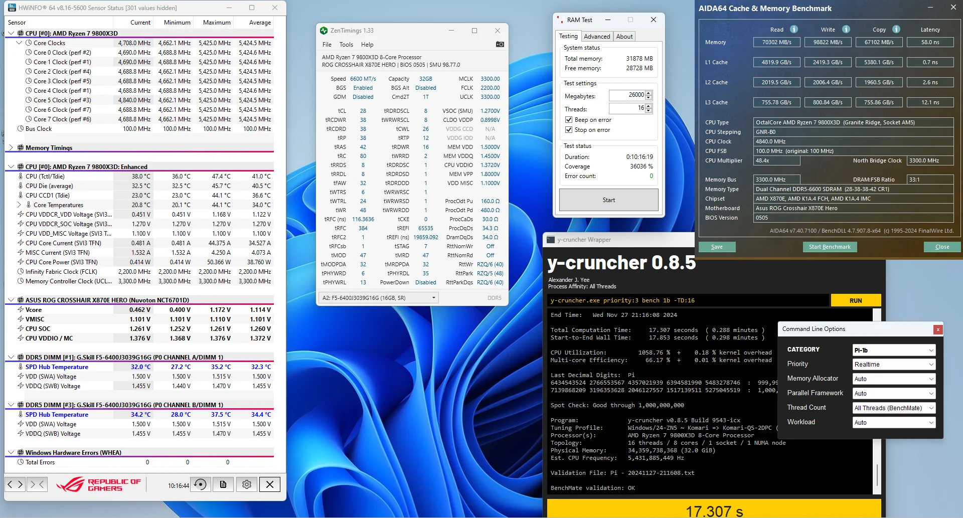

Started testing memory 6600c28

Some further tuning on a different sample. It has weaker IMC (6600 1:1 is not possible), but the cores are a bit stronger and it does 2233Mhz FCLK.

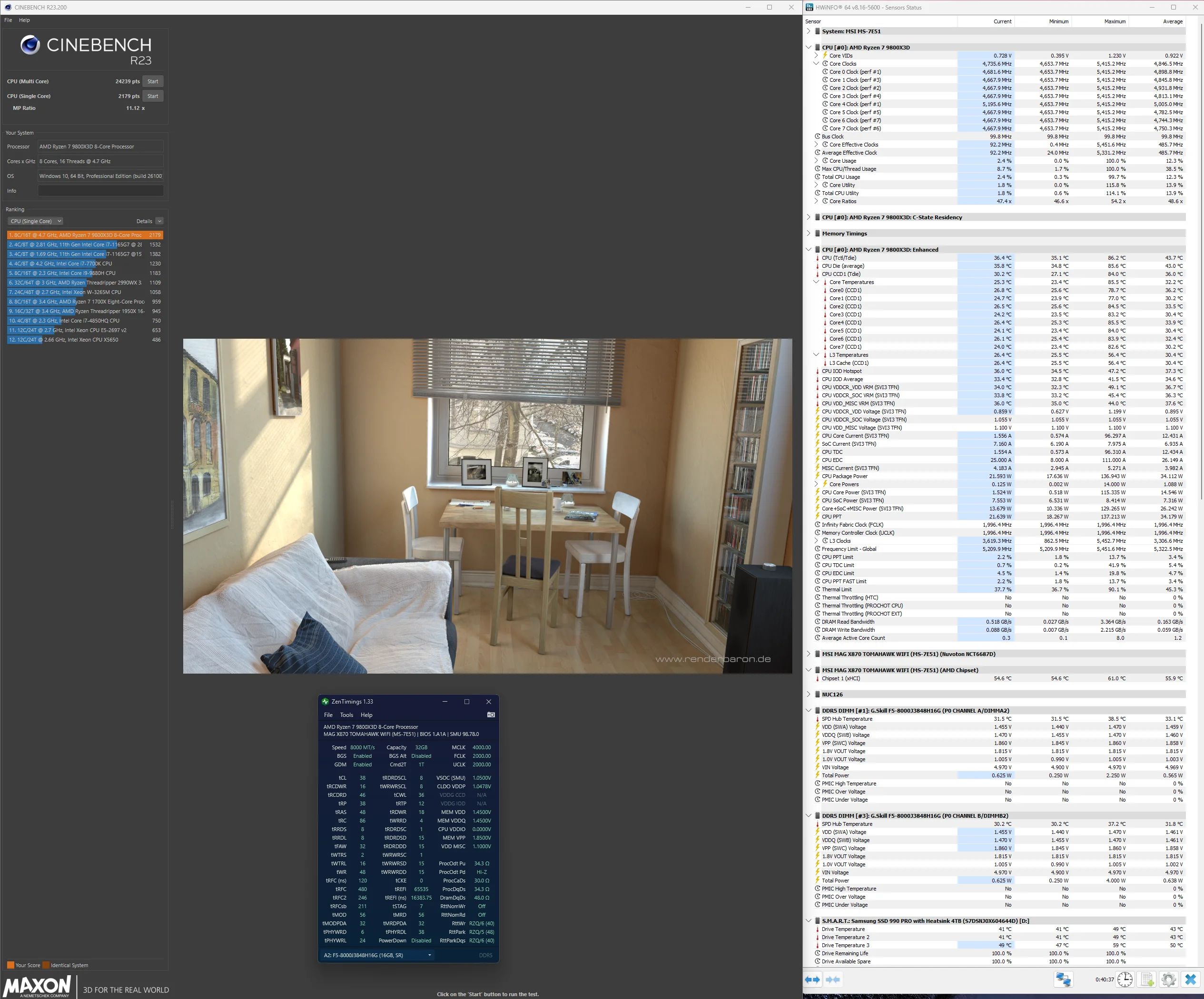

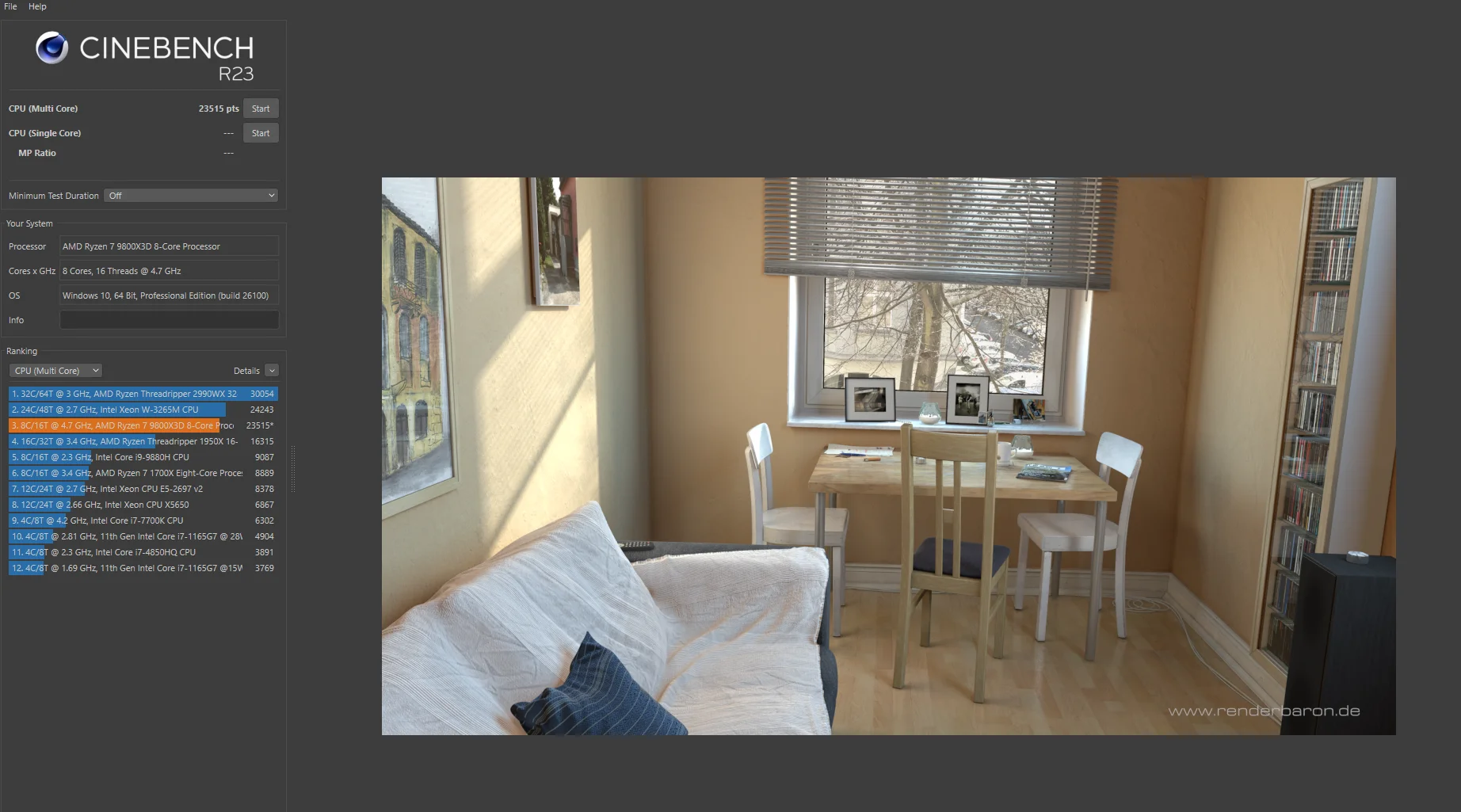

So this is with PBO enabled +200mhz -30 curve x10 scaler, ram has had it's timings tuned.
I just ran again with x1 scaler and got 10 pts more so there's no difference for cinebench
That’s expected as scalar allows the CPU to use a bit more voltage for an extended period of time. More voltage, lower clock speeds. More negative curve optimiser, less voltage higher clock speed and score.
