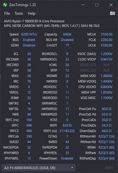

I am booting at 6600CL32 1:1 2200FCLK, so think my chip is pretty good. That’s with GDM on though, and it’s proving extremely difficult to try and stabilise.
Funnily enough, I’m even having issues getting 6400CL30 stable without GDM, even if I pump through quite a lot of voltage. I have stress tested the FCLK at 2200Expo and it’s stable.
Keep going for 6400CL30/28 GDM on, or go lower with hopefully GDM off?

M-Die. So far, this is looking stable.

Oh for sure, obviously. But given I was booting at 6600 1:1 and getting a small amount of errors, it was close. Think 6400 is where I'm at though. Above screenshot has been error free in Karhu for a couple of hours so far.

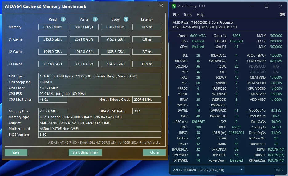

@Cenuij this is what I've ended up with... basically stock EXPO with a few Buildzoid settings and decreasing tRFC as you recommended.
Not great, but I'm only gaming so I'm sure it's fine. I did get away with the -35 curve optimiser and some people can't do -20, so there's that I guess :o :( :p
