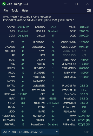

9800X3D 6600C26/2200 FCLK.
1.3 SOC (passed a Karhu test last night at 1.275v)
1.71 VDD (in the process of lowering to 1.7-1.69 VDD)
1.58 VDDQ (not adjusting)
1.45 VDDIO (not adjusting)
1.150 VDDP (not adjusting)
