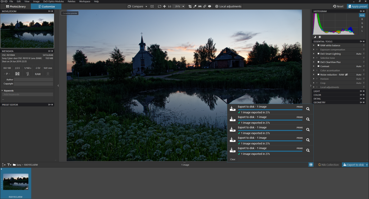

This same CPU scored 528 in a different motherboard which would only boost to 4575Mhz but in this one that normally boosts to 4625Mhz it scored sightly less, which was not what I expected. On the plus side this motherboard scores 200 points higher in multicore at stock, which is higher than most I've seen. As this is mainly used for multicore work I'm happy with that.
When I was assessing which system I wanted to use for my photo editing, I just wanted to get the fastest one, be that just 10% faster, it didn't really matter, I just wanted to get the fastest for my usage within reason.
I couldn't really find any reviews on Puget etc that fitted my particularly workflow or with the systems that I would likely be running. I even had chats and help from @CAT-THE-FIFTH so thanks to him for his assistance.
I decided to get both systems so I could test for myself exactly which one would be the fastest. My 9700K uses ~147w at full load and the Ryzen 3900X ~142w so power usage wasn't really a concern. Though the 3900X is brilliantly efficient.
It turned out that the 9700K is ~12% faster at 5.2Ghz and at 5.3Ghz 18% faster, though at 5.3Ghz the VRM's on this Z370 are begging for mercy so I've got a Z390 board to drop in.
When you're getting through 1000's of photo every percentage or second is a help in the right direction.

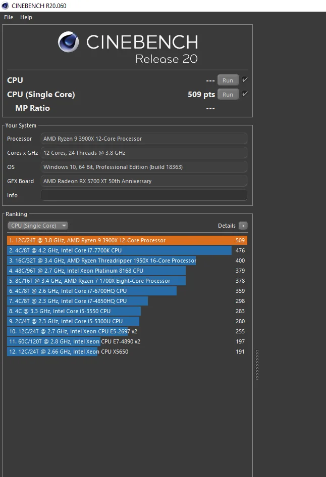

Yeah, Okay. Back to Single Threaded performance.
Here is my tuned 3900X Cinebench R20 and CPU-Z single threaded

This is on a Windows 10 install that was cloned from one machine to another, so OS wise and re background apps running, everything is exactly the same apart from the respective drivers
Oh and here is the screenshot of my DXO 9700K with the "filters" showing just so it doesn't appear "strange" or suspicious to you.

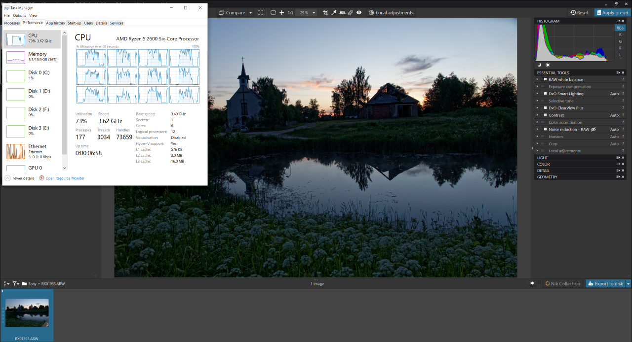

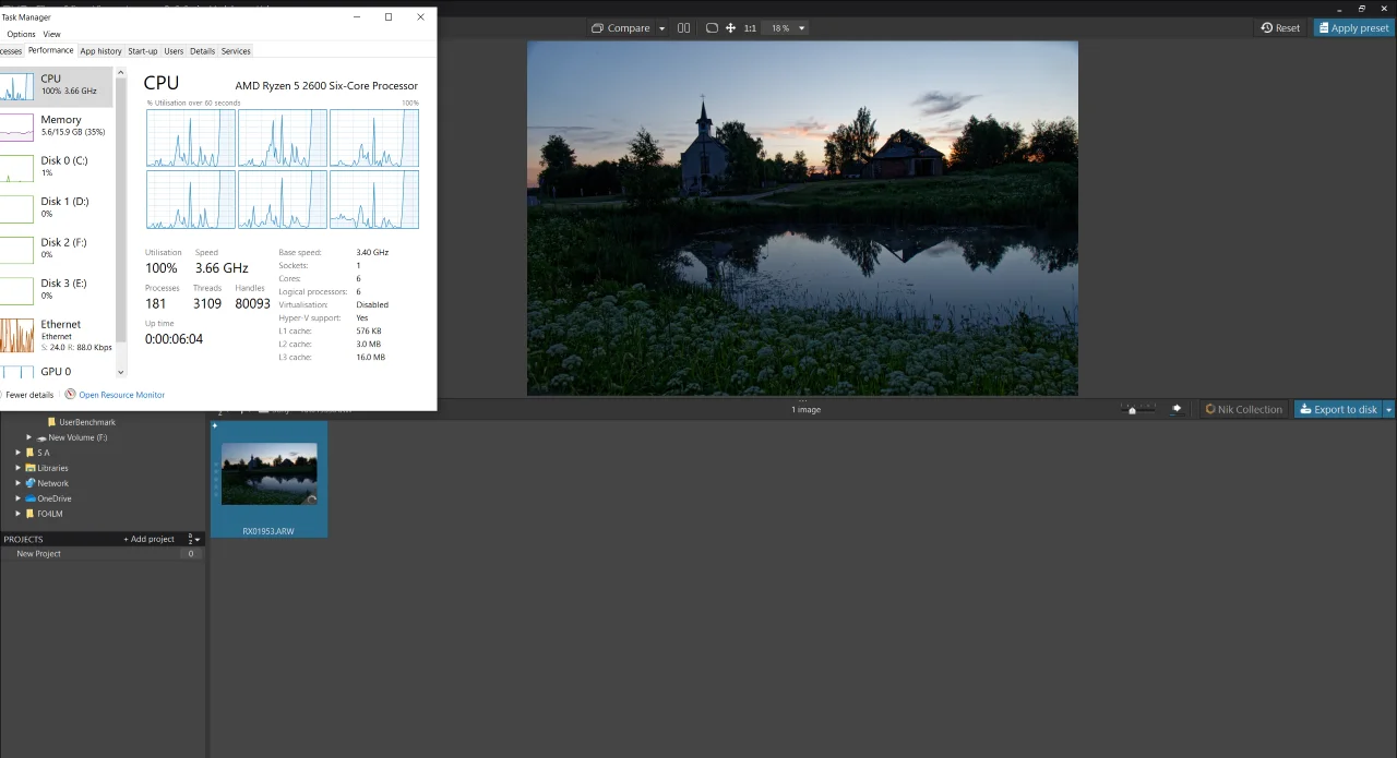

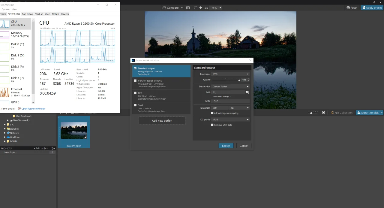

@humbug @MartinPrince I decided to test the raw image with my Ryzen 5 2600. Its running at stock clockspeeds under a Wraith Spire stock cooler,and with this RAM kit running at its XMP settings:
https://www.overclockers.co.uk/team...-3200mhz-dual-channel-kit-blac-my-0a2-tg.html
I am running the files off a NVME WD Black SN750 SSD.
So you can say my system isn't really tuned in anyway apart from the RAM being run at XMP - its even using a stock cooler!! :p
I tested with both SMT off and on.
These are the output settings:
With SMT off the CPU stayed at a constant 3.65GHZ to 3.66GHZ across all cores.
Each picture took 28~29 seconds to process,I would say its mostly on the cusp of 28~29 seconds. The cores were at 100% until the transcode was finished.
Now I enabled SMT.
Clockspeeds hovered closer to 3.6GHZ and you can see that the cores were not at 100% or they were but very briefly before the load was moved to the next thread by the scheduler.
However,consistantly the transcode finished in 27 seconds,so it was definitely slightly faster with SMT enabled.
So for a CPU just running at 3.6GHZ in a mini-ITX system using the stock cooler I think I am doing OK TBH!! :p
