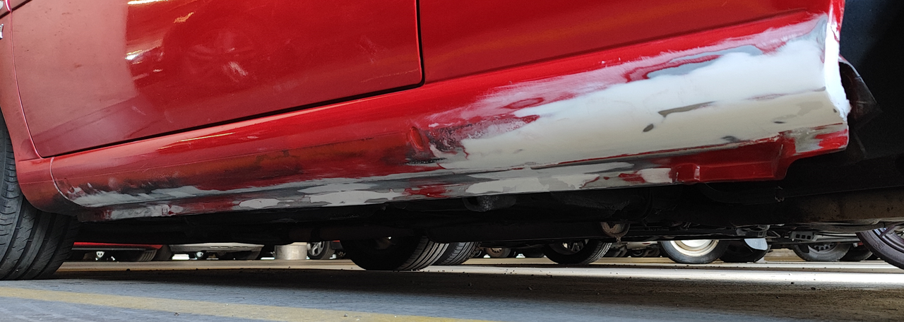

I pushed around and the whole area around there is significantly weakened.
Nobody makes a Y sill either - only repair panels which aren't enough.
I've ordered a Punto sill of the same generation - the shape of the top half is different, but the lower half looks the same, so I am hoping it will line up. Should arrive today and then I can check it against the car.

Front jacking point identical to the undamaged one on the right of my car:
https://i.~ibb.co~/1LMk4SN/IMG-20240321-150115.jpg
And the important bit - the rear. I don't want to be too confident, but that looks like a pretty much bang on match to me.
https://i.~ibb.co~/BG6QSqF/IMG-20240321-150525.jpghttps://i.~ibb.co~/wMhCyG4/IMG-20240317-133851.jpg
The curvature at the rear above the dog leg section isn't quite right but I might get away with that. I don't mind both sides looking not quite identical, it's a funny looking car anyway :p

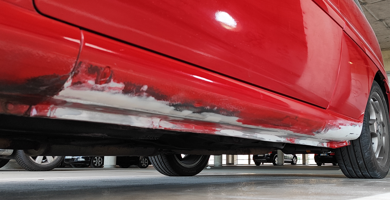

When I told the wife I'd need to fix this because it will fail the technical inspection, her answer was "How do you know that? Maybe it's fine"
I told her I'd ask @JonRGV250 for a second opinion because I'm pretty sure it wouldn't even pass the slackest of EU inspections with two whopping great holes in the sill :D
Yep, the Polish MOT expires tomorrow, there's a hole in my bucket, and I haven't fixed it :D All in all, a resounding success!

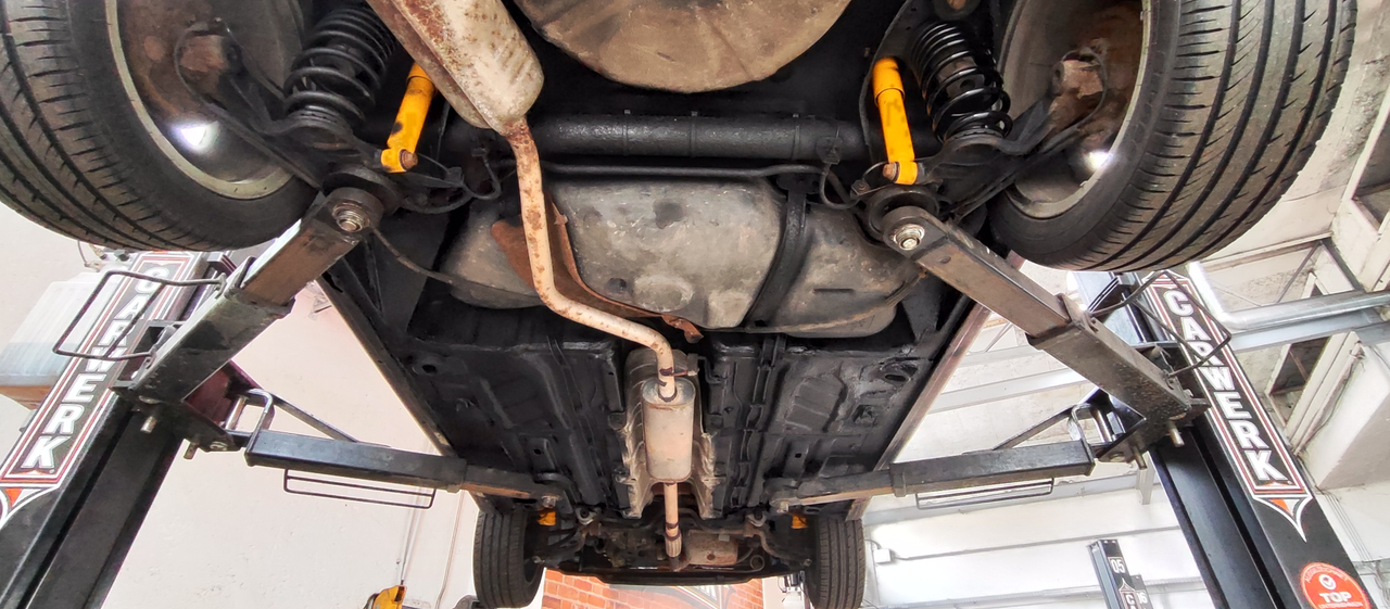

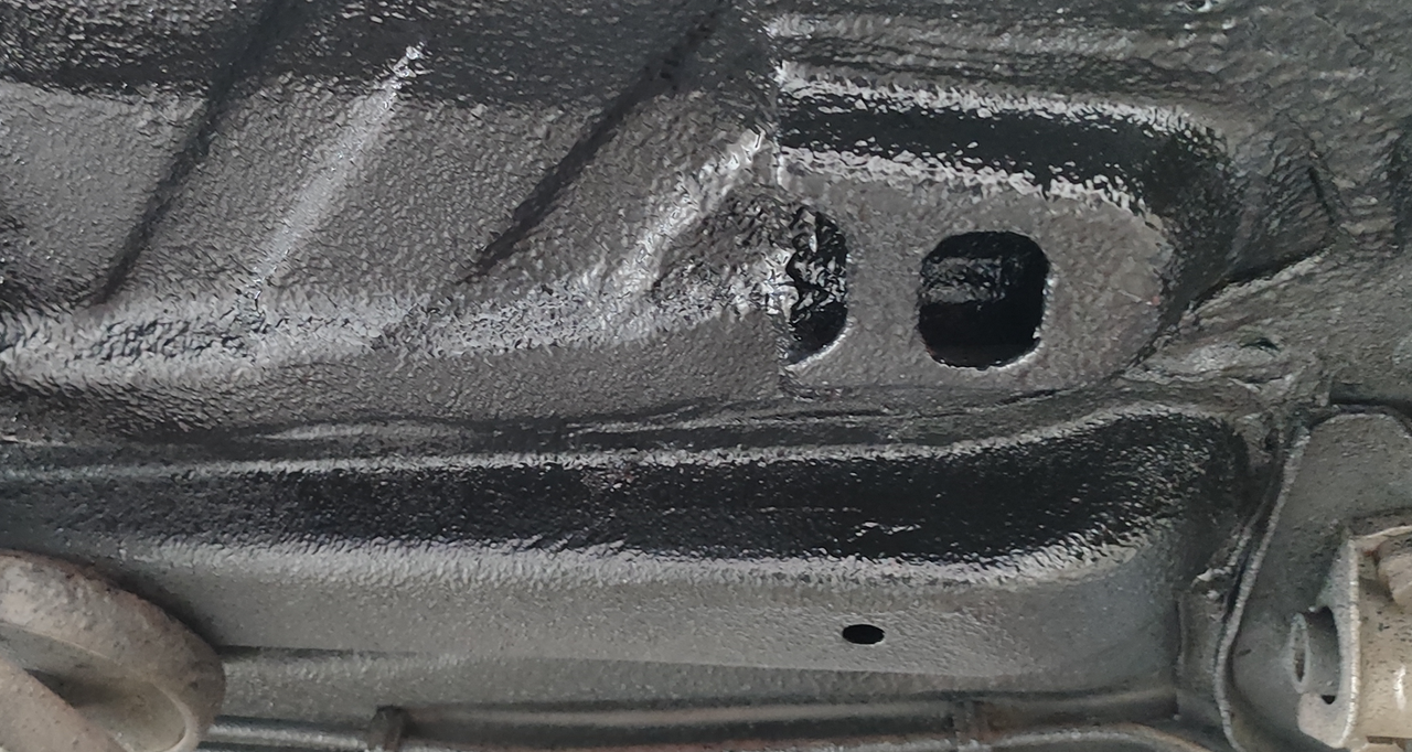

Fitted new springs and dampers and finished most of the underbody schutz :
The stuff in a tin you put on with a compressor is infinitely superior to aerosol products:

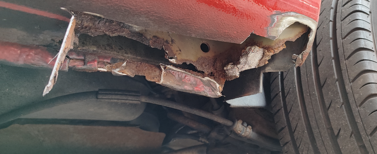

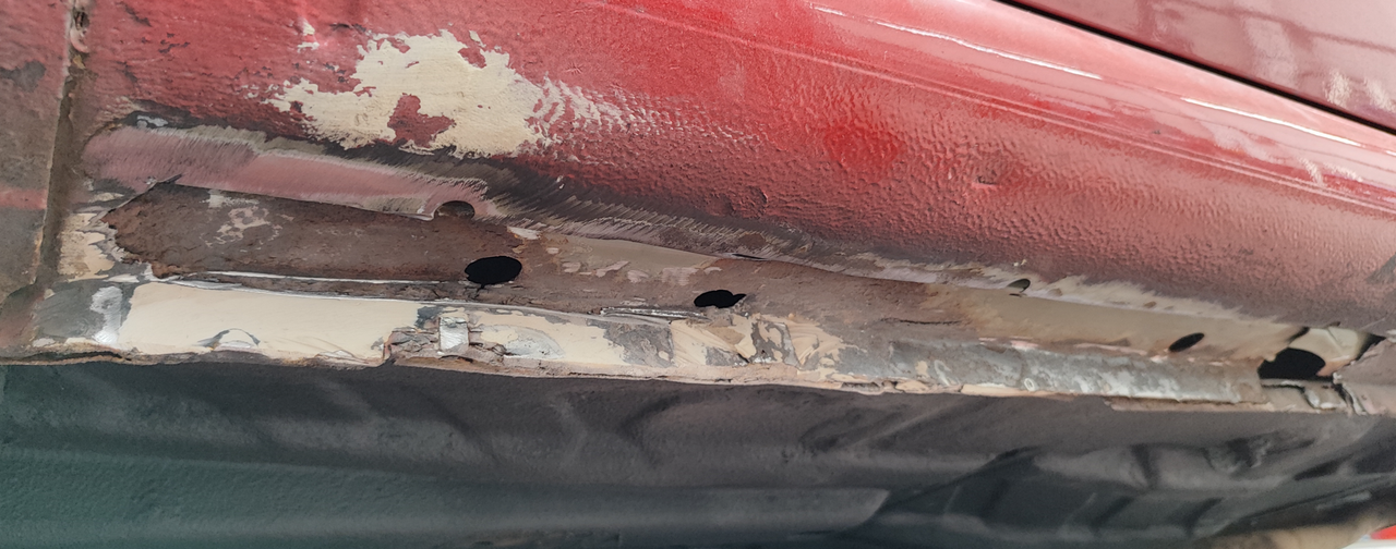

Started to cut out the rot at the front. Plenty of filler in here already, someone's been here before me then :
And at the back, well that's a new one for me - aluminium foil, and not even the premium stuff! Inner sill/strengthener gone walkies here too so I had to redo all this:

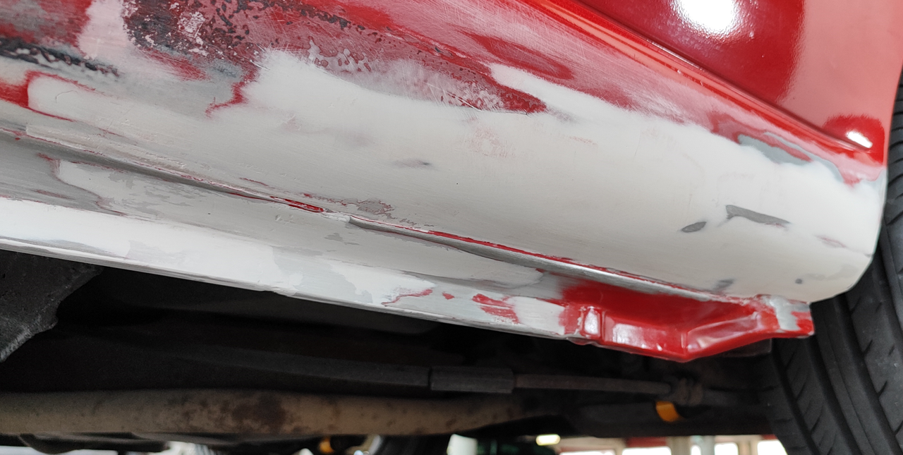

By the end of the day I had ground everything back (the sill, being for a Punto and therefore both too long and not quite the right shape, had to be cut into three sections to be fitted properly, or as best I could anyway) and drove it home.
End of the next day after a lot of filling and sanding:
It's not perfect (you can see the high area that's in bare metal where I couldn't get the curve of the sill quite perfect) but once it's schutz'd and painted red, hopefully it will look a bit more respectable. I tested the red matched aerosol on the bottom of the sill and it seems to be an almost perfect match.

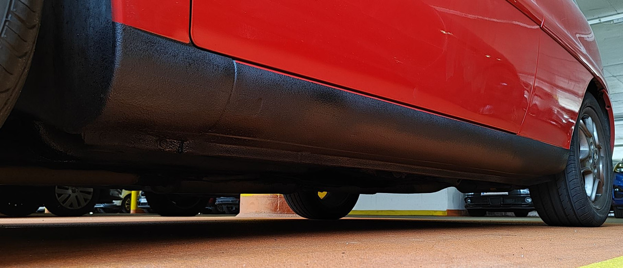

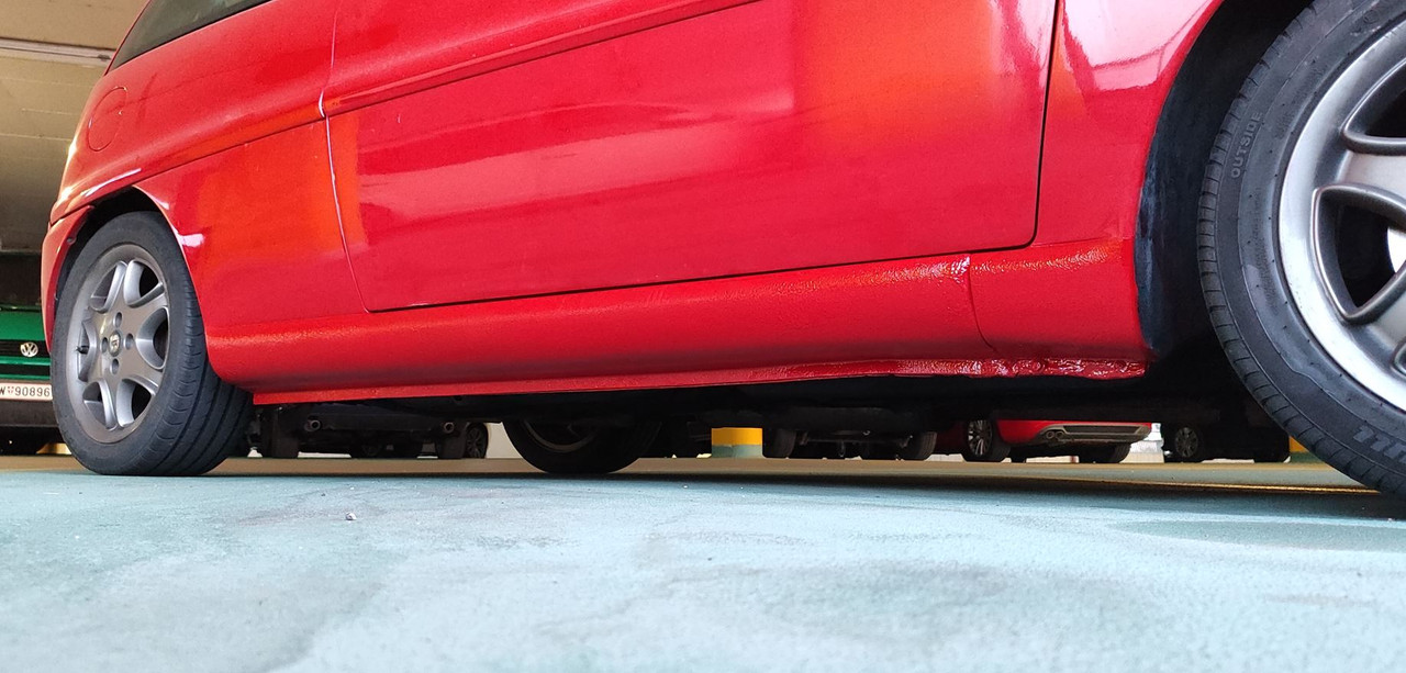

Schutz'd the sills:
Painted the sills (yep, in a multi storey car park, sue me. Check out the red overspray dust all over their newly painted floor :o I did go back and sweep most of it away after seeing what I mess I left)
The colour match is off despite it being a matched aerosol, but I think it looks alright.

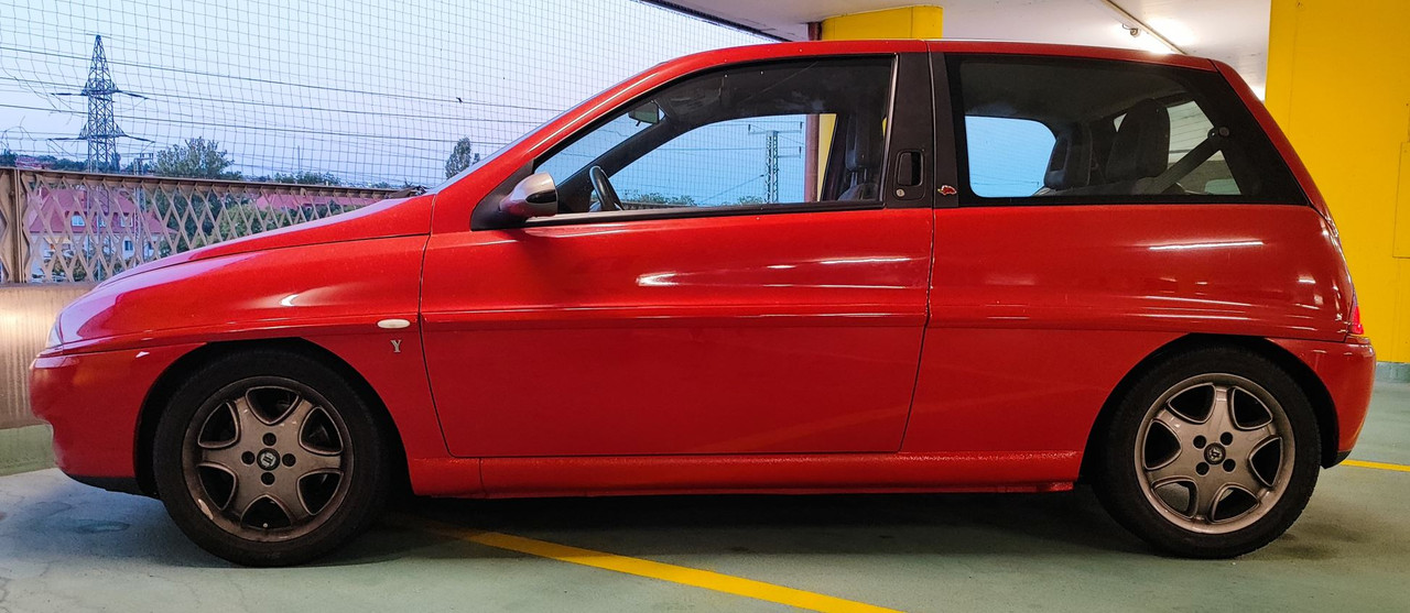

I did both sides to match:
Now I need to say a few prayers, prepare some bribes, and take it for an MOT.
