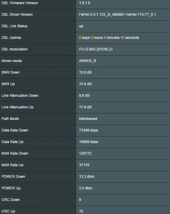

One thing I pointed out to Asus which they have so far declined to answer is why my 'Attainable Rate' is almost 20mbps higher using the Asus compared to the 4 other devices I have. My theory is that its this that's causing line instability.
The ZyXel I have is so much more stable albeit at a lower 'Attainable Rate'.
You could be right there. It's being a bit 'over confident' in what bits it can attain, so is causing more errors than other devices. Perhaps reducing the gain or power equivalent via TC Console will help. I'll look into the possibilities. Obviously AGC hasn't really helped too much being on stable, so I've just set mine to disabled again for the moment.

I'm wondering if there's a bug in the Asus firmware that is responsible for calculating attainable rate in G993.2 VDSL2 mode.
Does anyone else have a much higher attainable rate compared to the HomeHub5/BTO Modem or any other 3rd party modem?
