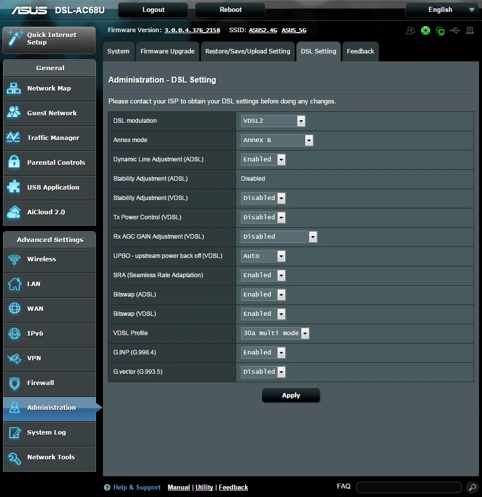

Still, mind if I ask what your settings are, as your upstream attentuation would indicate to me that you're reducing the transmit power offset?
Hi mate, everything is bog standard.
never messed with any DSL setting
UPBO is auto ??? not sure if its on or off lol
never messed with any DSL setting.
Administration - DSL Setting
30a everything else is bog standard in fact im sure 30a was the default anyway.
Yeah 30a is the default setting, changing it to 17a doesn't seem to do much (for me at least) in improving stability.

Subtle things might be making a difference. If yours works well with "wrong" settings they might be the way to go.
Isn't the out of the box setting for DSL Modulation Auto Sync-Up ?
This would make some subtle changes to the initial negotiation.
The "correct" Annex Mode for UK FTTC is A.
Openreach uses an ANNEX B bandplan from the VDSL2 spec (G.993.2) over an Annex A (xDSL over POTS as per G.992.5) physical infrastructure.
The bandplan annex is implied by you VDSL profile setting. The Annex Mode setting is for the physical being over POTS or ISDN.
I bet the DSL log page says it has ignored that setting and says the Annex Mode in use is Annex A.
Openreach uses an ANNEX B bandplan from the VDSL2 spec (G.993.2) over an Annex A (xDSL over POTS as per G.992.1) physical infrastructure.
I cant run in Annex A every time i select it and relog back into the router it shows as Annex B no matter what i do. and the only thing changed is dsl modulation selected from auto to vdsl.
The ASUS has always reported some what sketchy info regarding Annex mode.
During the initial set up of the box selecting a UK ISP automatically sets it to Annex Mode B which is what is reported in DSL Logs. The Annex Mode in DSL Settings should really be listed as Bandplan, which in the UK is required to be A. However this is not shown in the DSL Log screen in a obvious manner.
If you look at the Firmware version in my case FwVer:5.5.1.126_A_A60901 HwVer:T14.F7_0.1 you will see it indicates A.
I asked Asus numerous times last year to correct this but obviously they must think it's not important.
I also asked ASUS many months ago if a stats page along these lines was possible but got no answer...
In the FwVer, switching something called 'hwboard' between a setting of A or B (both connect, not sure on the difference though) causes the FwVer letter to change between A and B too. Changing 'hwboard' also causes a re-sync.
I agree the ASUS is very confusing on this (though I did not think your suggested rename was any better - To my mind you are calling the wrong one bandplan). I hope they do something.
Edit: I do really like the rest of your suggested display though.
Interestingly it appears this DSL-AC68U behaviour is different to their DSL-N66U (which I have). Newer N66U f/w auto selects annex A setting for UK ISP (older f/w made you guess). Annex mode is also clearly reported on the N66U's DSL Log, and had always reported ANNEX_A for me regardless of what the annex mode setting is set to. ASUS's explanation to me was that their driver was automatically selecting (and reporting) the right one regardless of what I set the setting to.
Maybe its time for everyone that has since killed spectrum and seen massive improvements to stability to hassle that paul bloke from Asus for an 'optional' firmware for us in the UK with the spectrum graphing/monitoring/whatever its spose to do removed. It would be so easy to do with the source right there in front of you and a few mins work to compile, im not sure why they would refuse. If they do not do it when i get my device i most certainly will as that seems to have made the biggest difference for most people.
Agreed, anyone want to get a petition together or has his email address so we can contact him?
It's always been something of a confusing grey area.
If I try to set up a manual WAN connection rather than select a pre-defined ISP selecting Annex A fails to connect, only B works here. I suggested long ago Asus issue a UK only firmware with everything that wasn't compatible be stripped out and added back in on a needs only basis, such as G.INP which is being rolled out.
