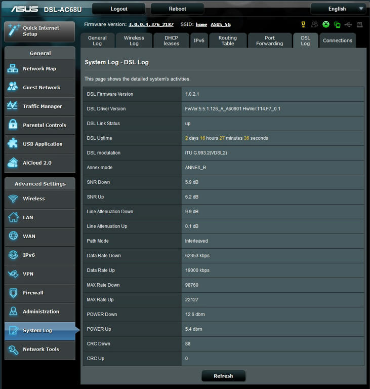

Installed the Beta FW just now. After running for just over a week on 2187 with only a disconnect every 3 days+ I've had 3 disconnects in the last 24 hours.
Im probably going to get whacked by DLM tonight for that, but lets see if the ESNP makes any difference...

I'm hopeful ASUS has cured the stability problems for a good number of VDSL2 fastpath connections. If I can maintain the current trend and connection for 24 hours then I know it's good.
Once I'm done with the tests I've set for myself then I'll probably decrease transmit power as I have plenty of spare upload speed that's unused due to 20Mbps upload speed package limit.

My second test is concluded. Results similar to the HG612 on similar conditions (fastpath, up to 80Mbps downstream). I think ASUS have resolved the stability problems at last. The only thing I'm slightly curious about is how the ASUS calculates SES, as I'm guessing it's different to how the HG612 calculates them.
Suffice to say, ESNP at 'stable' has a much better result with little impact to my sync rate and SNRM. Didn't have a single CRC spike into the thousands, and my brief testing with interleaving resulted in a stable and consistent FEC error count (which I'll come back to this one and test again).

Bear in mind that you appear to be interleaved on the downstream, and this has an effect of masking the underlying problem. Only a connection on fastpath can ideally reveal the underlying problem unfortunately.
