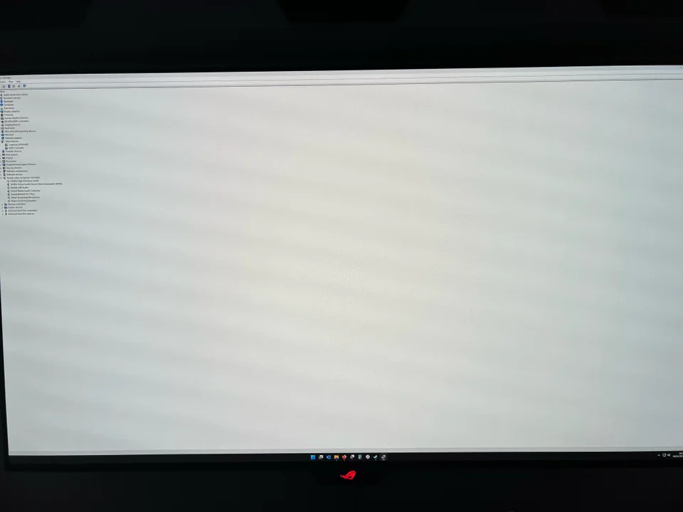

Ive had to send my asus back today, i was getting diagonal lines across the screen which suspiciously look like reflections from my blinds having burnt into the screen.
Im not going to risk another one at the moment as much as i loved it.
