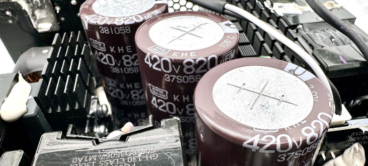

According to hwbusters, the holdup time has been reduced (downgraded) and the PSU has to support the motherboard having spikes through the PCI-E slot.
I’m afraid I have to disagree with the change at 12ms @ full load from 17ms. This is wild because, in this section, ATX v3.0 PSUs are better than ATX v3.1 ones! Intel contacted UPS manufacturers to confirm that the switch to battery time is lower than 12ms. Still, in any case, hold-up caps age, losing capacity, and besides that, it is always better to have more reserve power.
