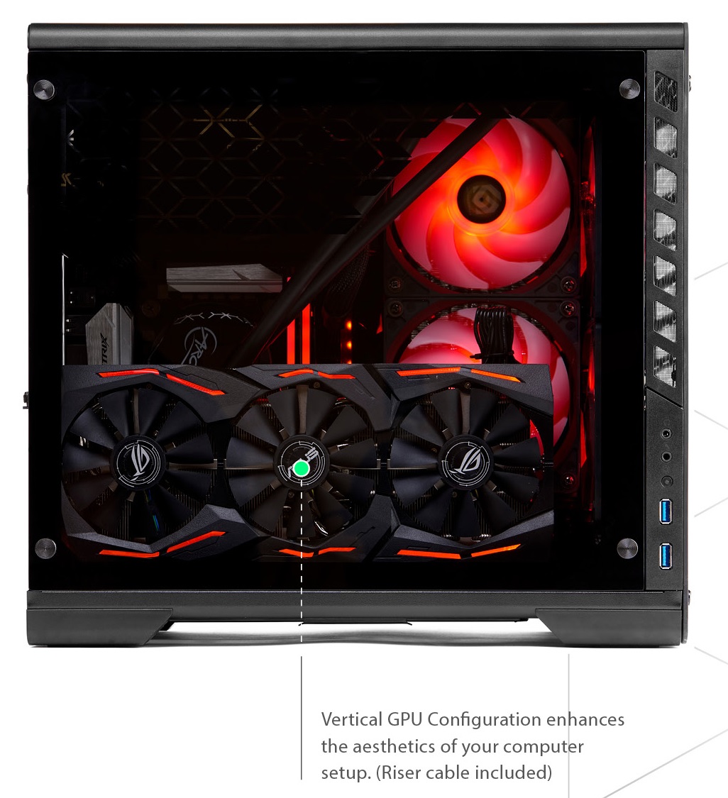

Have you heard of the Lian Li TU150?
That looks like a dedicated LAN case - regardless of what they say.
I've only had a quick look - but i'm not sold on the PSU position as it's at the front of the case and the PSU back/vents directly at the back panel - which makes no sense. From initial look i thought it was vented via a shroud at the top (its not - I checked) - but on this clip you can quite clearly see the back of the PSU when he takes the side panel off - about 2 minutes and 50 seconds in :/
Would need to see a proper review...
