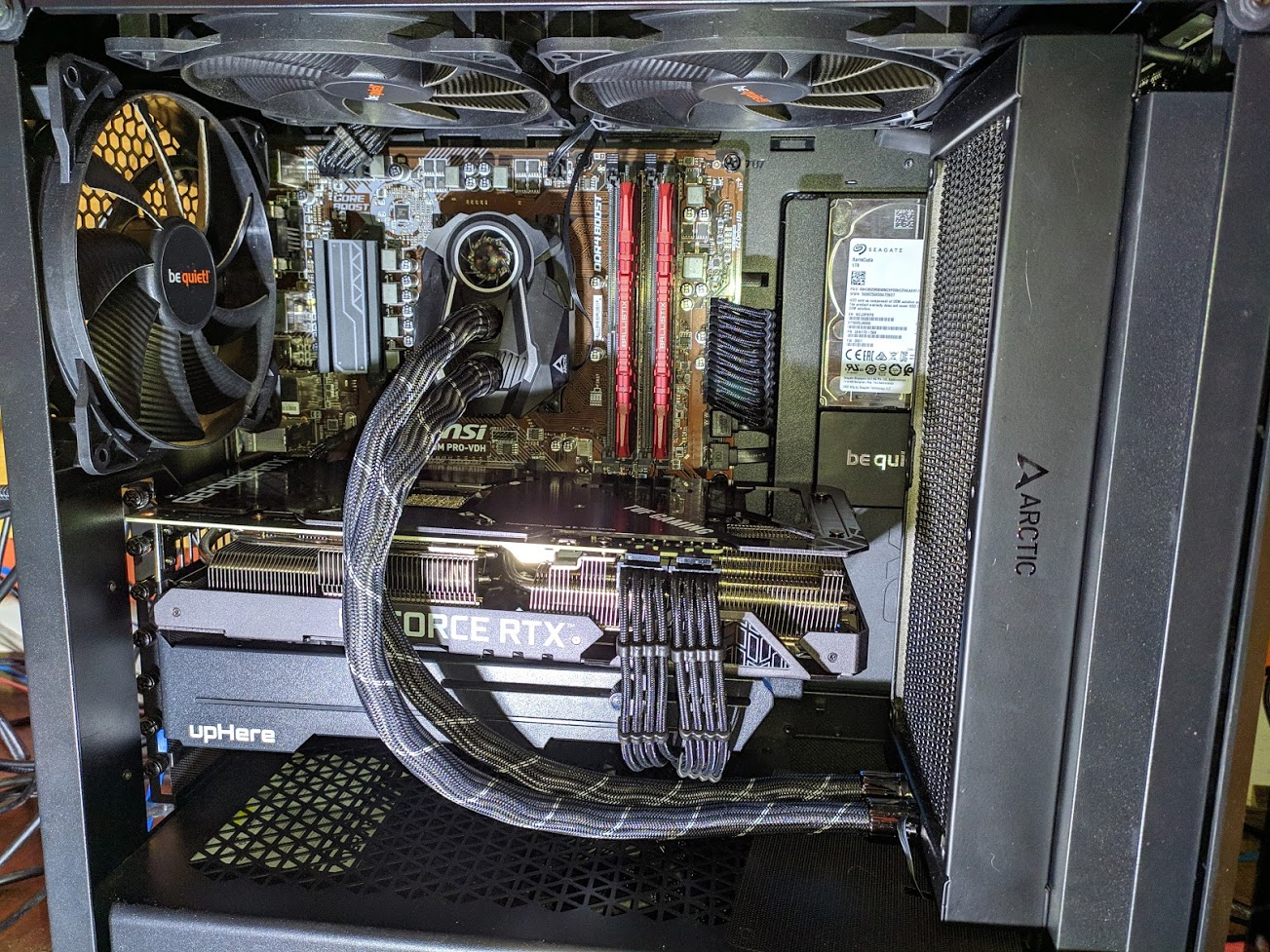

Clearance wise here is one with a Palit 3080 in no Radiator and a Tuff 3080 in with a Radiator so you can see the space.

Built in this case a few months ago at the start of lockdown. Very impressed with it overall. Just make sure you plug the cpu cables in before the motherboard goes in you'll save yourself a bunch of time later on!
Mine did look like this...
I decided i was greedy and wanted the Artic Liquid Freezer 2 360 and didn't really know if it would fit at the front.
So i thought i'd give it a go and if not i would need a new case. Turns out it does fit but only just!
As you can see below the msi 2080 super is so close to the rad!
If you have a 2080 super and are wondering if it'll fit the answer is yes but only just!

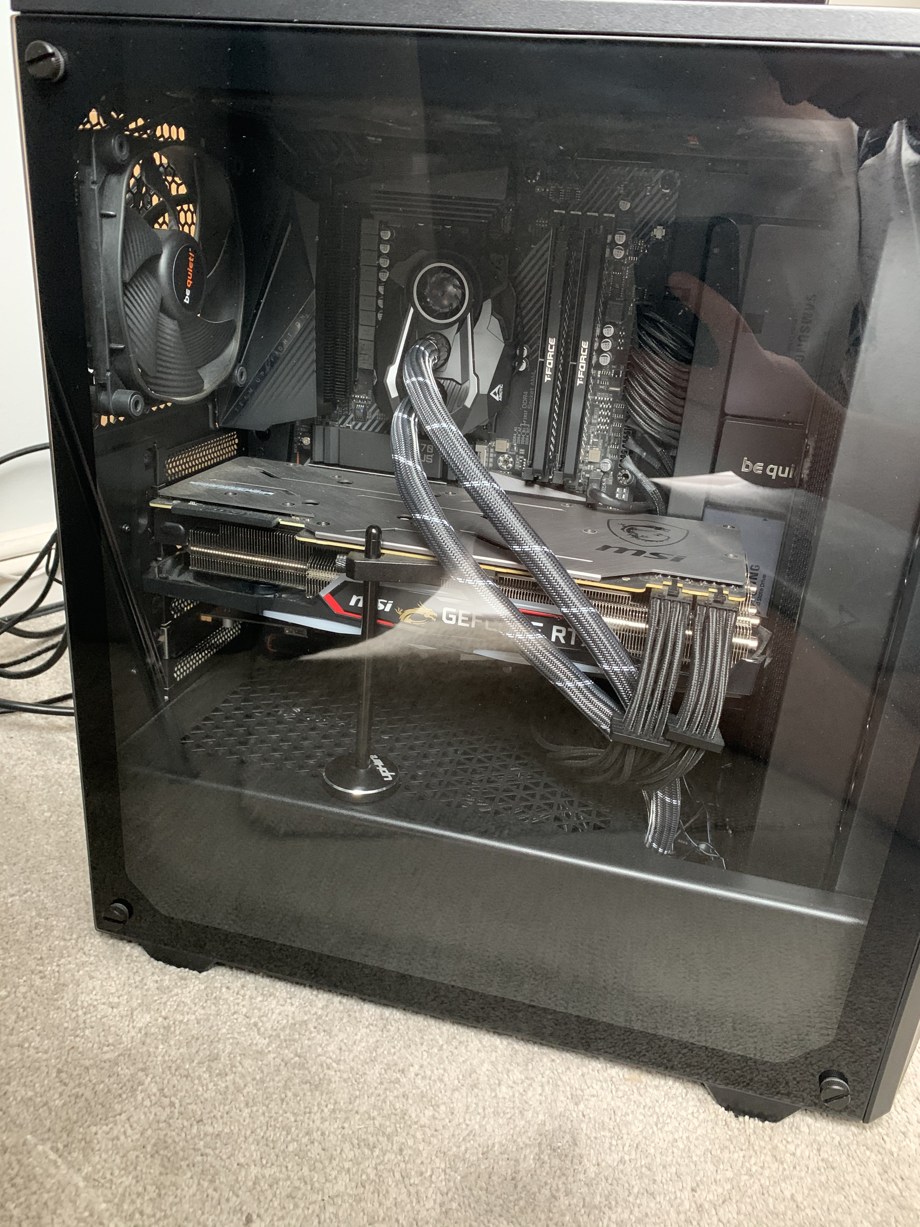

Here is mine with the 3080 just housed.
The FE 3080 is not that big in real life :) it is built like a tank though, that's how it feels

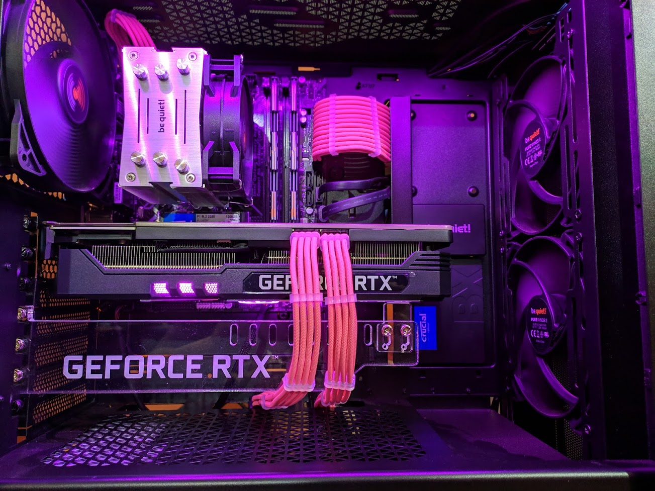

So after thinking about it I decided that it looked a bit cluttered with the pipes coming up from the front and that I needed something a bit better and cleaner looking.
So after a week or so of researching I end up on the Lian Li PC-011 Dynamic. Now I know these are pretty common and the world and his wife seem to have one but I have to say overall its a fantastic case to build in, probably the easiest I've built in as far as space is concerned it's very much a tardis on the inside. When you consider that the height and depth are almost identical to the 500dx this can fit way loads more hardware inside of it!
For now I have no real plans other than changing the three arctic fans out for some more silent wings 3's which are on order. Unfortunately I'm still waiting for my back ordered 3080 and 5900x to turn up but I work in the motortrade so I know all about backorders and that a piece of string is always very long and to never go by what they tell you.
Only things I've done is added the Phanteks vertical gpu bracket which is a nice solid option and still allows me to use the bottom pci-e slot for a wifi card and also allows you to use the 3 fan slots at the bottom. And if you look closely at the top rear you'll see I've added 2 80mm pure wings 2 fans, not sure if many have done it to this model I know the PC-011 air model already has these holes pre-drilled but this model doesn't. I think many people stick them on with double sided tape if they do decide to put fans there but I went for the more permanent option of drilling the holes out instead. I think it looks ok?! I don't think you can really tell they've been added afterwards! lol
This is nowhere near as good as other peoples builds that are like platinum quality in comparison but I'm really happy with how its turned out so far though.
