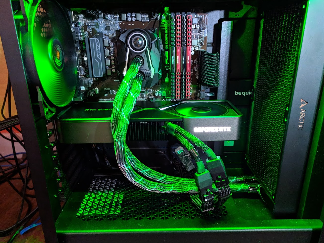

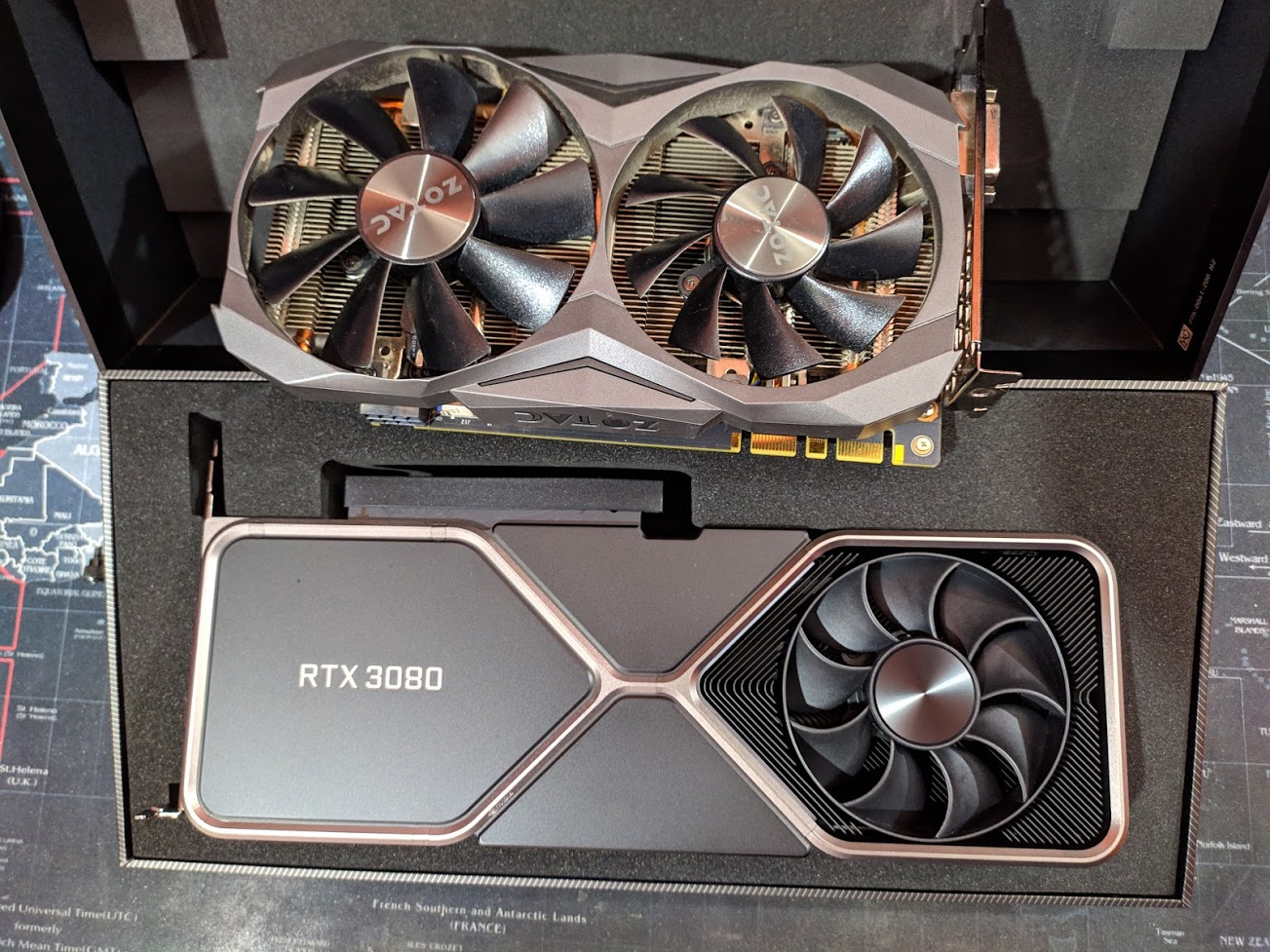

Here is mine with the 3080 just housed.
The FE 3080 is not that big in real life :) it is built like a tank though, that's how it feels
Is there another 15mm between the video card and the arctic cooler? I'm planning on a similar build but I don't have a 3080 yet, I'm on queue for EVGA cards and some of them are up to 300 mm compared to the 285 of the NVIDIA FE.. so wanted to make sure..... Thanks
Yes there is 50mm gap between the end of that card and the radiator fins. I just measured it for you :)
I did check one would fit before I got the case as my initial aim was for an EVGA. The other thing to note is that that radiator is quite thick at 38mm so if using a different rad you will probably have more room.
My alternate pick was a Lancool II Mesh, but there are none in stock for a reasonable price. Lots of cases would fit the 300mm card but not also fit that radiator, especially in the orientation it is.
My main gripe about the case is the vertical cable/SSD cover, that gap is not sufficient for chunky cables, hence why I got the sleeved cables. Other than that it is a nice case, and using all 140mm fans it is quiet as they are on a low RPM.
Thank you, really appreciate it.
I was also between the Lancool and the 500DX, but like you mentioned, can't find the Lancool in stock, so this one looks like a winner.
I did some research and the Arctic Freezer 280 is an excellent cooler and seeing your build convinced me that I'm on the right track.
