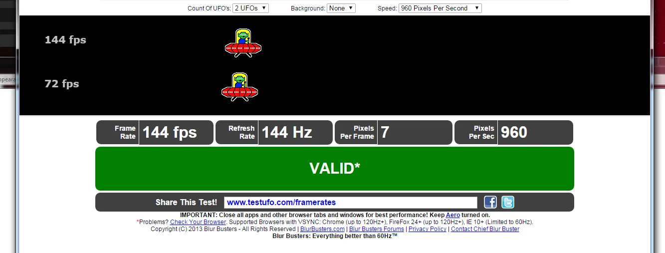

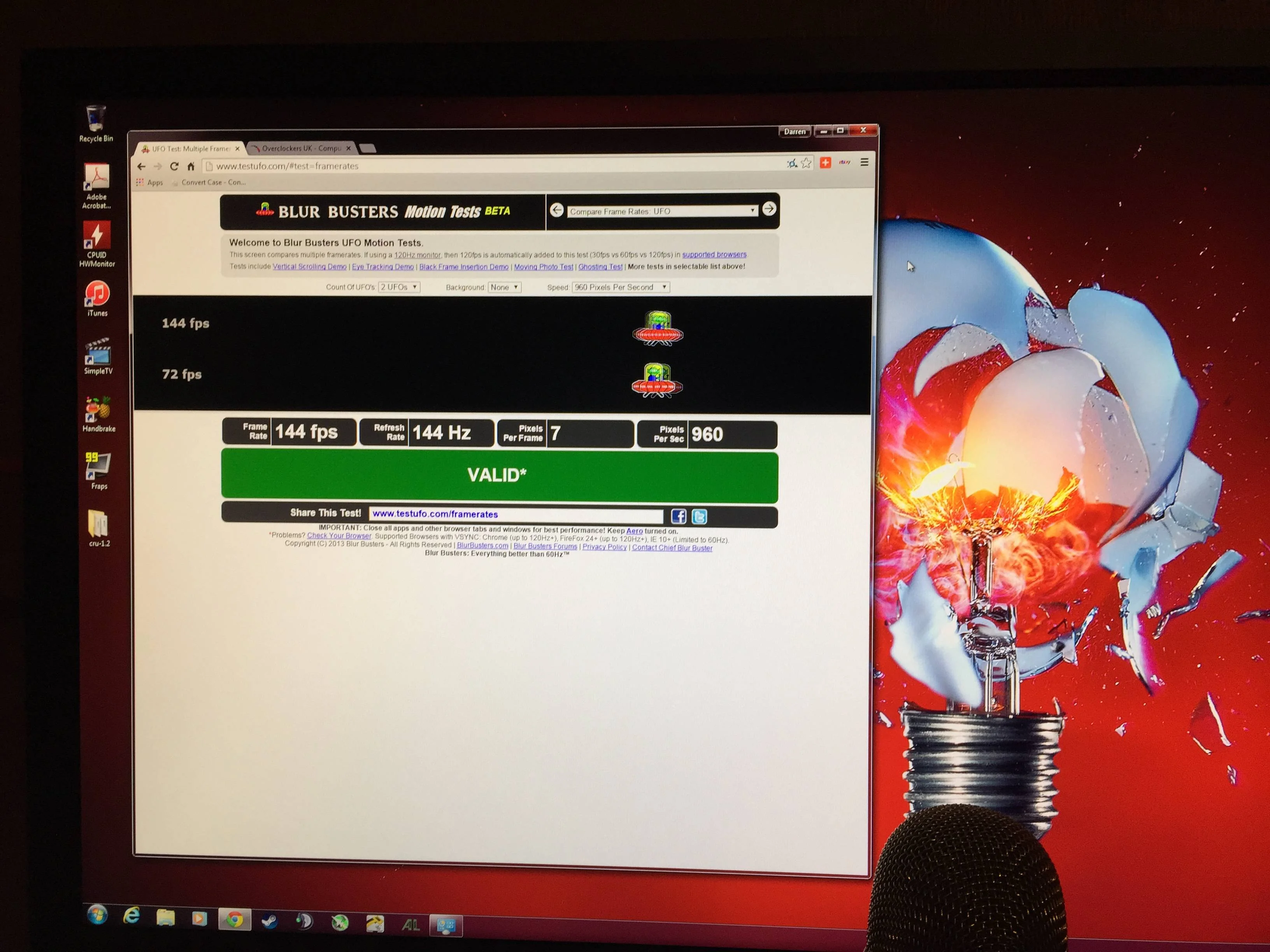

I have got the monitor to run at 144hz without flickering AND it also fixed all my games that flickered at 1440p too!

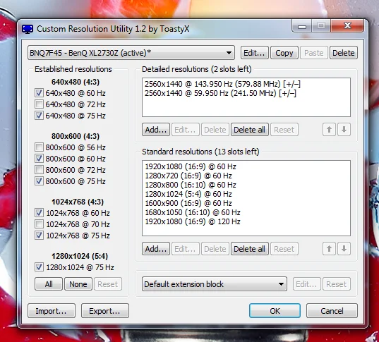

I used the ATI patch, download and install from here http://www.monitortests.com/forum/Thread-AMD-ATI-Pixel-Clock-Patcher
and
Download and install CRU Toastyx from here http://www.monitortests.com/atikmdag-patcher-1.3.2.zip
and a new Detail Res and Set to to 143.95Hz. Save and restart the PC. On restart for to your monitor properties and select 144hz from the drop down.
