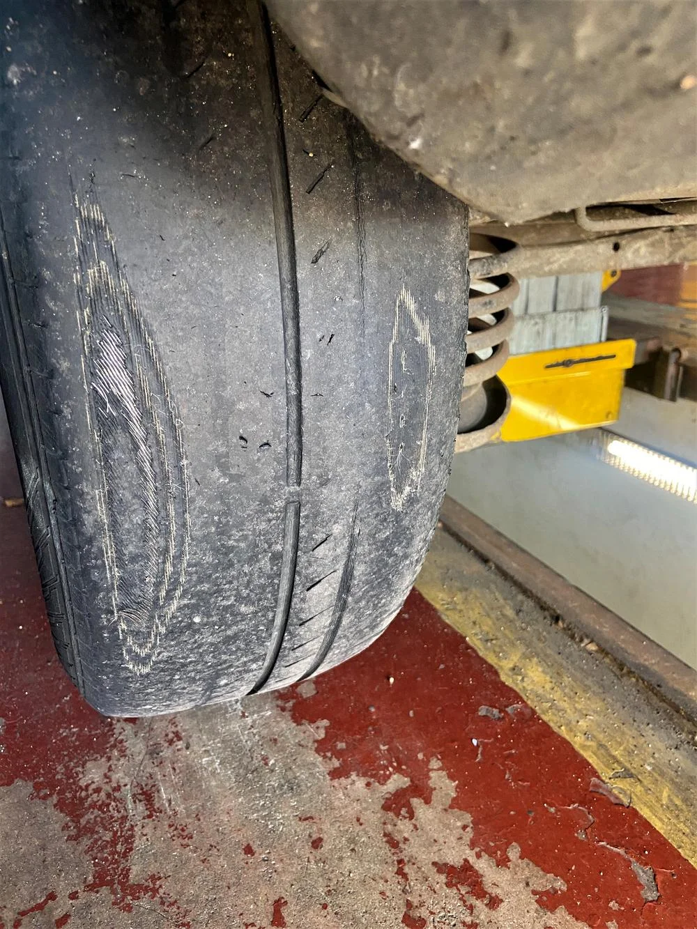

This was presented for an MOT today, and have a wild guess what it failed on..
It beggars belief that some people can't even be botherd to check their tyres.

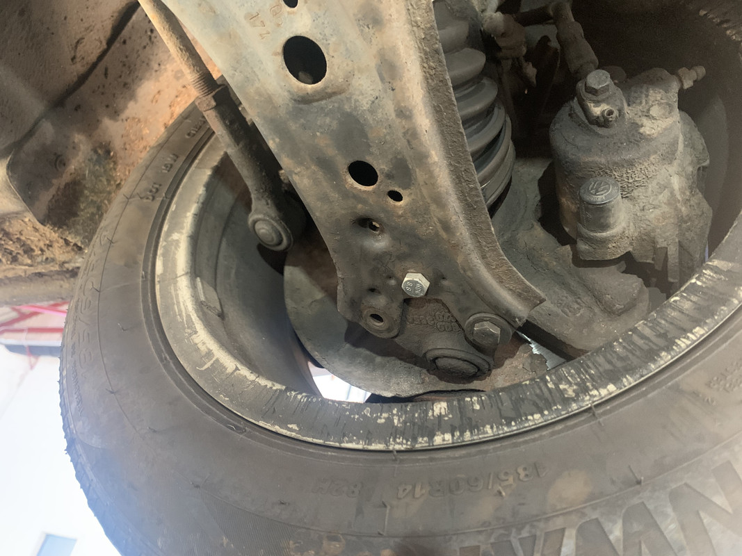

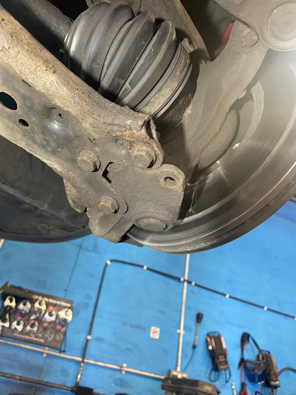

A customer brought a car in today that they'd just bought from auction and was complaining of it pulling to one side and also grinding when on right hand lock.
It had brand new pads and discs fitted and it's almost unbelievable that who fitted them didn't notice a certain problem.
I'll let you guys figure it out..
Some people really shouldn't be allowed near a tool kit!

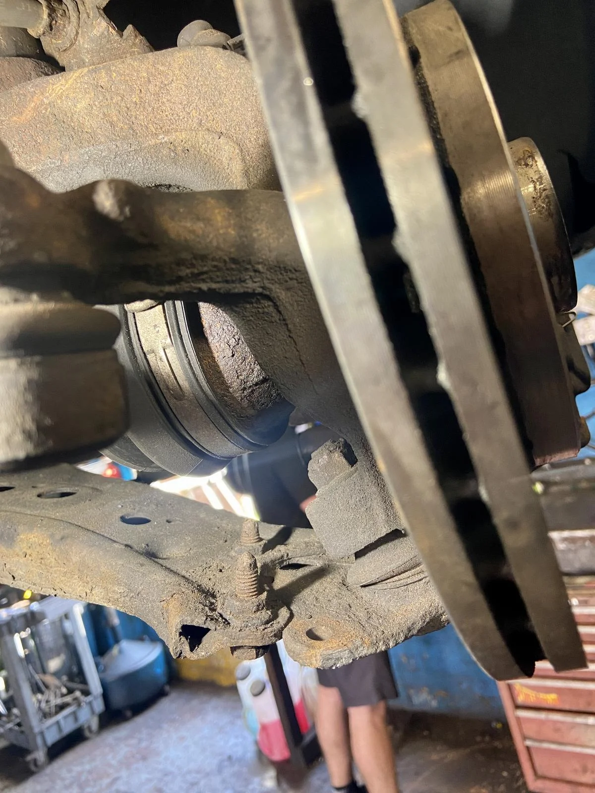

I was in a garage this morning and the chap who was mot’ing a polo said come here and have a look at this.
One bolt missing and the other 2 were finger tight. You could pull the wheel in and out with the amount of play.

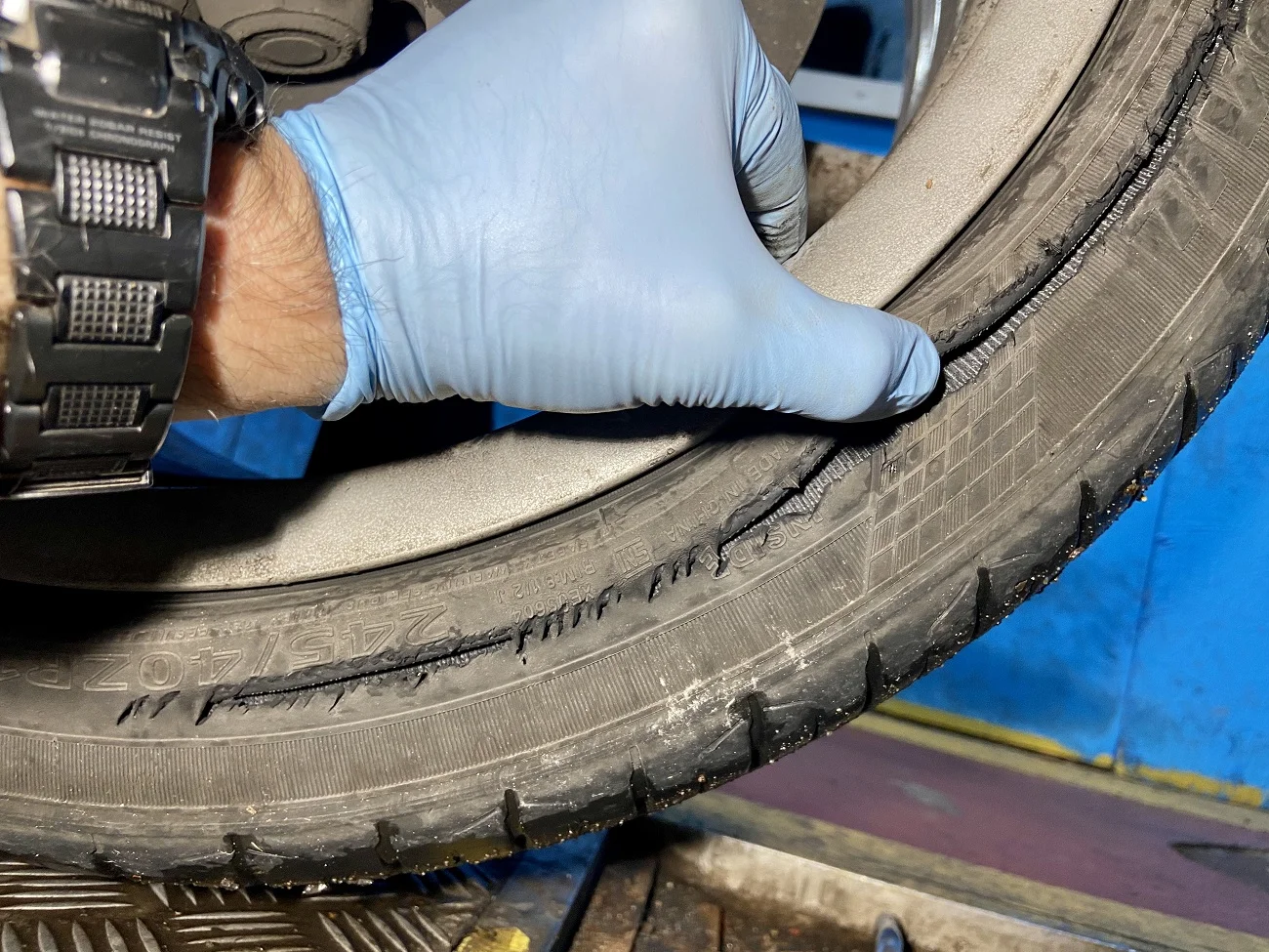

We offer inspections on cars that customers are considering buying, and this is one from earlier..
Both front tyres were like that, and the entire car had been poorly sprayed/repaired (there was overspray everywhere, the front wings had been off and were probably from another car etc etc and the fault codes indicated all kinds of expensive problems).
I took great pleasure informing the potential buyer (in front of the cars owner) just how much he should avoid it.
This was a 15 plate C220, so not a cheap car.

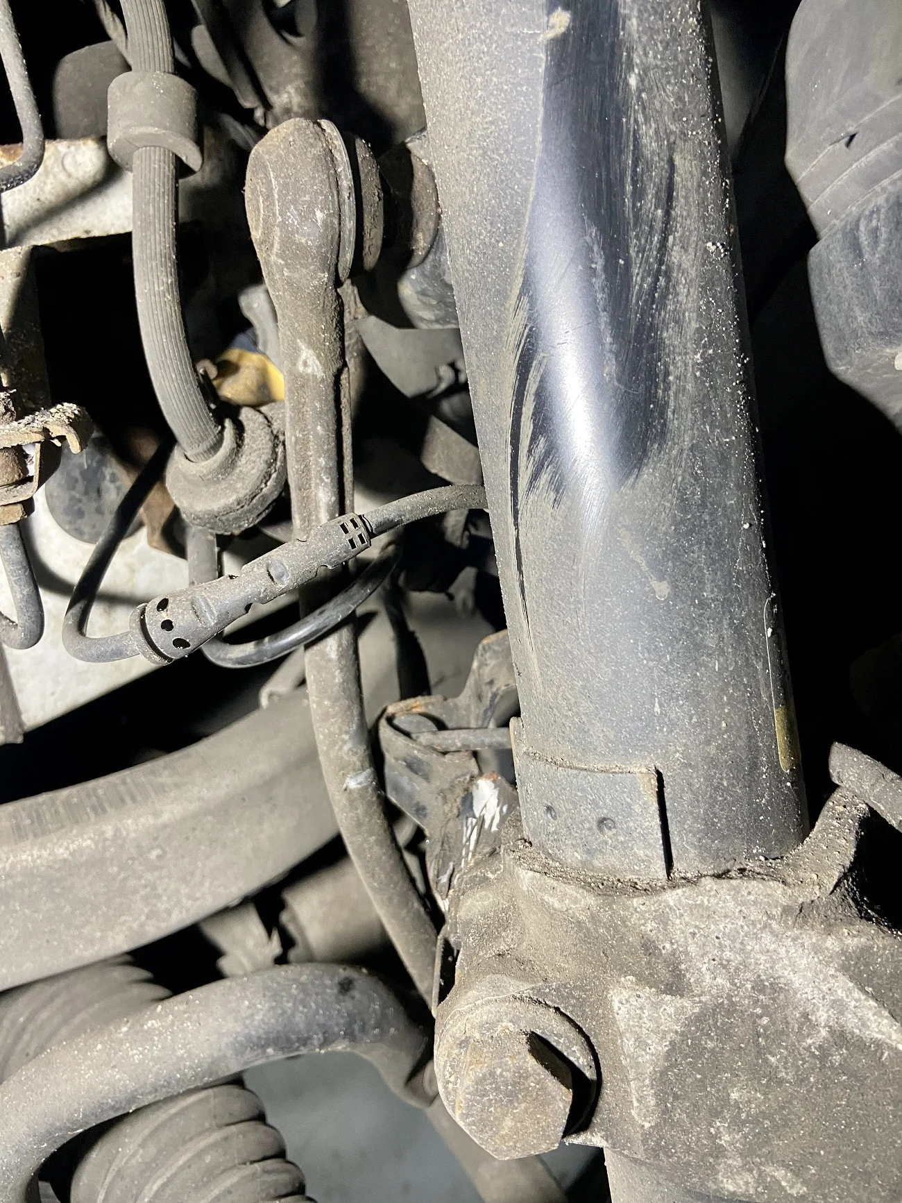

This customer had a pair of front shocks fitted recently (not by us) and it failed the MOT on..

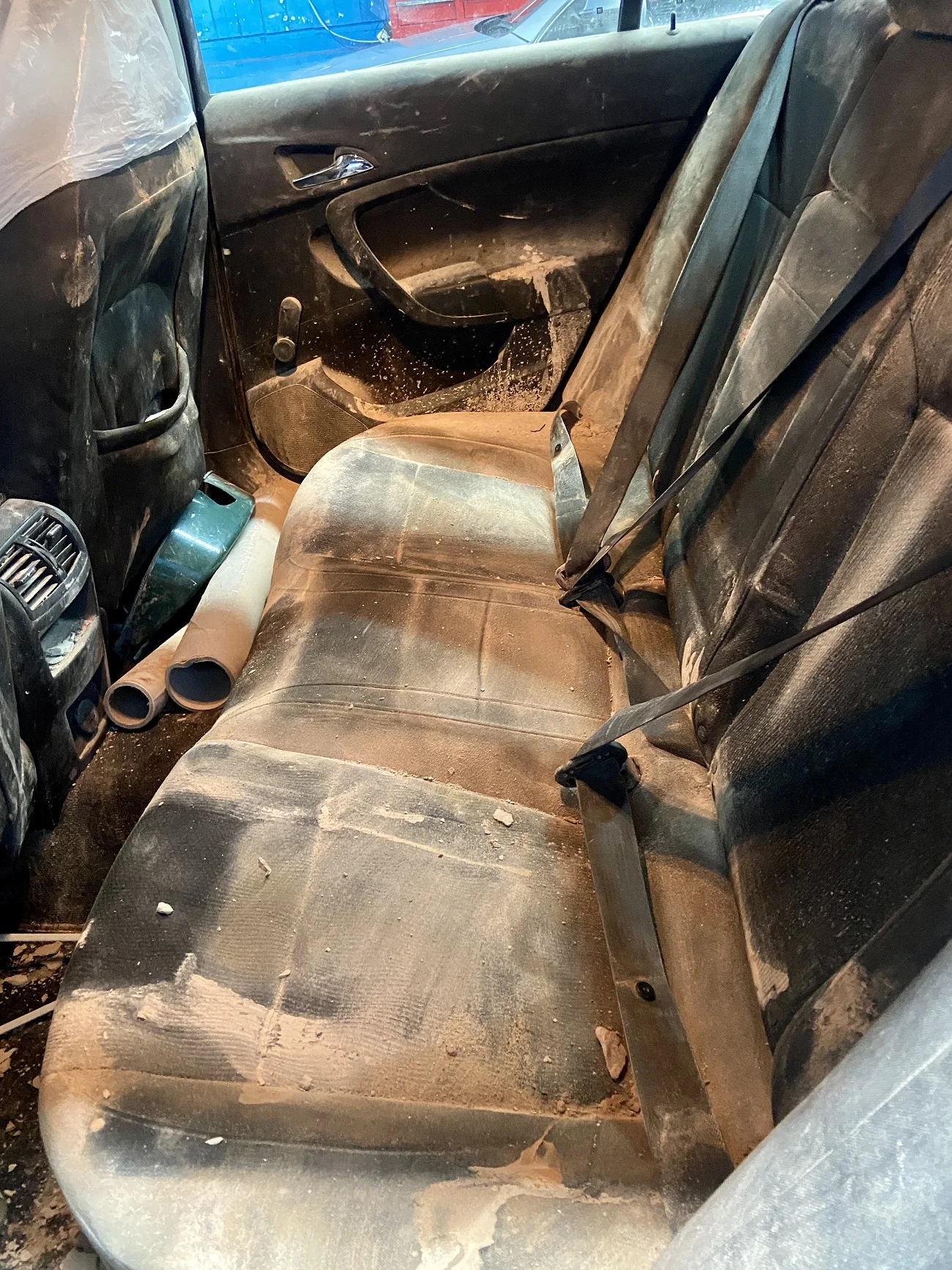

And just for fun (If you have OCD about car cleanliness, the look away now)..
It's the only time I've had to fit a seat cover to keep myself clean and not the seats.
