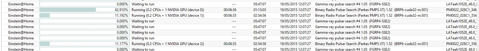

Do you have this...
<use_all_gpus>1</use_all_gpus>
in your cc_config.xml file (in the ProgramData\Boinc folder) ?
Also, are you running multiple tasks on each card ?
These are set up in Einstein Preference.
i changed the 1 to a 3
<cc_config>
<options>
<use_all_gpus>3</use_all_gpus>
</options>
</cc_config>
working fine now
[url=http://imgur.com/EYLD5oB] EYLD5oB.webp [/URL]

I believe the option is an off or on switch.
0 means don't use all the gpus, 1 means do use all the gpus.
I expect the test is if 0 then don't, otherwise use them all so having a 3 won't be a problem.
In your Einstein preferences have you told it to process 2 (or 3) tasks at a time on each card ?
They should all be able to do at least 2 at a time, so change the three DANGEROUS settings to 0.5. This lets 2 at a time run, 0.33 allows 3 to run (per gpu)
I'm on 0.5 (2 per gpu), makes things warmer for you :D
If you want to change it to 3 then you should check run times to see you are making more points for the same or less time (overall) and heat isn't a problem.
cheers, ill have a play but the only card that is watercooled is the titan atm so the 780s getting a little toasty as it is, if i wasnt spending 50 quid a week on lecy i could buy some more watercooling gear! lol
