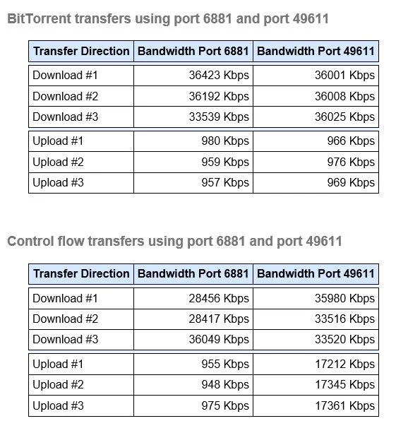

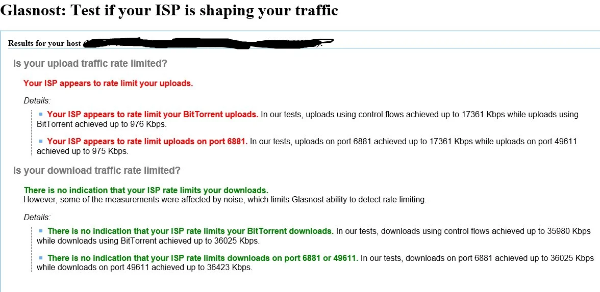

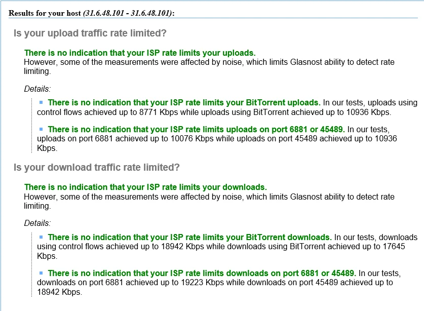

Problem: Seeding on Deluge was terrible, only getting about 120KiB/s.
BT Infinity doesn't throttle P2P you say?
When did you join?
Didn't get throttled personally when using BT Infinity. Now with Plusnet though:Problem: Seeding on Deluge was terrible, only getting about 120KiB/s.
