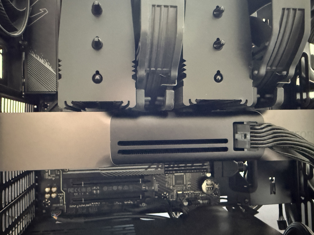

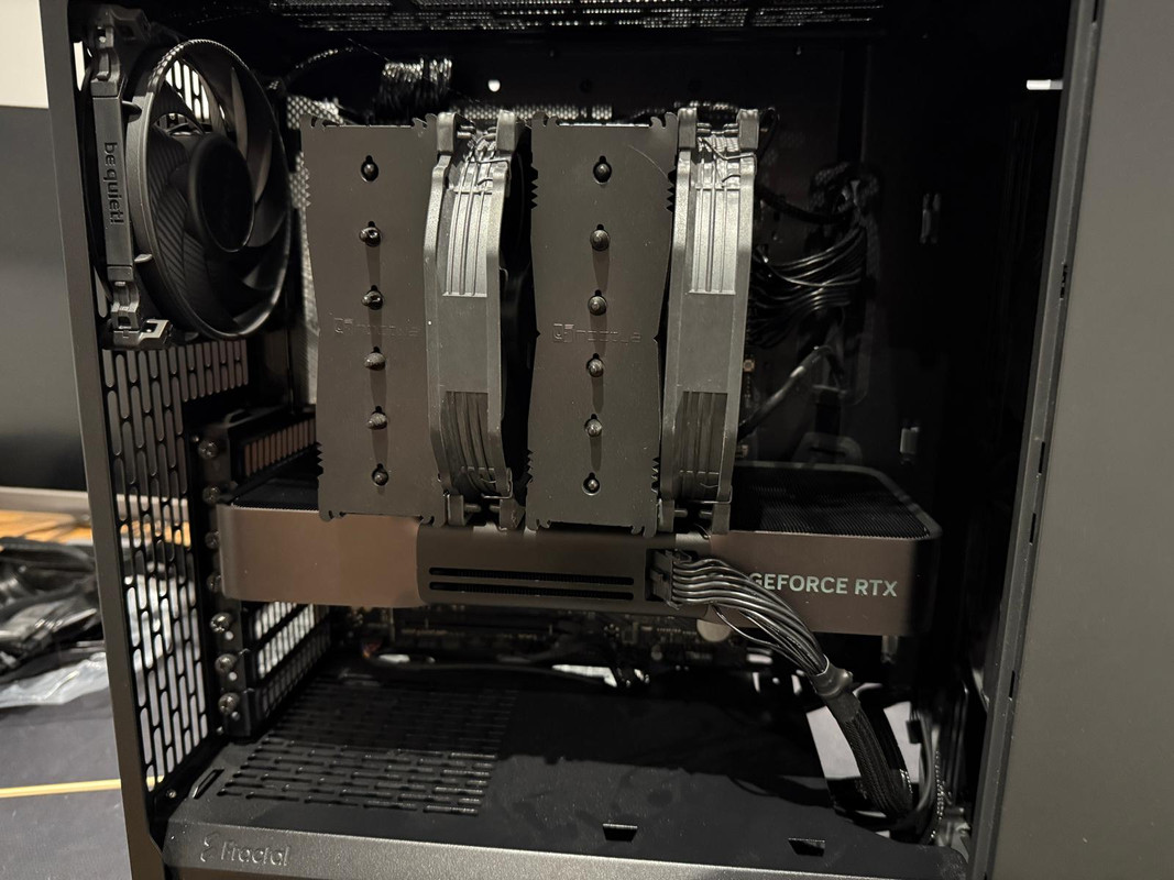

Currently running a Noctua NH-D15 chromax paired with an RTX 5090 — absolute beast of a CPU cooler. I’ve got the fan curve dialed in so it’s pretty much silent.
Only issue is, the cooler is physically touching the back of my GPU. From what I’ve read online, this shouldn’t impact performance or cause any problems, but I wanted to double-check with the community.
Would this setup be fine long-term, or should I consider swapping to a smaller cooler?
For reference, I’m on a 7800X3D.
(Please note the only PIC I have is when I had my RTX 4070, but same issue exists with reference RTX 5090)
Thanks!

I'm actually already using the Noctua offset bracket which allows for better cooling, however it pushes the cooler down even further to the GPU!
"If you've got some spare thermal paste, it may be worth you seeing if you can flip the mounting 180 degrees. I know the Peerless Assassin and Phantom Spirit offer an offset AM4/5 mounting, to add the spread over the cache IIRC, as I've seen someone test fit it 180 degrees the wrong way."
The above is a solid recommendation, however if I remember rightly it's only the G2 that allows for inversion. The standard version can only be mounted the one way. But I will reinvestigate.
If the above fails I may go down the route of another cooler, as I also don't like how close the two components are to one another, and it's a nightmare whenever I need to take the GPU out. Shame really as I'm a Noctua fan boy at heart!

"So does that mean without the offset bracket, it will clear? Or do you mean that's the only way that you can mount it?"
If I remember rightly it clears without the offset, but by the smallest smallest amount, E.G 0.000001mm. With the offset bracket it 100% touches.

I had another look at the cooler placement today and wanted to provide some further images, to see what you think. Upon further inspection it’s still really close but from what I can see does not actually appear to be touching?
Thanks again!
It's fine.
Just get a piece of paper if it slides between the two, it's ok.
Saves selling off a perfectly good HSF just to get a similar one. It's not like you have a crappy stock HSF

The paper fits! That's genuinely such a good test, can't believe I didn't think of that.
Thank you.
