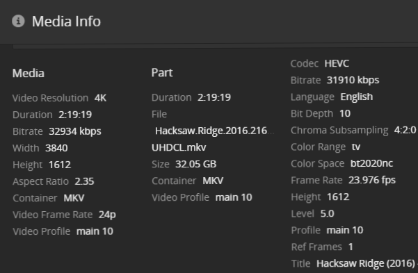

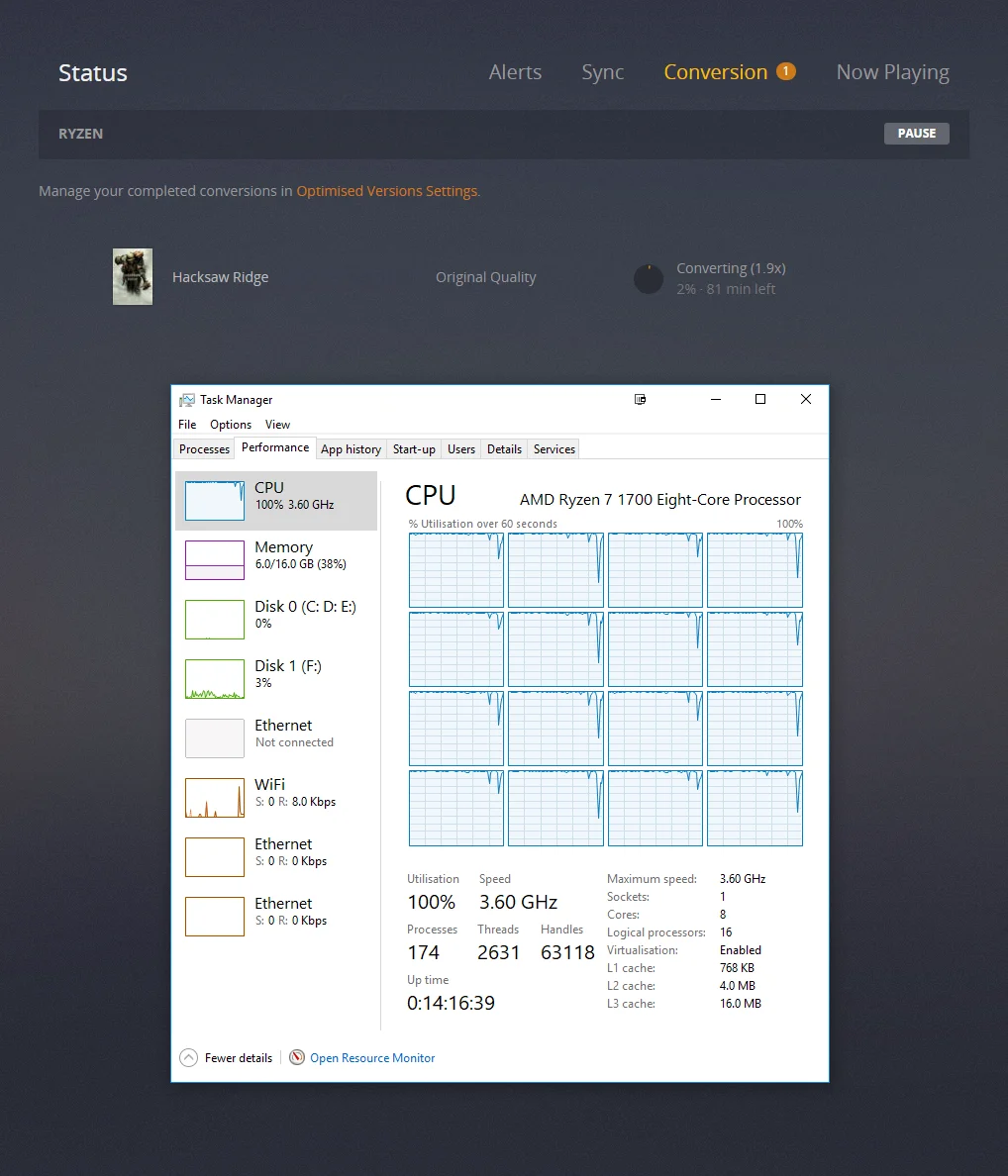

I am running a R7 1700 at 3.6Ghz on all cores. Streams 4k HEVC without any stuttering. Below is plex encoding to its original quality settling at 1.9x and peaking to 2.4x. Just to note this CPU averages about 1.8x encode/transcode on a 4k HEVC file.
