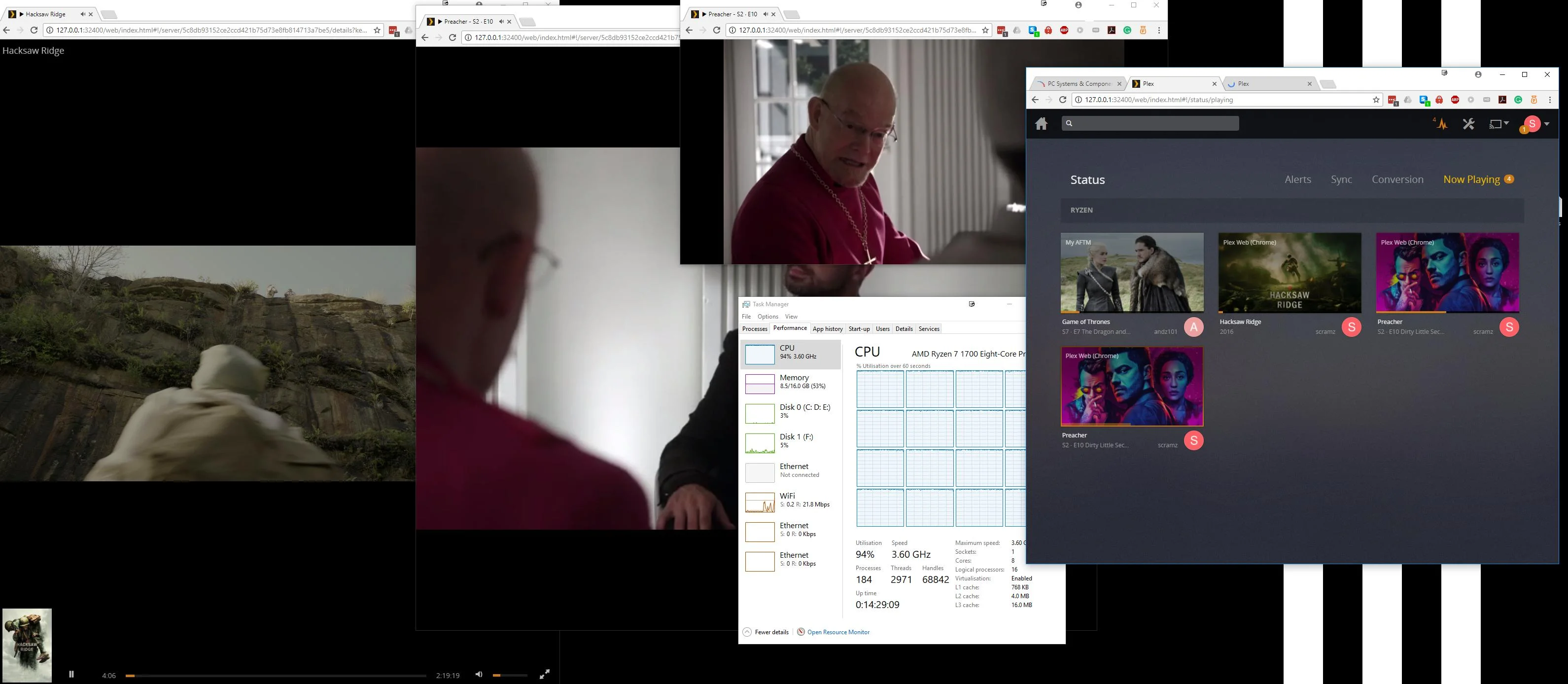

To put it into perspective, the R7 1700 will transcode a 4k HEVC at the original quality and transcode 3 1080p down to 2Mbps 720p with no stutter. I will try more streams at one time tomorrow so you can get a better idea if you would like me to.

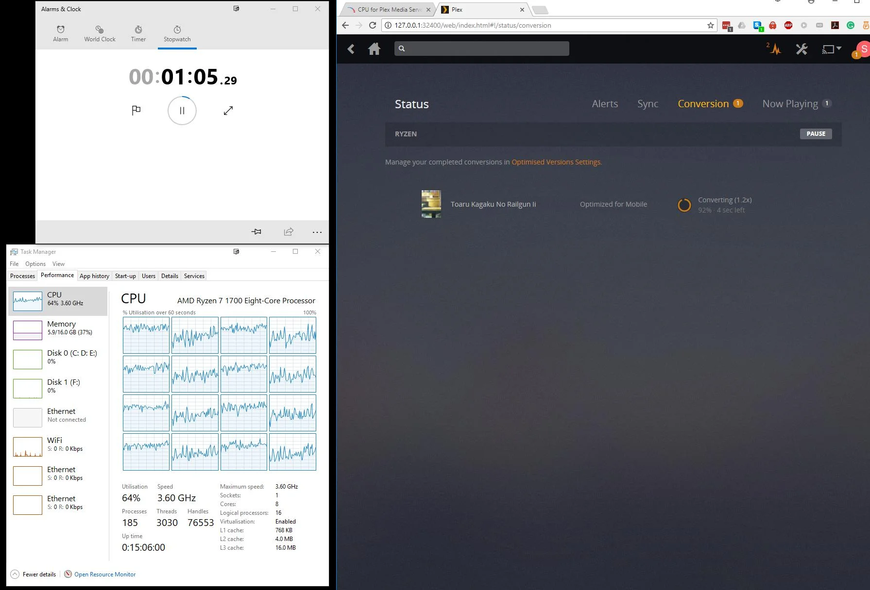

Could you help me run a benchmark test if you have time? Download this video, add it to Plex library, start a stop-watch, optimize it for "Mobile", and record how many seconds or minutes it takes to complete the optimisation. Thanks
R7 1700 encoding your download video above. Took just over 1 min with 1 other video transcoding at the same time and with 65ish% CPU Utilisation.

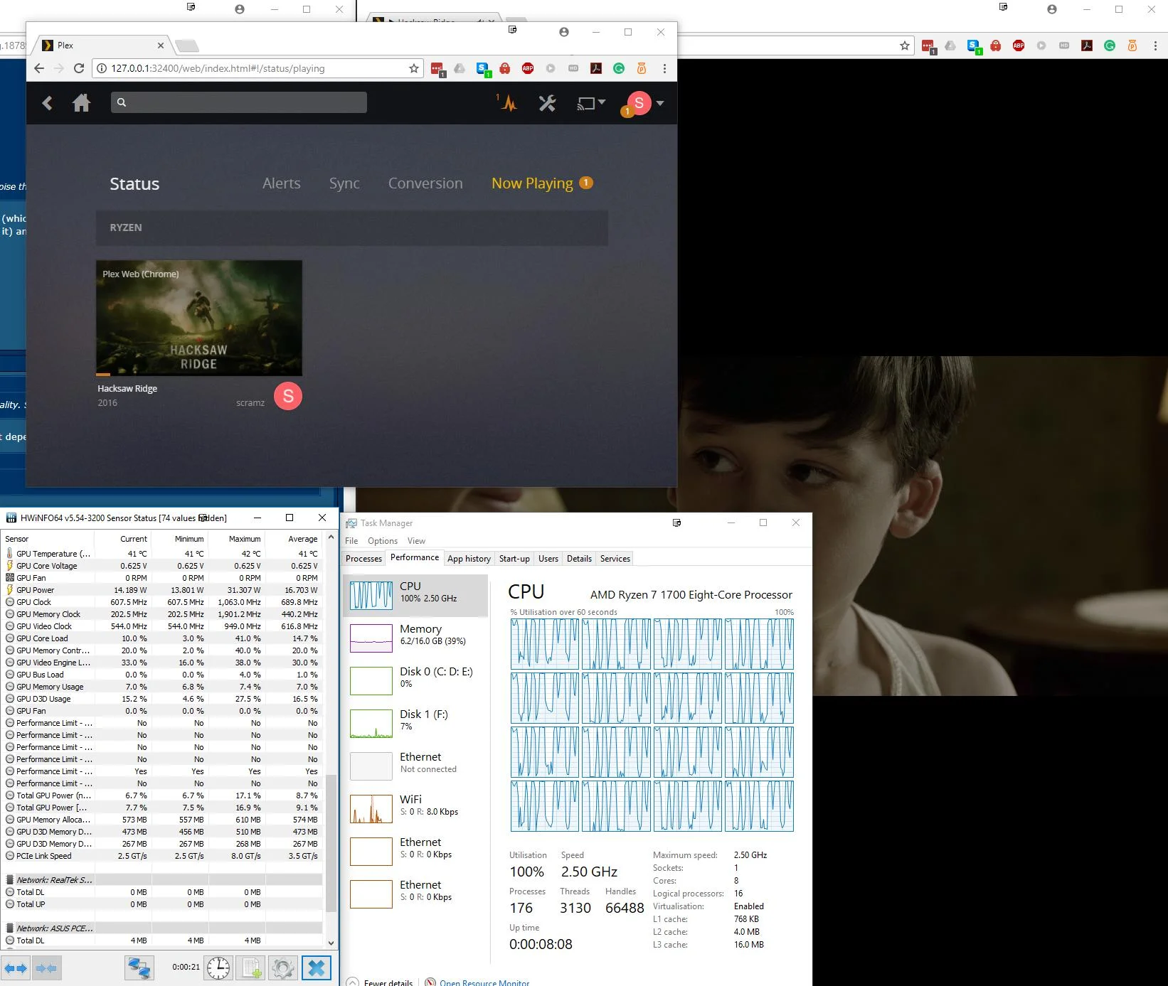

A) Zero help from the GPU, see GPU utilisation below.

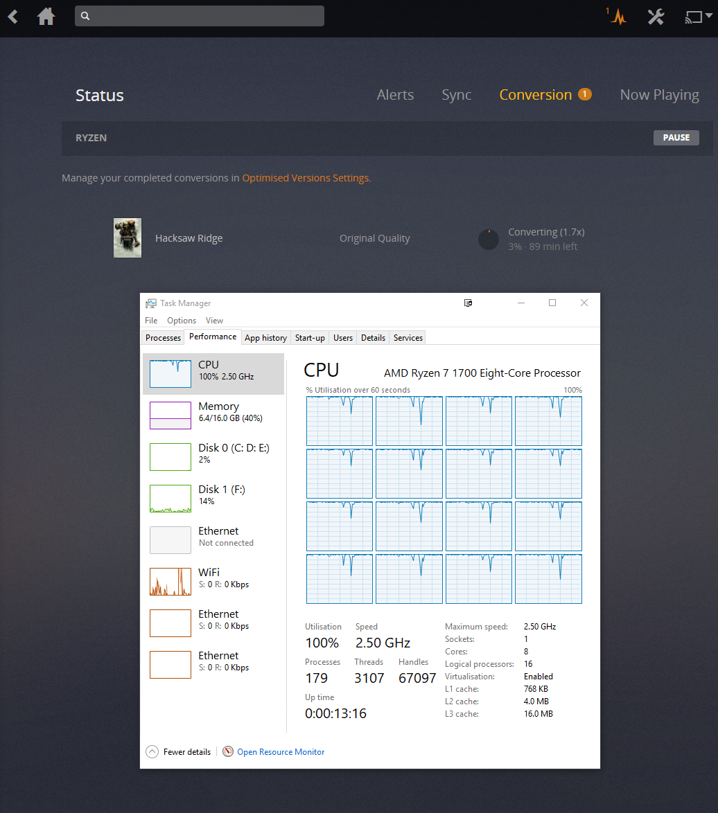

C) You don't need a gem, to put it into perspective I quickly dropped the CPU clocks to 2.5Ghz on all cores which is waaayyyy below stock clocks as you can see from Task Manager in the below screen grab and it is handling 4k transcoding with ease, to the point it is even throttling the transcode. Sub 2Ghz would proberly transcode 4k fine, 16 threads is nothing to be sniffed at.
It is even settling encoding at about 1.7x (below) hitting 2.4x and 1.4x jumping.

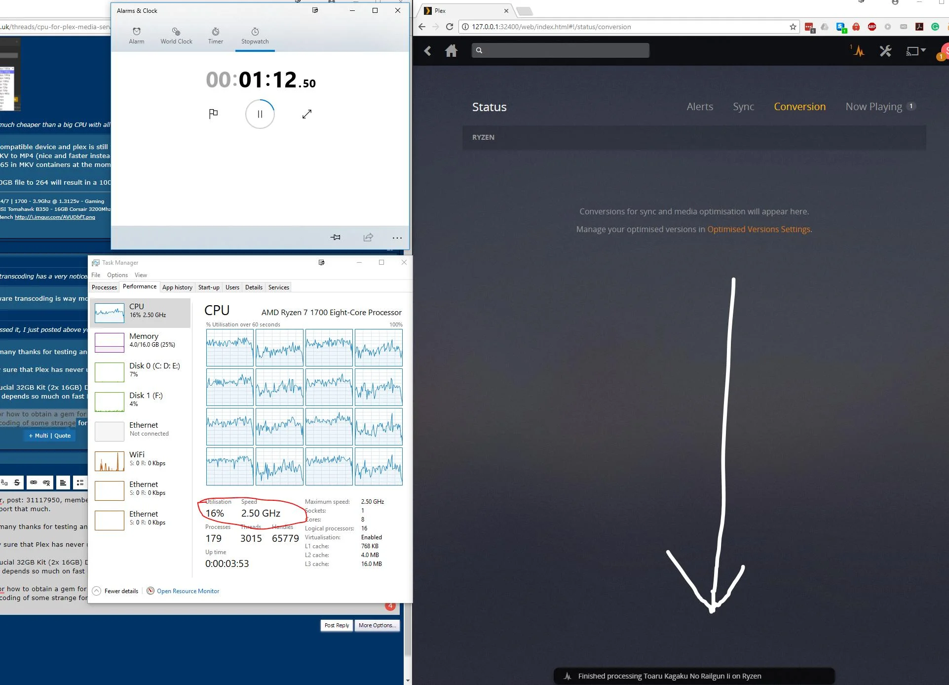

Below, I even did your video test on 2.5Ghz, finished in 1 min 12 sec.

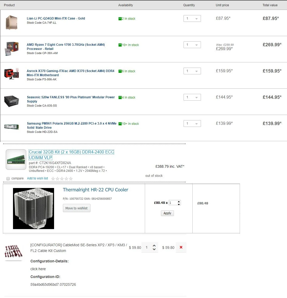

Looking to get the following parts hoping for a fanless media server. Not sure whether it'll work but you are giving me much hope to control the TDP well below 50W! I'll need a gem as good as I can get so I can undervolt as much I can. Since it's a fanless system, I'll need all the undervolting headroom I can get!
The plan is to get the rig up and running Linux without a graphics card (well maybe install the OS with a graphics card) then plug it to the router and only use SSH to control it. In the future maybe I'll slot in an R9 nano (or Vega 64 nano if it will exist/edit: just released), but that would violate the fanless criteria.
I'm a bit worried about the motherboard - the 8-pin location is crap and would require customised replacement cable. I'm also not sure whether the location of the CPU socket would cause any issues with the relatively big cooler in a small case. Will this motherboard work well with Ryzen 1700 for undervolting purposes?
