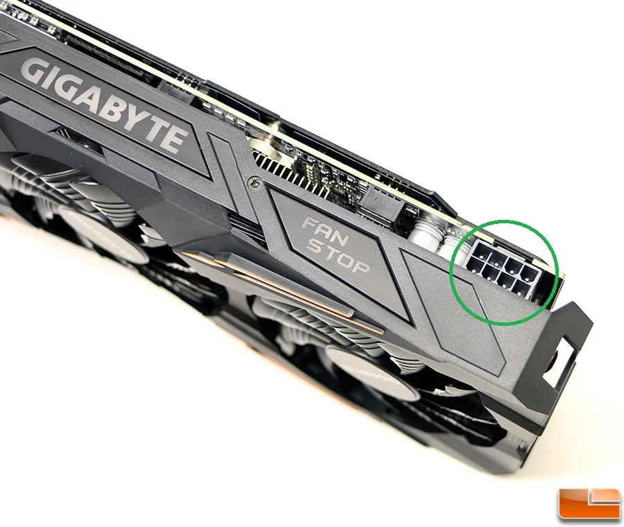

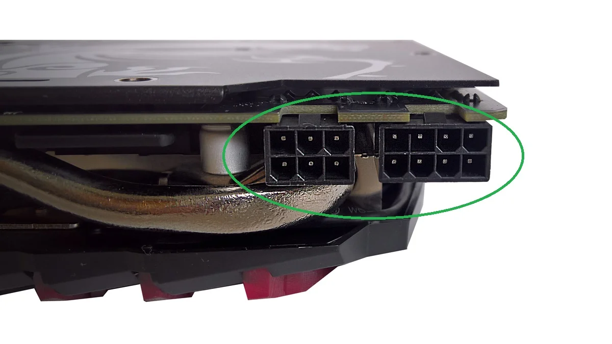

Nah not stupid. Pics will help cement the idea.
This is a Gigabyte G1 1070 with an 8-pin connector:
And this is an MSI Gaming X 1070 with 8-pin and a 6-pin connectors:

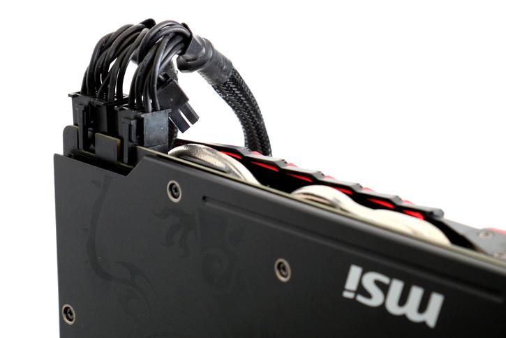

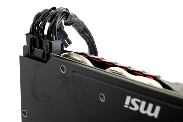

This is how the cables from the power supply connect to those:
Now take a look at the info for your power supply and you will see it has just one PCIe 8 (6+2) pin for a graphics card. e.g. Enough for a card like the G1 (and in fact for most 1070 models), not enough for some cards like the Gaming X.
