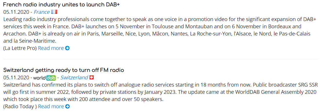

The UK was one of the pioneering DAB markets and today, over half of all listening is on digital. At the WorldDAB General Assembly earlier this month, Digital Radio UK’s Ford Ennals and Yvette Dore provided an overview of the UK digital radio market and Ian O’Neill, Head of Radio at the UK Government’s department of Digital Culture, Media, and Sport, told us what the UK is doing to help safeguard the future of radio.
Growing figures and digital offering
Despite the disruption caused by Covid-19, overall radio listening has remained robust. By the end of Q12020, digital listening had reached 58.6% of all listening, with 70% of digital listening taking place on DAB/ DAB+. The growth in digital listening has been driven by an increase in the number of cars fitted with DAB, the launch of new national commercial stations on DAB, as well as in-home online listening, said Dore.
The commercial radio sector has also continued to expand with new stations launching throughout 2020. There are now 54 national stations available on DAB/DAB+ across the UK – the most recent of which launched in October.
https://www.worlddab.org/news/blog/65/uk-–-government-support-and-digital-growth-reflect-dab+-uptake
