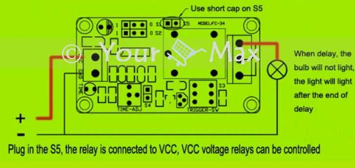

Any electrical bods here could advise me on wiring in a relay delay switch?
Problem is when starting the engine it's causing the camera to lose power briefly, causing it to shutdown and it doesn't restart automatically when power is restored.

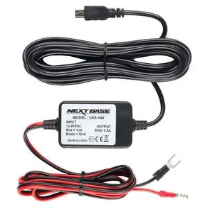

I've got it hard wired into an empty fuse bay using this kit.

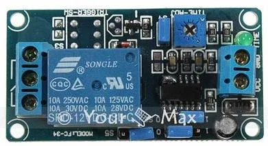

I've gone and purchased this to delay startup by 10 seconds.
http://www.ebay.co.uk/itm/251555299645
With regards to wiring it is this correct? Does the camera still need its own power source, or will the relay pass it through? (As this device seems to suggest otherwise).
