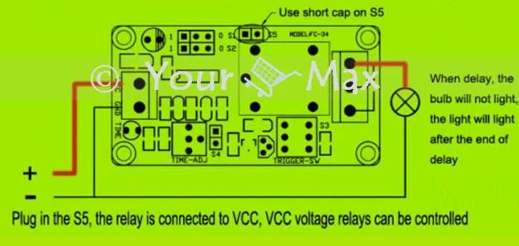

With regards to wiring it is this correct? Does the camera still need its own power source, or will the relay pass it through? (As this device seems to suggest otherwise).
Thanks!

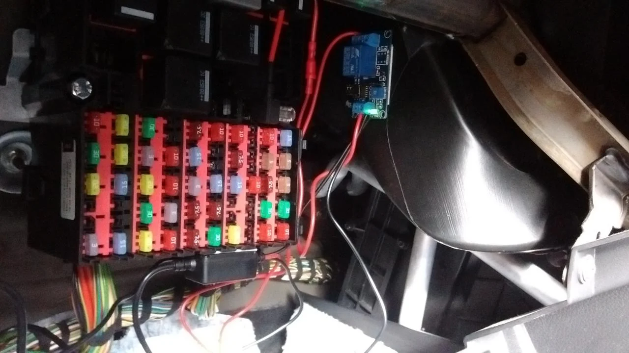

For those interested it work as per the diagram, passes the current through.
Works a treat, I've set the delay to 12 seconds, the countdown starts soon as I turn the electrics on at the ignition, giving me time to wait for the glowplug light on the dash to turn off then crank the engine, after which it switches the camera on.
Strangely the relay switch doesn't lose power when cranking the engine, so it must only be the dashcam that's sensitive to it.
