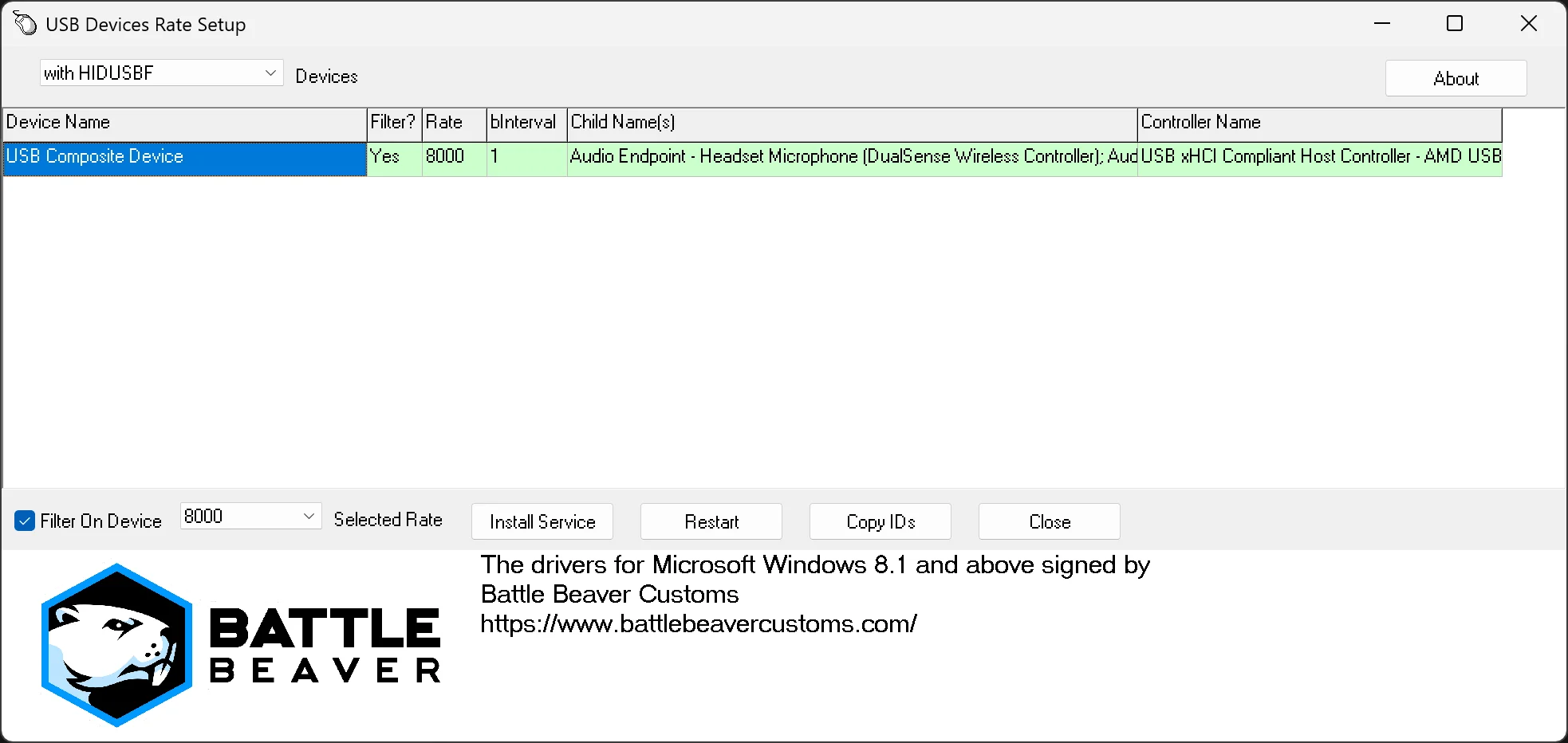

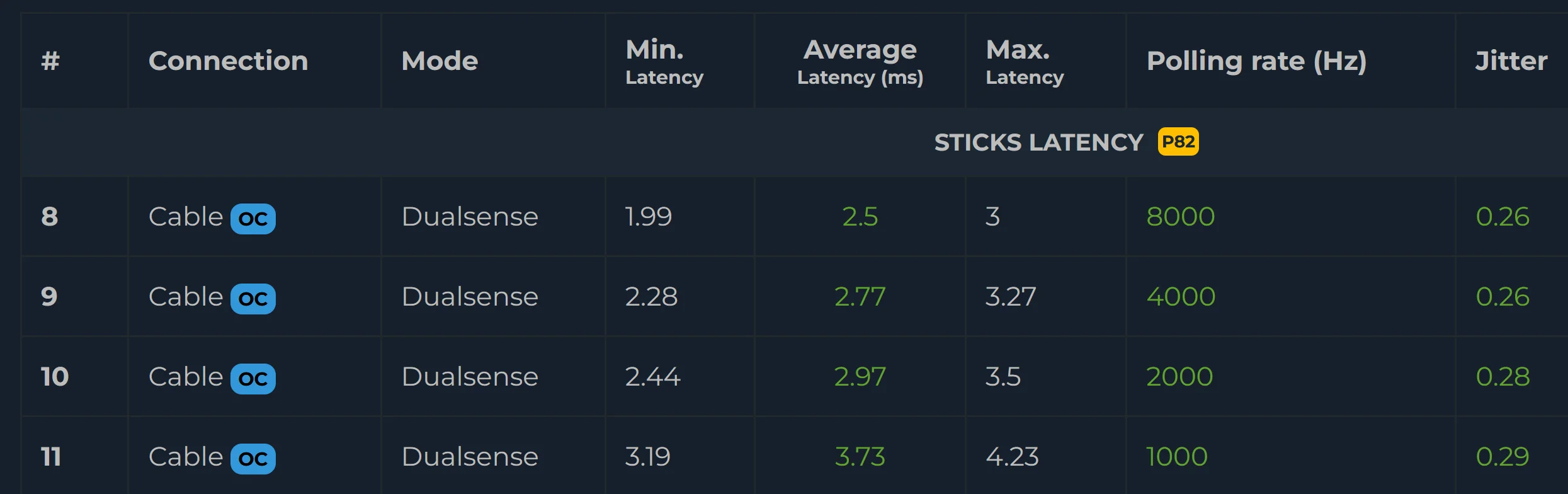

I noticed in the hidusbf screenshot you have it set to 1000 and your bInterval is 4. My understanding is that a DualSense needs to be set to 8000 to have a true 1000Hz polling rate, the USB interface will be running at 8000Hz but the same input gets repeated 8 times. I assume with a bInterval of 4 the true polling rate is 250Hz. It should look like this:
I did actually try that and found no difference in games or in measurement tools, exact same results, and seems online sources seem to vary on what they recommend too so in the end I just settled on what is shown. Maybe it's different with the Phantom vs an OG DualSense perhaps?
I checked gamepadla and the stick latency going from 1000Hz to 8000Hz is only 1.23ms lower, so setting it to 1000 with a bInterval of 4 is clearly not 250Hz which is a bit confusing.
"Some more research later, though I am still not 100% sure on its accuracy, revealed that the DualSense controllers can internally poll at up to 8000 times per second, even if the USB polling rate is lower. This means that even at 250Hz, the controller performs very well. My findings align with this information, so I am tending to lean on this being true, though if anyone knows otherwise, please do let us know in the comments!"
DualSense is definitely not 8000Hz internally, it's 1000Hz. How would an internal polling rate of 8000Hz mean that it performs very well at 250Hz? @mrk
As in the internal report rate of the controller vs the USB polling rate much like how certain gaming keyboards are advertised as 8K but their internal report rate is far below whereas you can also get true 8K keyboards too.
Anyway I left that area open ended, if someone knows the correct details then they can leave a comment and the section updated.
