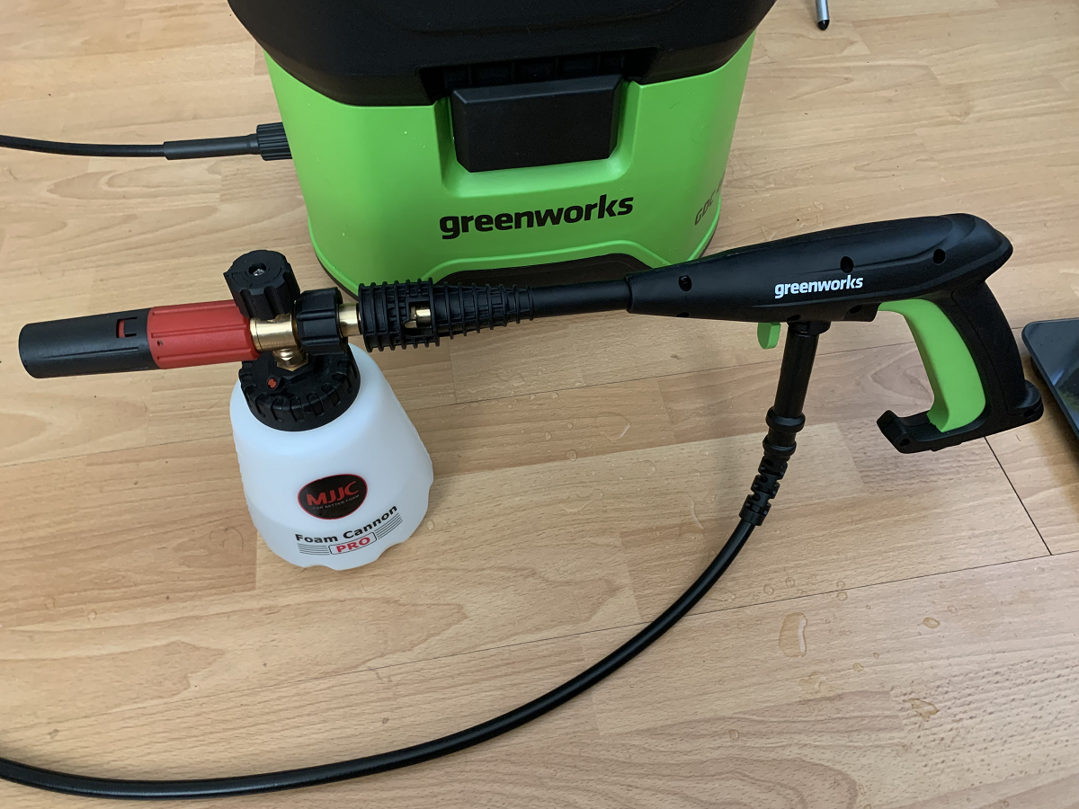

@Mekrel I know I’m probably being thick here but where do you connect the MJJC foam cannon to the Greenworks?
it must go on the end somewhere ?
are you sure the end of the gun you cant screw it off anywhere ?
is this the same type of equipment ?
you can see his dismantles, so you should be able to see where it goes ? (if the same)

I think I've got it sussed...
Here's a video showing how easy it is to connect and disconnect the MJJC foam lance to the greenworks...

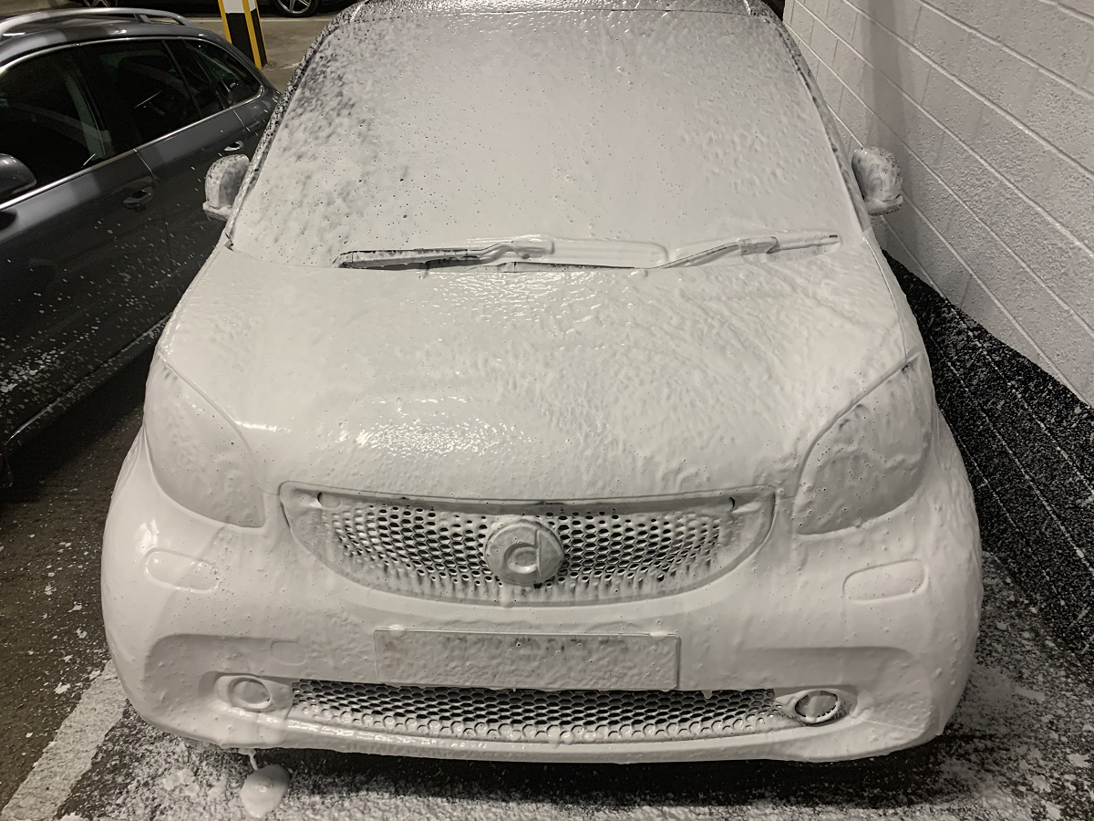

Just tried out the Greenworks GDC40 with the MJJC Foam Cannon Pro V2.0 for the first time...
Got some very nice foam, very pleased with it well worth the money.
Do you charge the owner of the car next to yours for the foam treatment too? :p
Lol I noticed that, I couldn’t be bothered to reverse out of the space and apply it away from other cars. I just wanted to test it out. I’ll do a proper job in the early hours of the morning, out of the way of other cars.

Hey man, I recently purchased the Greenworks GDC40 and I'm trying to fit a short trigger gun on the end of it.
I saw your post on PistonHeads also that it uses the Kew/Alto/Nilfisk connector, I've tried two now and I can't get the short trigger lance to fit on the end of the hose.
I'm in a flat with no water supply outdoors and hoping to find a good solution, with hopefully a snow foam solution. Wondered if you had managed to achieve this, or had any information on what the fitting on the end of the hose is? Greenworks weren't able to help as they said their parts are custom to Greenworks equipment.
I'm trying to avoid buying a new hose as of yet, but would love to find a solution in the meantime. Thanks
Hi, I got mine from Mekrel and as you can see from my postings above it fits perfectly. To get one like mine go here...
https://www.in2detailing.co.uk/prod...ro-replacement-adaptor?variant=39503136391247
It says "If you are purchasing (or have purchased) a short trigger gun, you will need the 1/4 Quick Release adaptor." You can select one from the above link, don't know if it will work for you.
I'm using the MJJC Snow Foam Lance Cannon Pro V2
