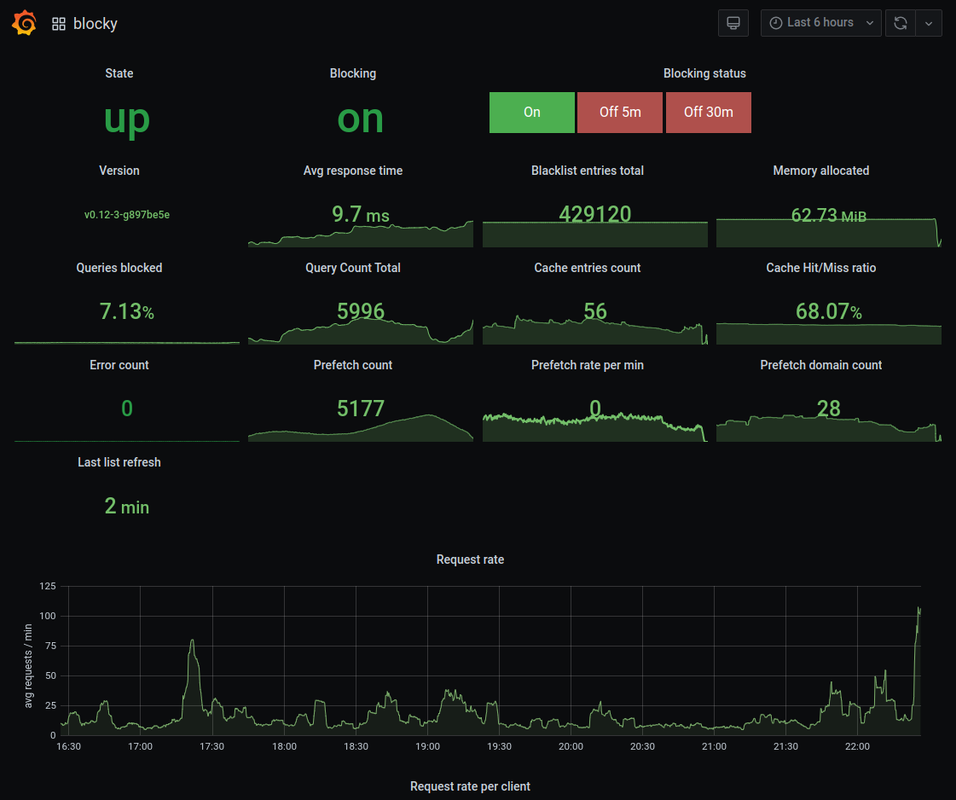

- UPDATED 2nd Feb 2024 to put Blocky, Grafana and Prometheus inside a single Docker Compose file, and have everything run automagically (you'll still need to fill out Blocky's config.yml with your LAN device names, preferred blocklists etc first!). Run the project inside the following folder structure, else it won't work. The paths in the Compose file are relative!

Prometheus config file prometheus.yml:
Code:
global:
  scrape_interval:     15s
  evaluation_interval: 15s
scrape_configs:
  - job_name: 'blocky'
    static_configs:
    - targets: ['localhost:4000']
Grafana config file datasource.yml:
Code:
apiVersion: 1
deleteDatasources:
  - name: Prometheus
    orgId: 1
datasources:
- name: Prometheus
  type: prometheus
  access: proxy
  orgId: 1
  url: http://localhost:9090
  isDefault: true
  jsonData:
     graphiteVersion: "1.1"
     tlsAuth: false
     tlsAuthWithCACert: false
  version: 1
  editable: true
Once your project is running and you've waited a minute or two (for Blocky to load the filter lists, etc), you can visit http://192.168.1.20:3000 (use the appropriate LAN IP of the device!) and the Grafana dashboard login page will load. User and pass are admin:admin by default, and it will ask you to change the password on first login. From there, go to Dashboards > New dashbaord > Import. Paste in the following code:
Code:
  "__inputs": [
      "name": "DS_PROMETHEUS",
      "label": "Prometheus",
      "description": "",
      "type": "datasource",
      "pluginId": "prometheus",
      "pluginName": "Prometheus"
      "name": "VAR_BLOCKY_URL",
      "type": "constant",
      "label": "blocky API URL",
      "value": "",
      "description": ""
  "__elements": [],
  "__requires": [
      "type": "grafana",
      "id": "grafana",
      "name": "Grafana",
      "version": "8.3.3"
      "type": "panel",
      "id": "heatmap",
      "name": "Heatmap",
      "version": ""

          "expr": "blocky_blocking_enabled",
          "format": "table",
          "instant": true,
          "interval": "",
          "legendFormat": "",
          "refId": "A"
      "title": "Blocking",
      "transparent": true,
      "type": "stat"

          "expr": "sum(increase(blocky_request_duration_ms_sum[$__range])) / sum(increase(blocky_request_duration_ms_count[$__range]))",
          "format": "table",
          "instant": false,
          "interval": "",
          "legendFormat": "",
          "refId": "A"
      "title": "Avg response time",
      "type": "stat"

        "y": 8
      "id": 45,
      "options": {
        "colorMode": "value",
        "graphMode": "area",
        "justifyMode": "auto",
        "orientation": "auto",
        "reduceOptions": {
          "calcs": [
            "last"
          "fields": "",
          "values": false
        "textMode": "auto"
      "pluginVersion": "8.3.3",
      "targets": [
          "datasource": {
            "type": "prometheus",
            "uid": "${DS_PROMETHEUS}"
          "exemplar": true,
          "expr": "sum(blocky_cache_entry_count)/ sum(up{job=~\"$job\"})",
          "format": "table",
          "instant": false,
          "interval": "",
          "legendFormat": "",
          "refId": "A"
      "title": "Cache entries count",
      "type": "stat"
      "datasource": {
      "description": "Cache Hit/Miss ratio. 100 % means, all queries could be answered from the cache, 0% - all queries must be resolved via external DNS",
      "fieldConfig": {
        "defaults": {
          "color": {
            "mode": "thresholds"
          "mappings": [],
          "max": 1,
          "min": 0,
          "thresholds": {
            "mode": "absolute",
            "steps": [
                "color": "green",
                "value": null
          "unit": "percentunit"
        "overrides": []
      "gridPos": {
        "h": 3,
        "w": 6,
        "x": 18,
        "y": 8
      "id": 47,
      "options": {
        "reduceOptions": {
          "calcs": [
            "mean"
          "fields": "",
          "values": false
        "textMode": "auto"
      "targets": [
          "datasource": {
          "exemplar": true,
          "expr": "sum(increase(blocky_cache_hit_count[$__range])) / (sum(increase(blocky_cache_hit_count[$__range])) + sum(increase(blocky_cache_miss_count[$__range])))",
          "format": "table",
          "instant": false,
          "interval": "",
          "legendFormat": "",
          "refId": "A"
      "title": "Cache Hit/Miss ratio",
      "type": "stat"
      "datasource": {
      "description": "Number of occured errors",
      "fieldConfig": {
        "defaults": {
          "decimals": 0,
          "mappings": [
              "options": {
                "match": "null",
                "result": {
                  "text": "N/A"
              "type": "special"
          "thresholds": {
            "mode": "absolute",
            "steps": [
                "color": "#299c46",
                "value": null
                "color": "rgba(237, 129, 40, 0.89)",
                "value": 1
                "color": "#d44a3a"
          "unit": "short"
        "overrides": []
      "gridPos": {
        "h": 3,
        "w": 6,
        "x": 0,
        "y": 12
      "id": 36,
      "links": [],
      "maxDataPoints": 100,
      "options": {
        "orientation": "horizontal",
        "reduceOptions": {
          "calcs": [
            "lastNotNull"
          "fields": "",
          "values": false
        "textMode": "auto"
      "targets": [
          "datasource": {
          "exemplar": true,
          "expr": "sum(increase(blocky_error_total[$__range]))",
          "format": "table",
          "instant": false,
          "interval": "",
          "legendFormat": "",
          "refId": "A"
      "title": "Error count",
      "type": "stat"
      "datasource": {
      "description": "Amount of performed DNS queries to prefetch cached queries",
      "fieldConfig": {
        "defaults": {
          "mappings": [],
          "thresholds": {
            "mode": "absolute",
            "steps": [
                "color": "green",
                "value": null
        "overrides": []
      "gridPos": {
        "h": 3,
        "w": 6,
        "x": 0,
        "y": 9
      "id": 53,
      "options": {
        "reduceOptions": {
          "calcs": [
            "lastNotNull"
          "fields": "",
          "values": false
        "textMode": "auto"
      "targets": [
          "datasource": {
          "exemplar": true,
          "expr": "ceil(sum(increase(blocky_prefetch_count[$__range])))",
          "format": "table",
          "interval": "",
          "legendFormat": "",
          "refId": "A"
      "title": "Prefetch count",
      "type": "stat"
      "datasource": {
      "description": "Amount of prefetch queries per minute",
      "fieldConfig": {
        "defaults": {
          "mappings": [],
          "thresholds": {
            "mode": "absolute",
            "steps": [
                "color": "green",
                "value": null
                "color": "red",
                "value": 80
        "overrides": []
      "gridPos": {
        "h": 3,
        "w": 6,
        "x": 12,
        "y": 11
      "id": 51,
      "options": {
        "reduceOptions": {
          "calcs": [
            "lastNotNull"
          "fields": "",
          "values": false
        "textMode": "auto"
      "targets": [
          "datasource": {
          "exemplar": true,
          "expr": "sum(rate(blocky_prefetch_count[5m])) * 60",
          "format": "table",
          "interval": "",
          "legendFormat": "",
          "refId": "A"
      "title": "Prefetch rate per min",
      "type": "stat"
      "datasource": {
      "description": "How many of cached entries were prefetched automatically",
      "fieldConfig": {
        "defaults": {
          "color": {
          "mappings": [],
          "max": 1,
          "min": 0,
          "thresholds": {
            "mode": "absolute",
            "steps": [
                "color": "green",
                "value": null
        "overrides": []
      "gridPos": {
        "h": 3,
        "w": 6,
        "x": 18,
        "y": 11
      "id": 58,
      "options": {
        "reduceOptions": {
          "calcs": [
            "mean"
          "fields": "",
          "values": false
        "textMode": "auto"
      "targets": [
          "datasource": {
          "exemplar": true,
          "expr": "sum(increase(blocky_prefetch_hit_count[$__range])) / (sum(increase(blocky_cache_hit_count[$__range])))",
          "format": "table",
          "instant": false,
          "interval": "",
          "legendFormat": "",
          "refId": "A"
      "title": "Prefetch Hit ratio",
      "type": "stat"
      "description": "Time since last list refresh",
      "fieldConfig": {
        "defaults": {
          "decimals": 0,
          "mappings": [],
          "thresholds": {
            "mode": "absolute",
            "steps": [
                "color": "green",
                "value": null
          "unit": "s"
        "overrides": []
      "gridPos": {
        "h": 3,
        "w": 6,
        "x": 18,
        "y": 5
      "id": 57,
      "options": {
        "reduceOptions": {
          "calcs": [
            "lastNotNull"
          "fields": "",
          "values": false
        "textMode": "auto"
      "targets": [
          "datasource": {
          "exemplar": false,
          "expr": "sum(time() -blocky_last_list_group_refresh)/ sum(up{job=~\"$job\"})",
          "format": "table",
          "instant": true,
          "interval": "",
          "legendFormat": "",
          "refId": "A"
      "title": "Last list refresh",
      "type": "stat"
      "datasource": {
      "description": "Amount of unique domains in the prefetched cache",
      "fieldConfig": {
        "defaults": {
          "mappings": [],
          "thresholds": {
            "mode": "absolute",
            "steps": [
                "color": "green",
                "value": null
        "overrides": []
      "gridPos": {
        "h": 3,
        "w": 6,
        "x": 6,
        "y": 9
      "id": 49,
      "options": {
        "reduceOptions": {
          "calcs": [
            "lastNotNull"
          "fields": "",
          "values": false
        "textMode": "auto"
      "targets": [
          "datasource": {
          "exemplar": true,
          "expr": "sum(blocky_prefetch_domain_name_cache_count)/ sum(up{job=~\"$job\"})",
          "format": "table",
          "interval": "",
          "legendFormat": "",
          "refId": "A"
      "title": "Prefetch domain count",
      "type": "stat"
      "fieldConfig": {
        "defaults": {
          "color": {
            "mode": "palette-classic"
          "custom": {
            "axisLabel": "avg requests / min",
            "axisPlacement": "auto",
            "barAlignment": 0,
            "drawStyle": "line",
            "fillOpacity": 10,
            "gradientMode": "none",
            "hideFrom": {
              "legend": false,
              "tooltip": false,
              "viz": false
            "lineInterpolation": "linear",
            "lineWidth": 1,
            "pointSize": 5,
            "scaleDistribution": {
              "type": "linear"
            "showPoints": "never",
            "spanNulls": true,
            "stacking": {
              "group": "A",
              "mode": "none"
            "thresholdsStyle": {
              "mode": "off"
          "links": [],
          "mappings": [],
          "thresholds": {
            "mode": "absolute",
            "steps": [
                "color": "green",
                "value": null
                "color": "red",
                "value": 80
          "unit": "short"
        "overrides": []
      "gridPos": {
        "h": 7,
        "w": 24,
        "x": 0,
        "y": 15
      "id": 10,
      "options": {
        "legend": {
          "calcs": [],
          "displayMode": "hidden",
          "placement": "bottom"
        "tooltip": {
          "mode": "single"
      "targets": [
          "datasource": {
          "exemplar": true,
          "expr": "sum(rate(blocky_query_total[5m])) * 60",
          "format": "time_series",
          "instant": false,
          "interval": "",
          "legendFormat": " ",
          "refId": "A"
      "title": "Request rate",
      "type": "timeseries"
      "fieldConfig": {
        "defaults": {
          "color": {
          "custom": {
            "barAlignment": 0,
            "drawStyle": "bars",
            "fillOpacity": 100,
            "hideFrom": {
              "legend": false,
              "tooltip": false,
              "viz": false
            "lineWidth": 1,
            "pointSize": 5,
              "type": "linear"
            "spanNulls": true,
            "stacking": {
              "group": "A",
              "mode": "none"
              "mode": "off"
          "links": [],
          "mappings": [],
          "thresholds": {
            "mode": "absolute",
            "steps": [
                "color": "green",
                "value": null
                "color": "red",
                "value": 80
          "unit": "short"
        "overrides": []
      "gridPos": {
        "h": 7,
        "w": 24,
        "x": 0,
        "y": 22
      "id": 52,
      "options": {
        "legend": {
          "calcs": [],
          "displayMode": "list",
        "tooltip": {
          "mode": "single"
      "targets": [
          "datasource": {
          "exemplar": true,
          "expr": "sum by (client) (rate(blocky_query_total[5m])) * 60",
          "instant": false,
          "interval": "",
          "legendFormat": " {{client}}",
          "refId": "A"
      "title": "Request rate per client",
      "cards": {},
      "color": {
        "cardColor": "#FADE2A",
        "colorScale": "sqrt",
        "colorScheme": "interpolateYlOrBr",
        "exponent": 0.5,
        "mode": "opacity"
      "dataFormat": "tsbuckets",
      "gridPos": {
        "h": 9,
        "w": 24,
        "x": 0,
        "y": 29
      "heatmap": {},
      "hideZeroBuckets": false,
      "highlightCards": true,
      "id": 22,
      "legend": {
        "show": true
      "reverseYBuckets": false,
      "targets": [
          "datasource": {
          "exemplar": true,
          "expr": "sum(increase(blocky_request_duration_ms_bucket{response_type=\"RESOLVED\"}[$__range])) by (le)",
          "format": "heatmap",
          "instant": false,
          "interval": "",
          "legendFormat": "{{le}}",
          "refId": "A"
      "title": "request duration (upstream)",
      "tooltip": {
        "show": true,
        "showHistogram": false
      "type": "heatmap",
      "xAxis": {
        "show": true
      "yAxis": {
        "format": "ms",
        "logBase": 1,
        "show": true
      "yBucketBound": "auto"
      "fieldConfig": {
        "defaults": {
          "color": {
          "custom": {
            "hideFrom": {
              "legend": false,
              "tooltip": false,
              "viz": false
          "decimals": 0,
          "mappings": [],
          "unit": "short"
        "overrides": []
      "gridPos": {
        "h": 8,
        "w": 12,
        "x": 0,
        "y": 38
      "id": 2,
      "links": [],
      "maxDataPoints": 3,
      "options": {
        "legend": {
          "calcs": [],
          "displayMode": "table",
          "placement": "right",
          "values": [
            "value",
            "percent"
        "pieType": "donut",
        "reduceOptions": {
          "calcs": [
            "sum"
          "fields": "",
          "values": false
        "tooltip": {
          "mode": "single"
      "pluginVersion": "6.6.2",
      "targets": [
          "datasource": {
          "exemplar": false,
          "expr": " sort_desc(sum by (type) (ceil(increase(blocky_query_total[$__range]))))",
          "instant": true,
          "interval": "",
          "legendFormat": "{{ type }}",
          "refId": "A"
      "title": "Query by type",
      "type": "piechart"
      "fieldConfig": {
        "defaults": {
          "color": {
          "custom": {
            "hideFrom": {
              "legend": false,
              "tooltip": false,
              "viz": false
          "decimals": 0,
          "mappings": [],
          "unit": "short"
        "overrides": []
      "gridPos": {

        "x": 12,
        "y": 38
      "id": 8,
      "links": [],
      "maxDataPoints": 3,
      "options": {
        "legend": {
          "calcs": [],

Set the datasource to Prometheus:9090 (should be there automatically in the drop down box), and the API url (for Blocky) to http://localhost:4000. Save the dashboard and voilà! You should be up and running, though it will take a few mins for the dash to properly populate as Blocky starts to be used. Any questions, feel free to reply here or PM me! :)
Nice @Rainmaker - what are you running it on? Does it support DNS rewrite/custom host entries?
Currently on my Radxa Rock 5 model B (8 core Big+LITTLE, 16GB RAM, 1TB Sabrent Rocket NVMe) in Docker to make auto-(re)start painless and keep the logs tidy without messing with a database. If you look at the (admittedly longish) config.yml you'll see a section for host rewrites, and you can also tell it to incorporate /etc/hosts if you like. It's not 'pretty' or trendy, but it *is* solid, dependable and highly configurable. Being able to stop the kids seeing things they shouldn't without making life harder for, *ahem*, the neighbours?... and to block them from common encrypted DNS, VPNs and proxies while being able to use them myself is the icing on the cake. It's not perfect, but it's damn close.
