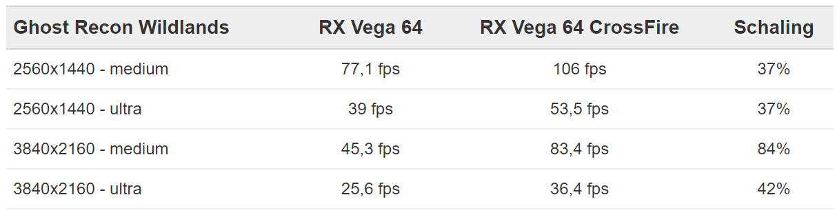

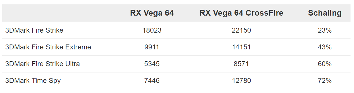

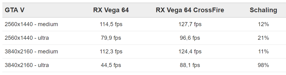

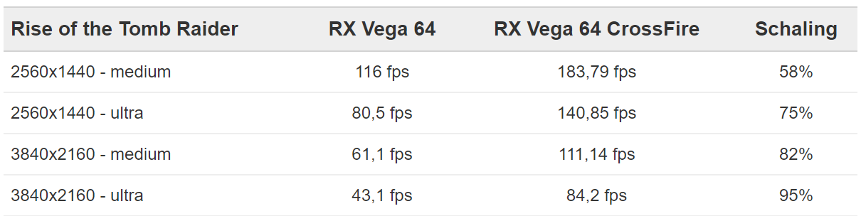

There is something else: for 4K gaming, CrossFire behaves well:
Wow, another of your epically misleading posts. From the conclusion of the article you linked:
With some difficulty, we managed to find four games in which adding a second Radeon RX Vega 64 works well.
Of the games that came out the past year, only a small number support multi-GPU setup.
Now, even more so than ever before, we advise you to buy one fast video card rather than several slower cards.
Multi-GPU setups behave well if they have developer support. Unfortunately for the majority of the games that is not the case. You would be a fool to buy a crossfire setup as a strategy for 4K gaming.
These quotes are bang on. Crossfire is all but dead unless you're a gamer who doesn't have time to play that often & only plays games that do scale well such as BF1 or GTA5. If that's you it may be a good option but if you tend to jump from game to game & usually grab new releases you'll be pulling your hair out over how bad the support is.
5 or so years ago I tried crossfire out with a pair of 7850's, I spent a week or so messing around with it before giving up & selling the second card, When Crossfire moved to XDMA I had high hopes for it's future but nothing improved enough to make it a viable option. Since then it seems things have only gotten worse.
Anyone promoting xfire/sli likely hasn't used them... I was xfired on 7970s and then Fury X's because I was an early 4k adopter and there wasn't a single GPU solution to even come close to powering that - and even that experience wasn't exactly great.. to the point where I'm never using a multi-GPU set up again.
