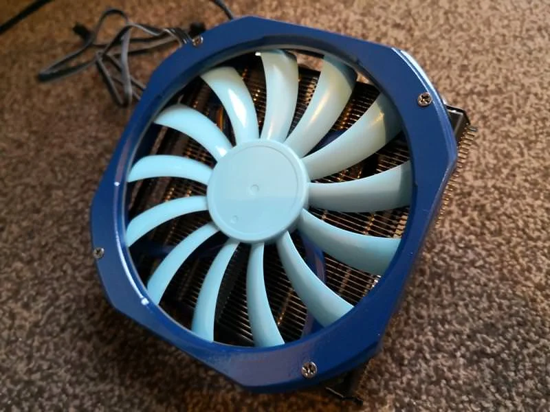

Sooooooo, feeling a bit bored (as usual through January!) I've decided it's time to change up the living room PC again, using a lot of the same components as my recent Short & Dumpy ITX build but into a new Parvum case and with a few new tweaks.
Components will be the same Asus Strix ITX motherboard, i7 6700k CPU and mini GTX 1060 graphics card. Can't even remember what RAM I used but, without pulling it apart or booting it up, I think it was 16GB @ 3200. Being a PC that's sometimes left for weeks without being used this will also be 100% air cooled.
Anyway, being Welsh you may have guessed from the title what the theme of this build is... Cardiff Blues :)
I won't be giving too much away as I'm waiting on the renders from the guys at Parvum, so don't actually have a final design yet. But I can tell you it will be based on this:

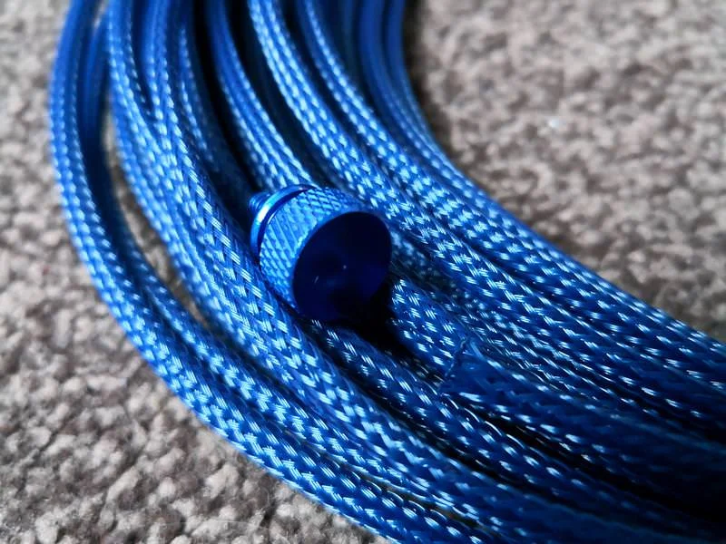

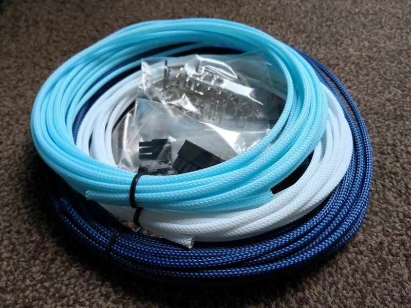

Obviously I haven't made much of a start yet apart from sourcing paint and cable braid in the correct colours (which I got VERY lucky with) but the new PSU and CPU cooler are here, the paint is here and the case & braiding are on order, so hopefully I'll have some proper updates ASAP. As a quick taster...
How lucky did I get with the paint and braiding colour match? This lucky:
The plan is to wait until the case has been dispatched before pulling the current rig apart as we use it for media streaming most evenings through the winter, but a few beers and a bit of boredom could easily see that plan change!
Anyway, hopefully I'll have some cables and a new case to show soon :)

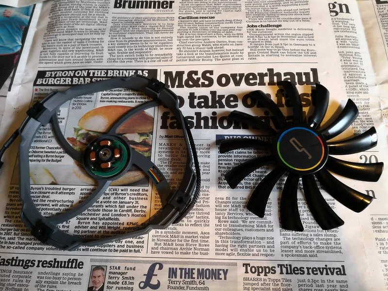

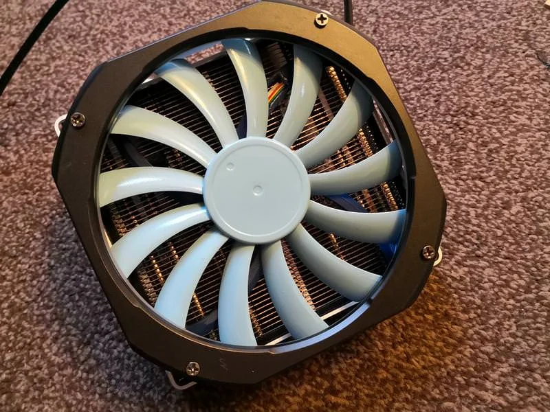

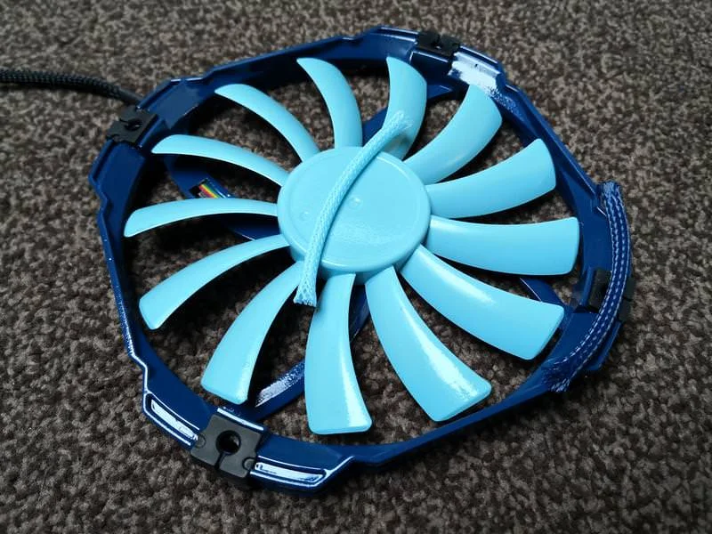

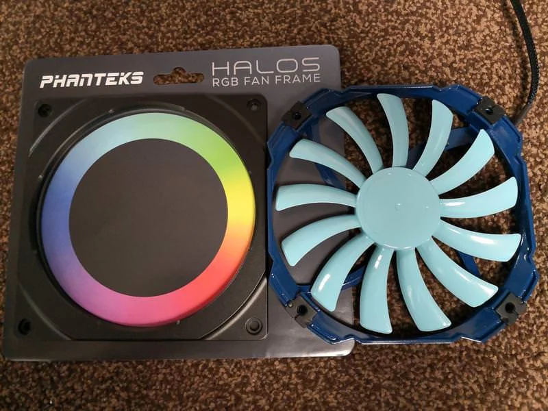

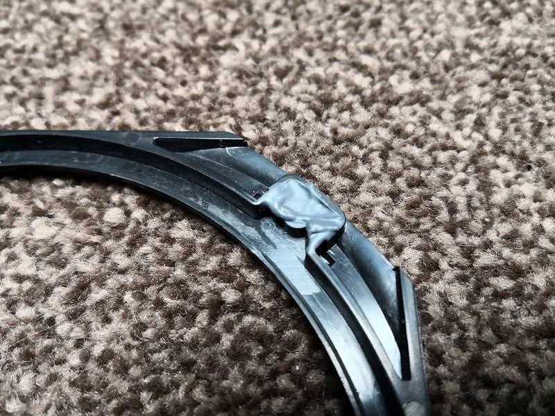

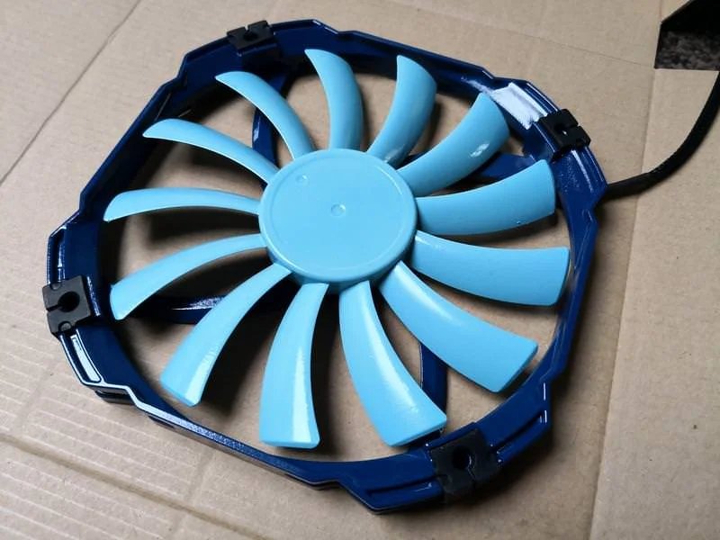

Still haven't heard back from Parvum but they said before Christmas it was mental busy down there, so guessing with the Xmas & NY break backing things up even more it could be a few weeks yet. In the meantime, I've found a spare few minutes to finish the CPU cooler. Being a large fan facing straight at the window I decided to add a bit of lighting, which turned out to be a bit more of a job than I'd originally hoped...

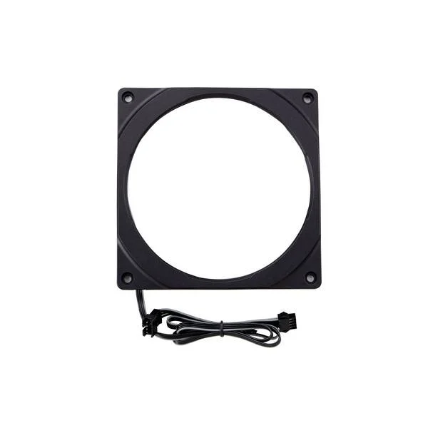

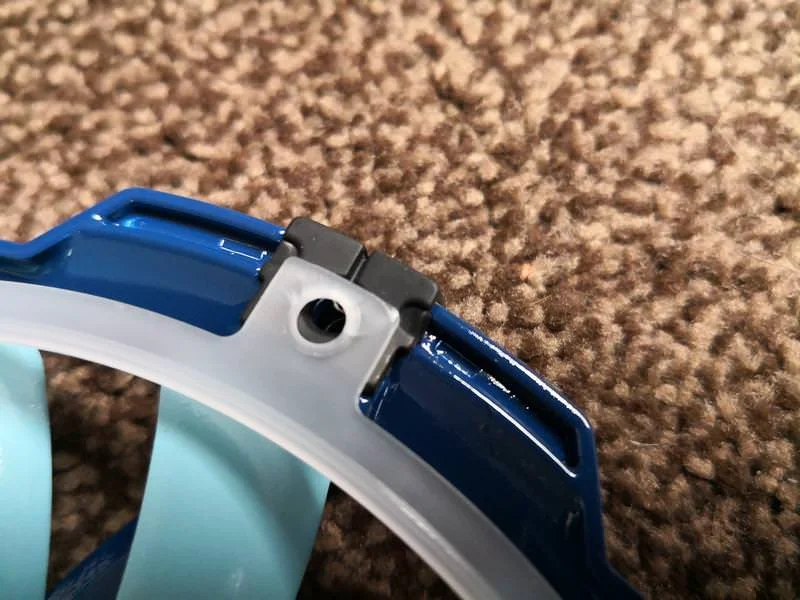

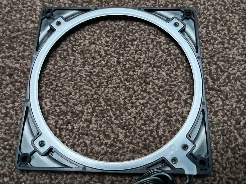

Anyway, I ordered one of these from OcUK

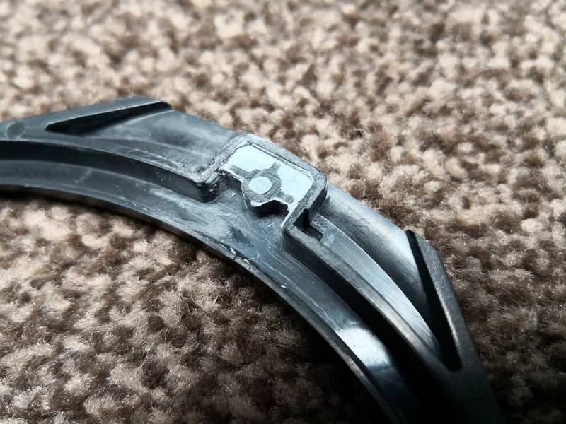

And needed to mount it onto this. As you can see there's a slight issue!

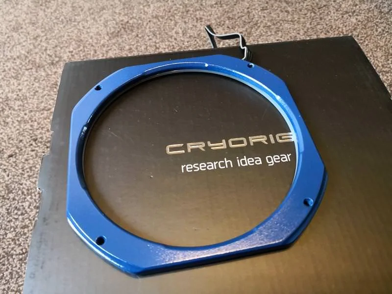

Hmmmmm, maybe I can use these holes instead...
NOPE! Nothing is ever that simple is it?

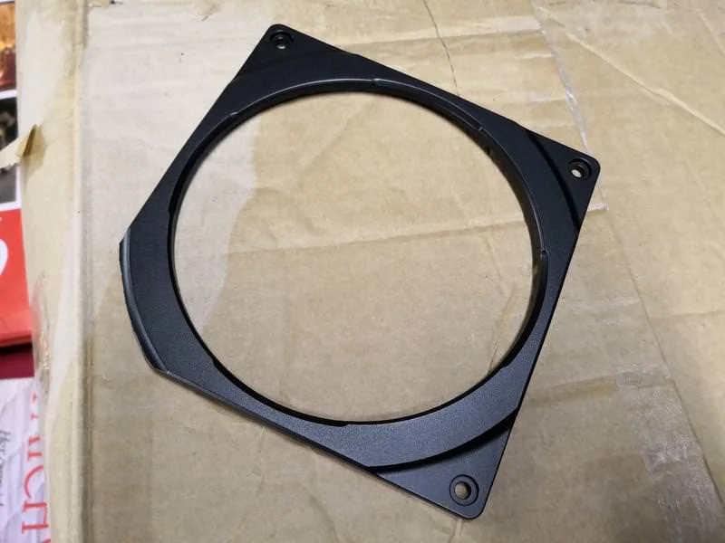

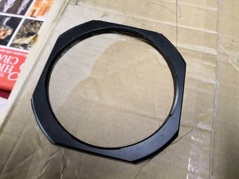

The corners came off...

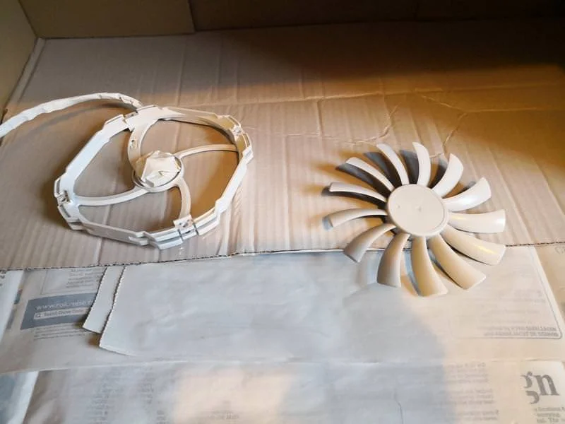

Some filler was filled...
...And sanded back
New holes were drilled and the fit checked

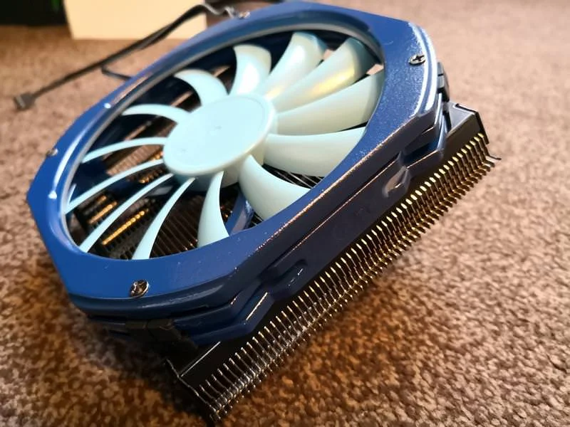

The corners were tidied up and some paint was added
RESULT! :D

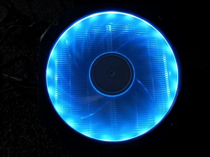

And lit up to check it all works
Please excuse the awful washed out photos that make the fan look pale grey, I can assure you it is still blue but Wales hasn't seen any sun today, so that's the results of a camera phone mixed with truly awful artificial lighting.
Before I go, here's a quick video for those who prefer the "Ate a bag of Skittles and puked on the fan" look ;)

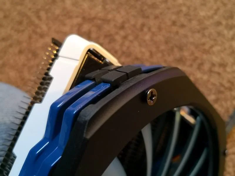

Up next in the "Damn, that was a lucky colour match!" series it's the thumb screws for the GPU :) #SpotTheThumbScrew
23 Apr 2010
11,896
West Sussex
Looking good, love the colours. I would have stuck the frames on with 3m double sided foam tape. I like how you shaped them, but those screws stick out kinda bad. Can you paint the heads? would be a lot less apparent then :)

Cheers mate :) Yeah, the plan is to paint the heads once the cooler has been mounted so that it doesn't chip when screwing them in, hopefully then it will look a bit neater.

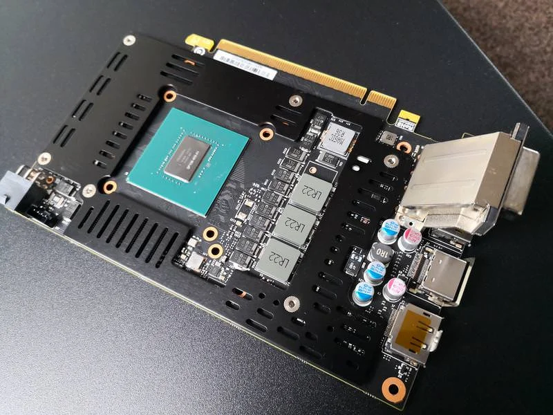

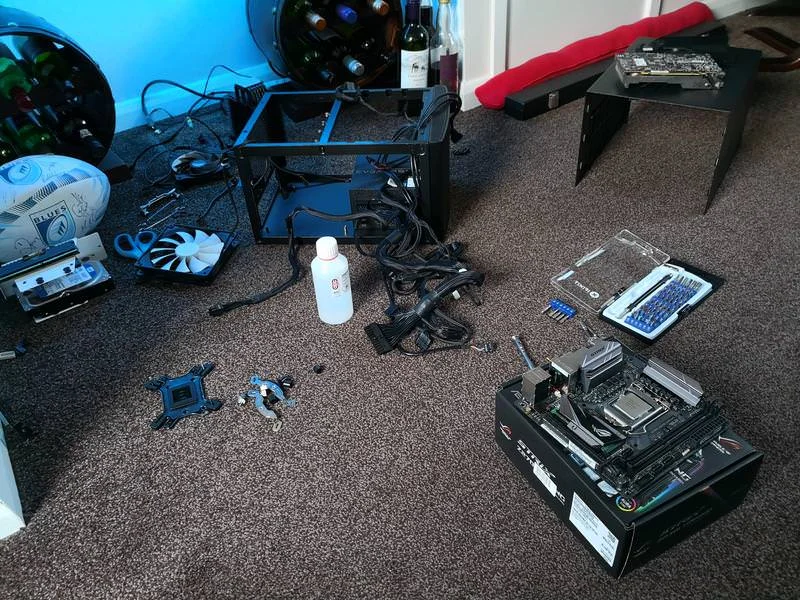

So I've been in touch with Parvum and have seen the render, but I'm making a few small changes to the design which could take a day or 2. After that she'll be onto the cutting and posting stage, so that can only mean one thing: Time to kill the current PC and rip his bits out ready for painting & transplanting :)

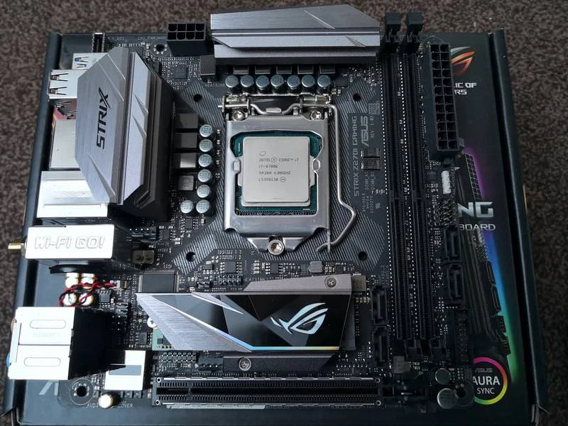

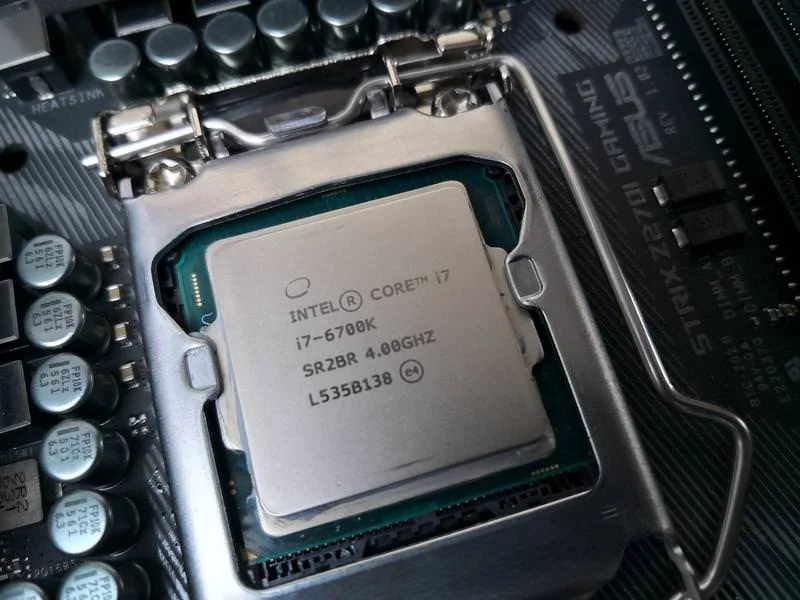

The Strix Z270 motherboard complete with delidded and liquid metal'd i7 6700k ready to be rehoused
Cleaned up and ready to go

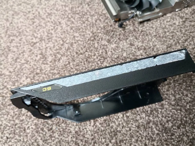

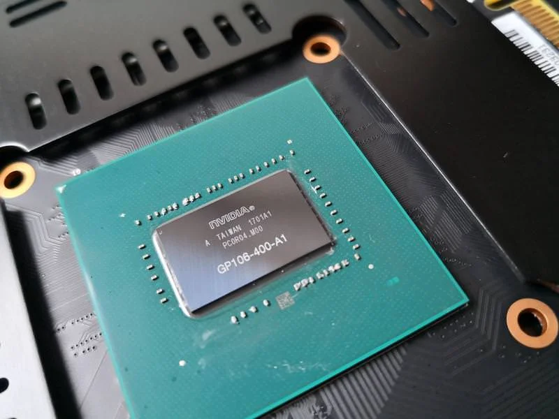

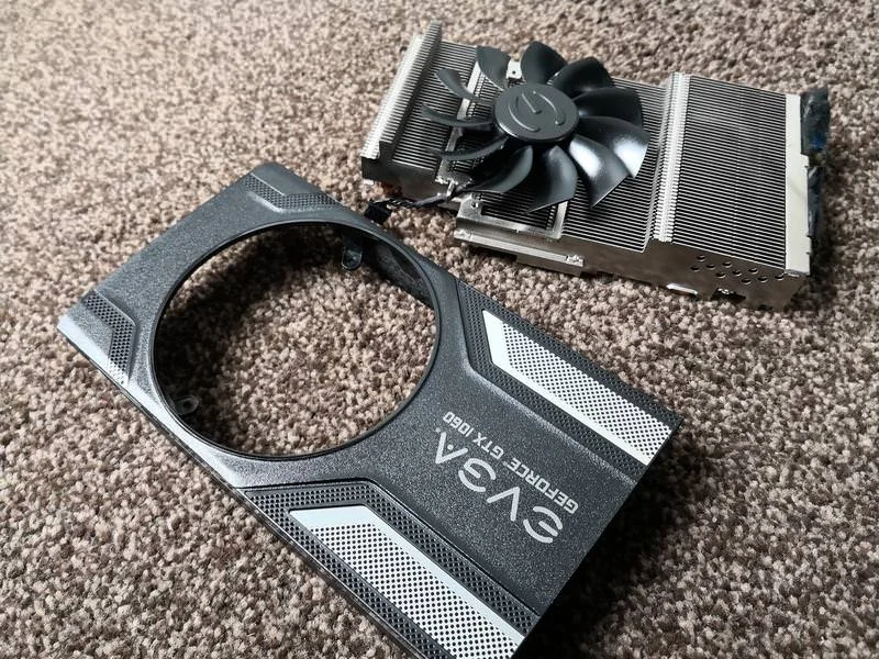

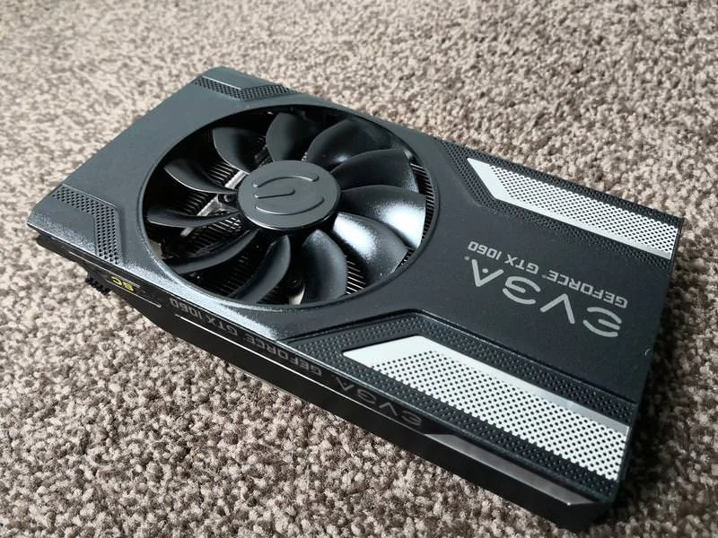

1060 cooler...

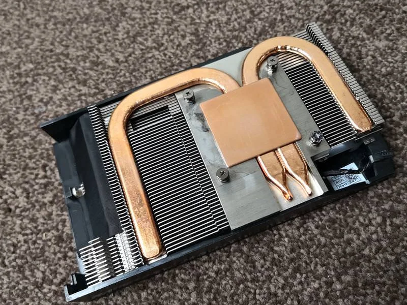

...And board separated ready for paint. Am I right in thinking this is the updated design without the cooling issues?
Shiny :cool:
Even if cooling isn't perfect, this should handle Netflix streaming pretty well I reckon!

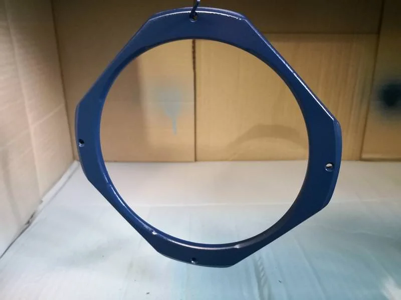

All going well and almost ready for paint...

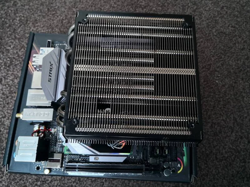

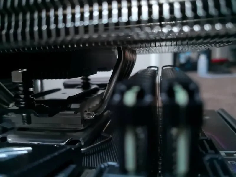

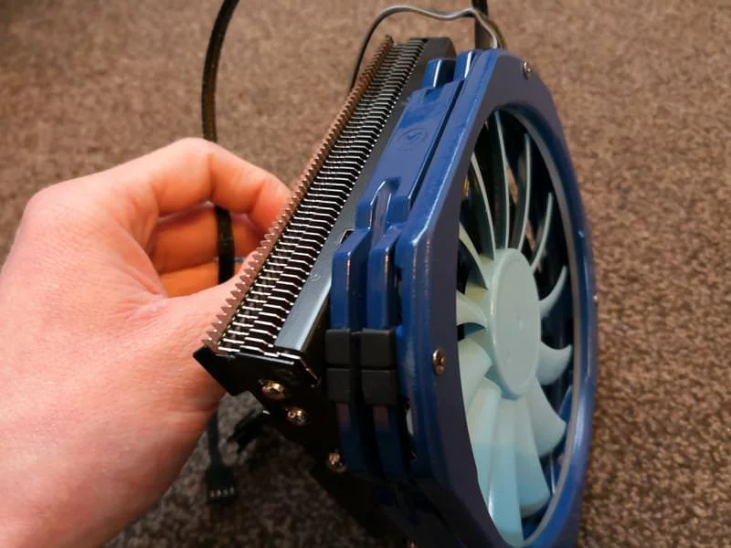

Quick check to make sure the cooler I've spent ages modifying and painting is actually going to fit over the RAM...
SUCCESS. Will also never stop giggling at how huge decent coolers look when used on an ITX board :D
