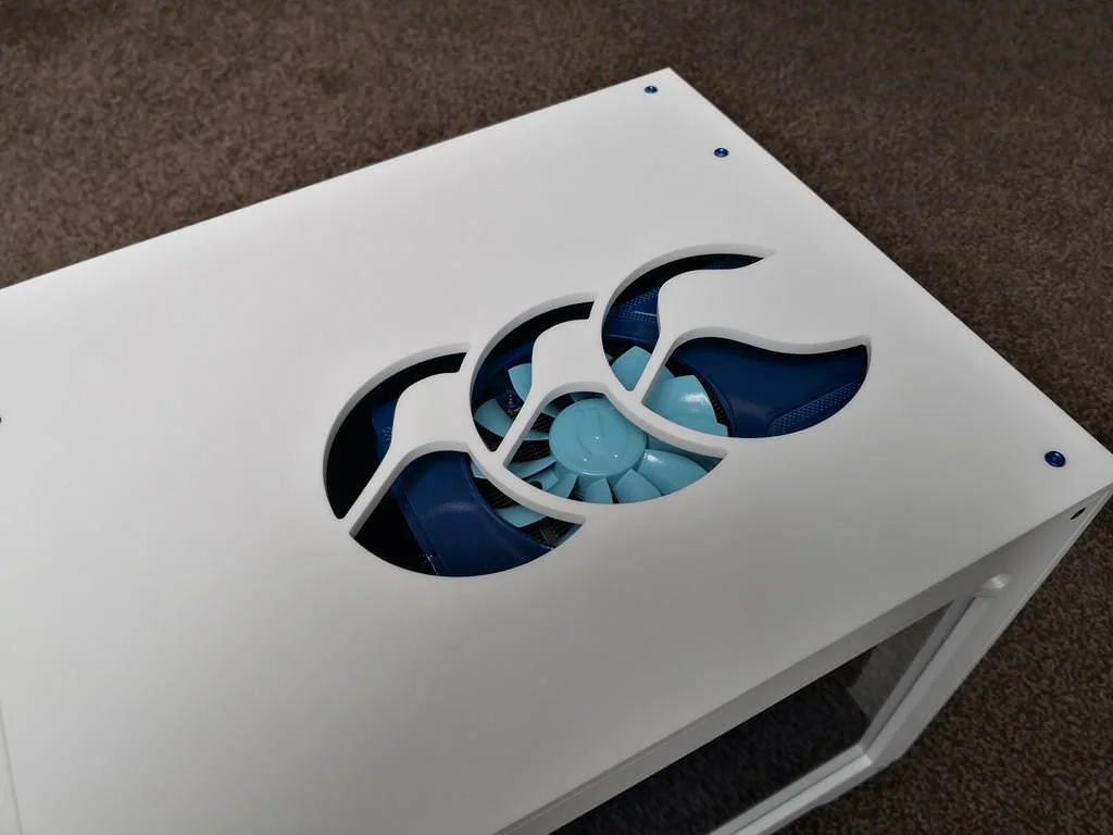

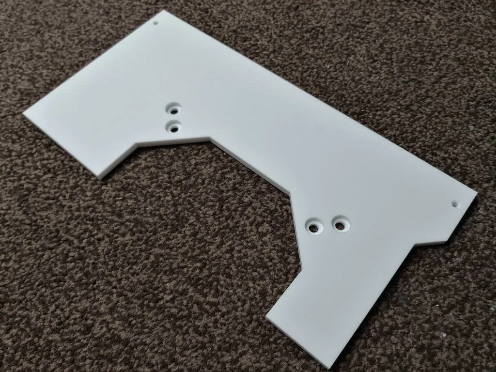

Excuse the extreme bodge on this (I can edit photos fine, but I'm truly awful at this kind of work!) but thoughts on this for the 80mm fan guard? Running through similar ideas for the 120mm fan but need the case here to see if my attempt to make things smoooooth is going to work... Hopefully be able to try it next week! :)
That's a lot better than I could do! The next challenge is to make it into a line drawing so the vector data can be passed to a CNC device. I'd check out the width of the lines where the arrows meet the oval, make sure it will be strong enough.
That is, assuming you were working on a laser design!
Was just a quick bodge up to see how it would look really, will have to learn how to use Inkscape properly now so I can do a proper version... This should be fun and not at all swear word inducing! :eek:

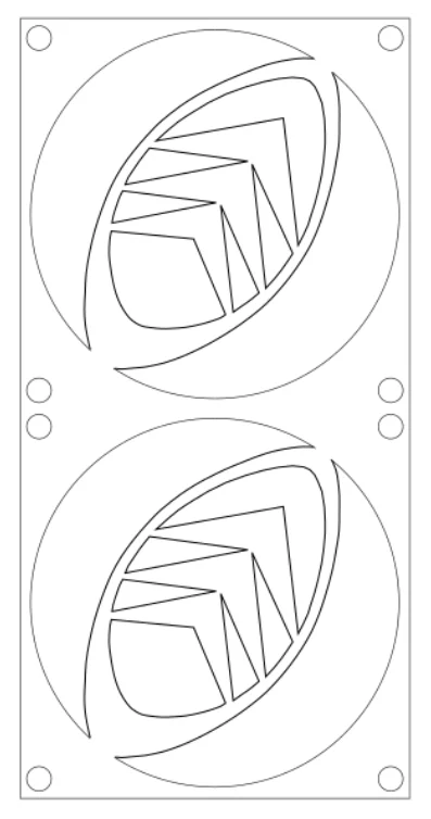

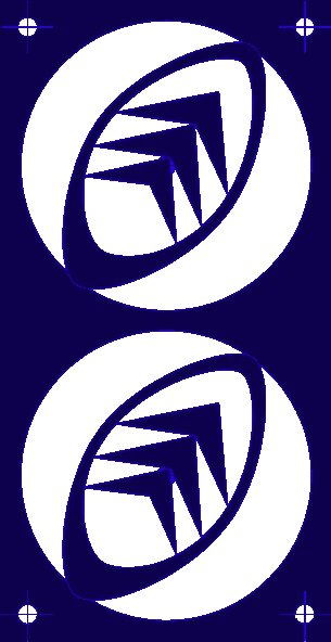

Still have zero idea what I'm doing, but through trial, error and swearing I've ended up with this... Am I right in thinking this could now be cut with a laser cutter? Sorry for the stupid questions but as I said, I have zero knowledge when it comes to Inkscape / laser cutters etc
Looks amazing! So, if you change the line thickness to 0.01mm you can export this to the laser cut software. Then colour code it, and assign each colour an order. Cut holes and internal shapes first, cut the outside outline last so it doesn't fall off the bed and spoil other cuts. Looks like you're well on the way :)
A rule of thumb is not to leave any material thinner than the thickness of sheet you're cutting i.e. don't leave a 2mm thin strip if cutting 3mm sheet. Make sense?
Think that makes sense, might be easier to start over and do it all in the correct thickness to start with so I'll give it a go Sunday if I get time. Thanks for all your help LuckyBenski, much appreciated :)

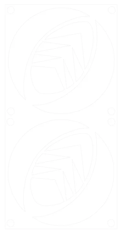

EDIT: Had a go at tracing over it in the correct thickness, hope this is OK!
T
Pleasure :)
That looks brill. I usually just select all then change line width, but I draw quite simple shapes like squares and circles! Reckon you'll give this a go then? Will it play nice with the Parvum's parts?
Definitely going to try it, just going to wait until the case arrives so I can see how much spare room I have around the fans as I have another idea in mind that could mean extending this guard by a few mm. I'll use exactly the same acrylic the guys at Parvum use, so the colour would be a perfect match for the inside of the case :)

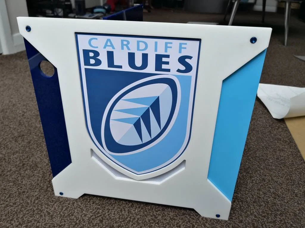

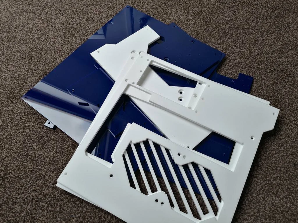

Soooooo, a parcel arrived! Yes, the Navy Blue has finally been sourced so it's time to crack on and actually build something :)
This bit was supposed to be light blue (as was the rear internal panel, but that isn't going to show anyway...)
So vinyl to the rescue!
Not going to have much free time over the next couple days and need it to be in working order for tomorrow, so bodged things together for now...
...And it lives!
A very 'temporarily thrown together' look and feel but at least now I can see the potential :)

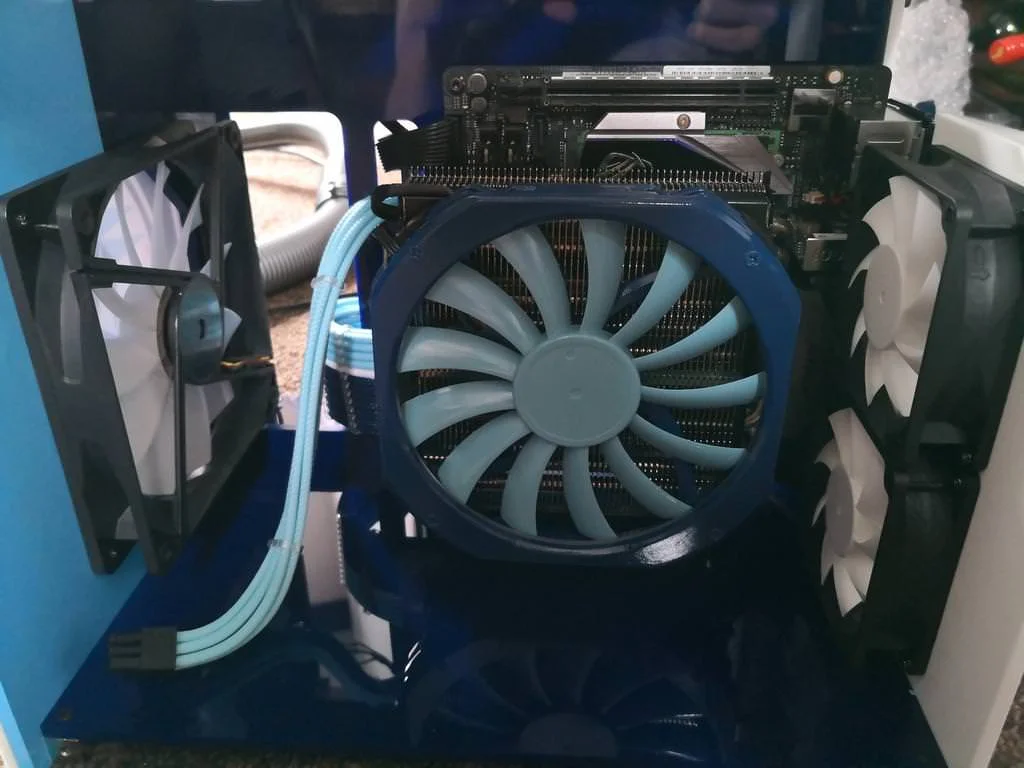

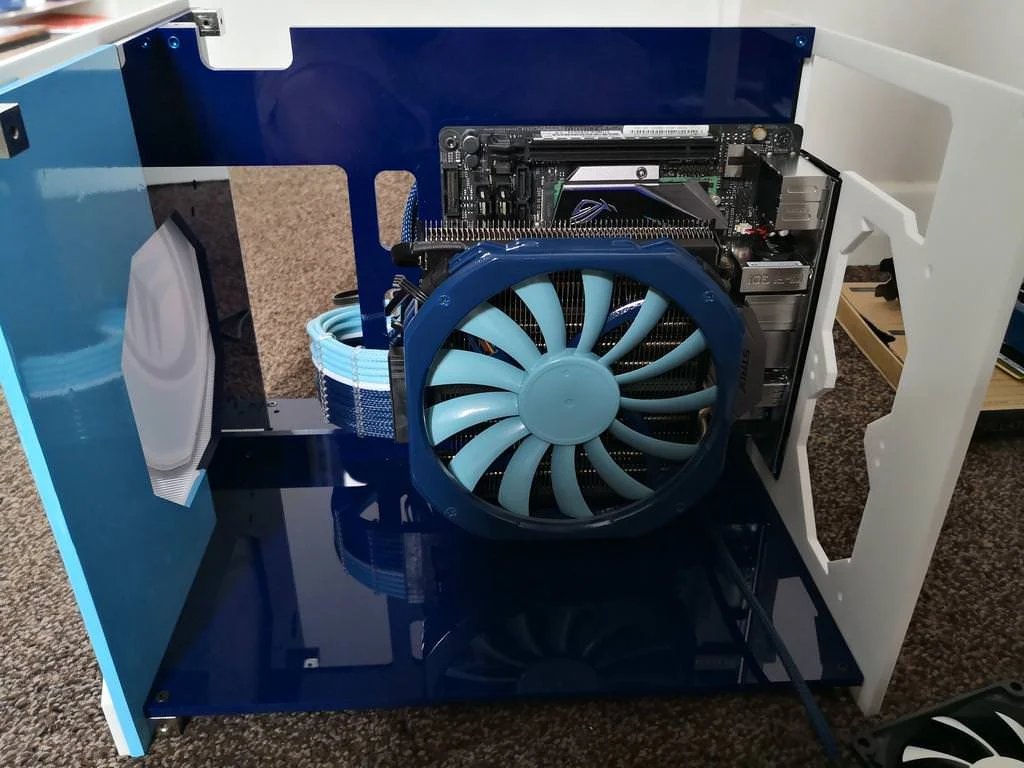

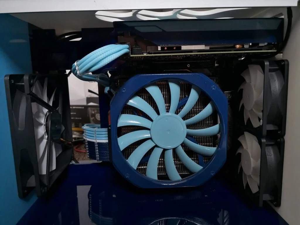

Got the fans in

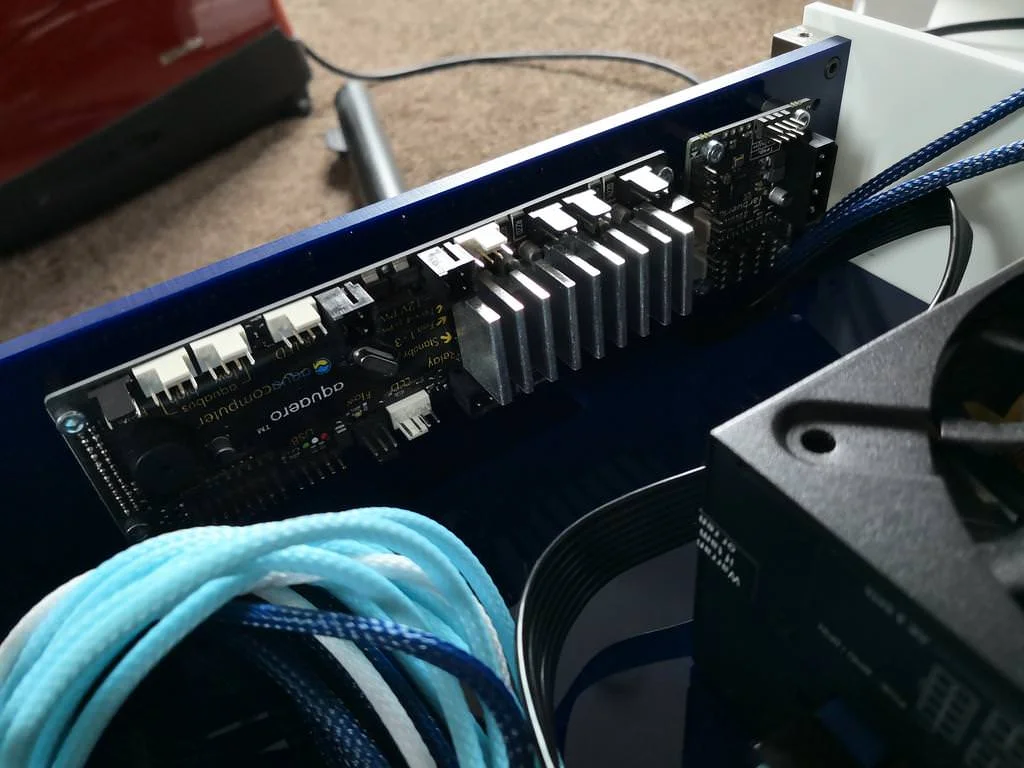

Installed the Farbwerk...

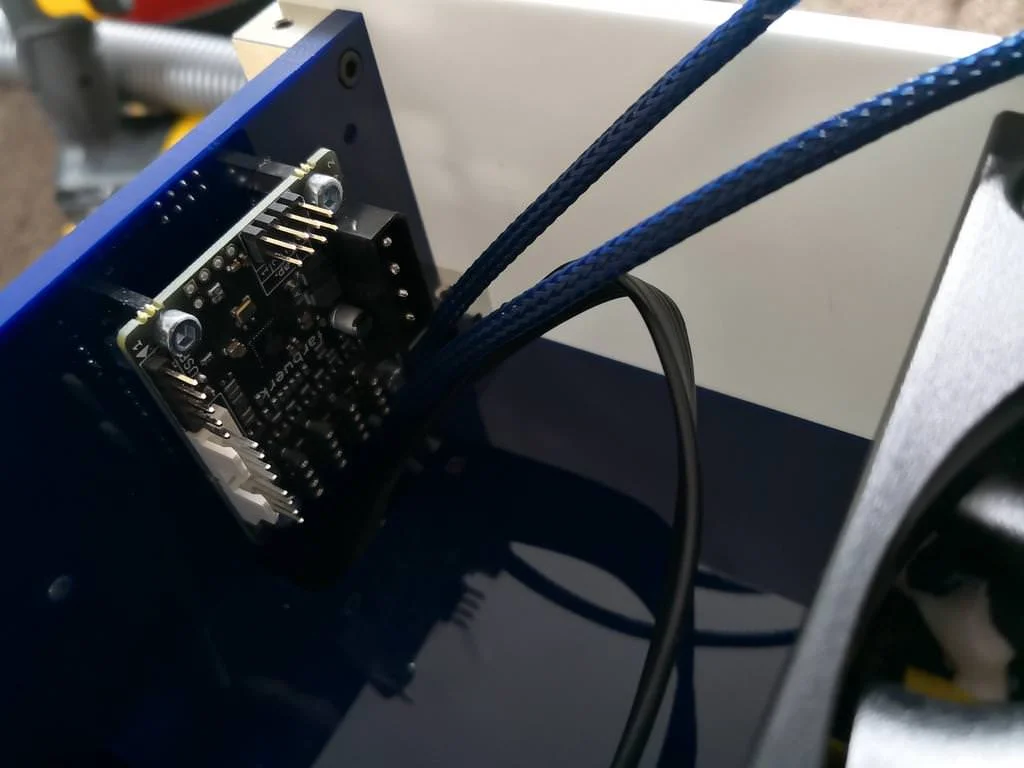

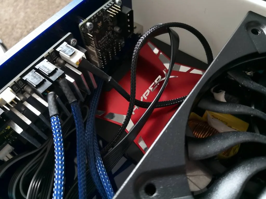

...And the Aquaero

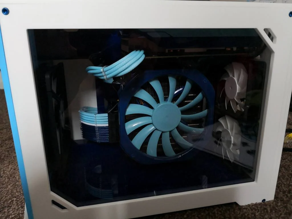

Started wishing I'd bought a bigger case but squeezed the SSD in
Yeah, gonna need to tidy this!

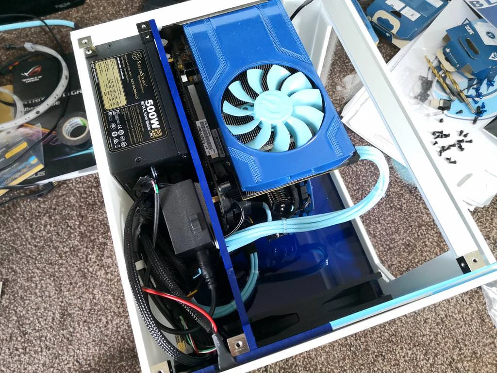

GPU in

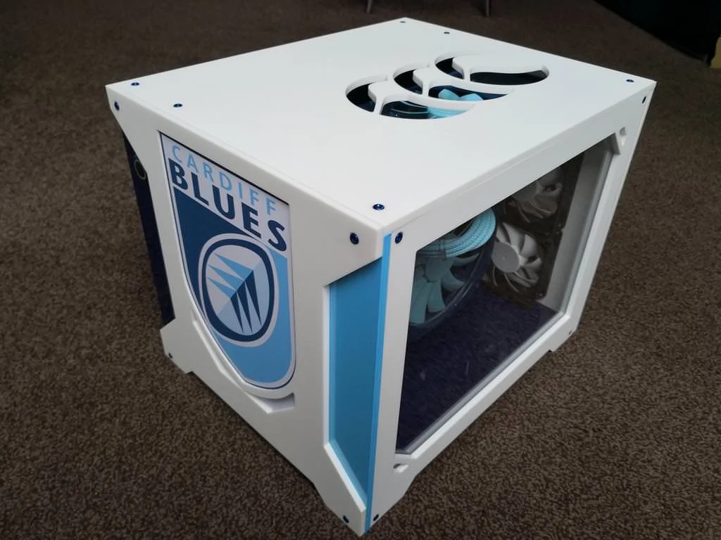

Case together just in time to start using for Speedway streaming :)
Now debating whether to put mesh under this so it matches the front vent...
Either way, quite happy with that for a days work! Hopefully crack on with a bit more at some point next week
Just need to make the guard for the rear fans, sort the lighting out, design something for the front fan, cut some vinyl for interior details, tidy all the cables and make the front logo light up... Should keep me busy for a while!

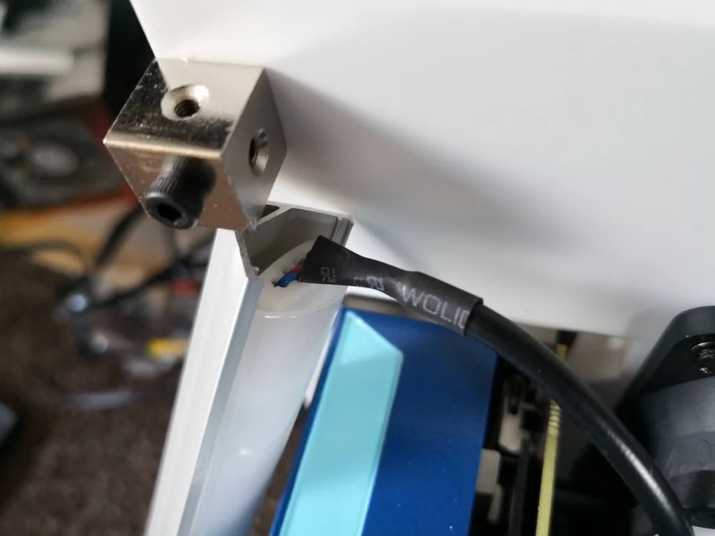

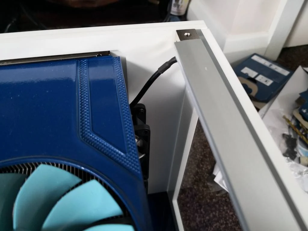

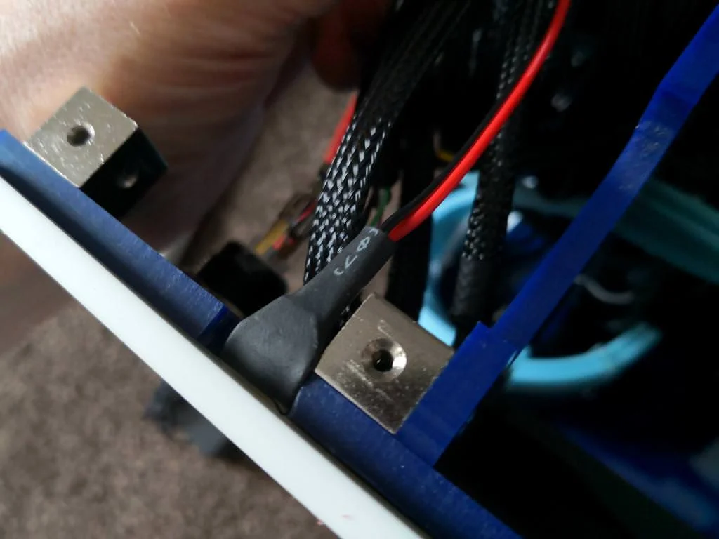

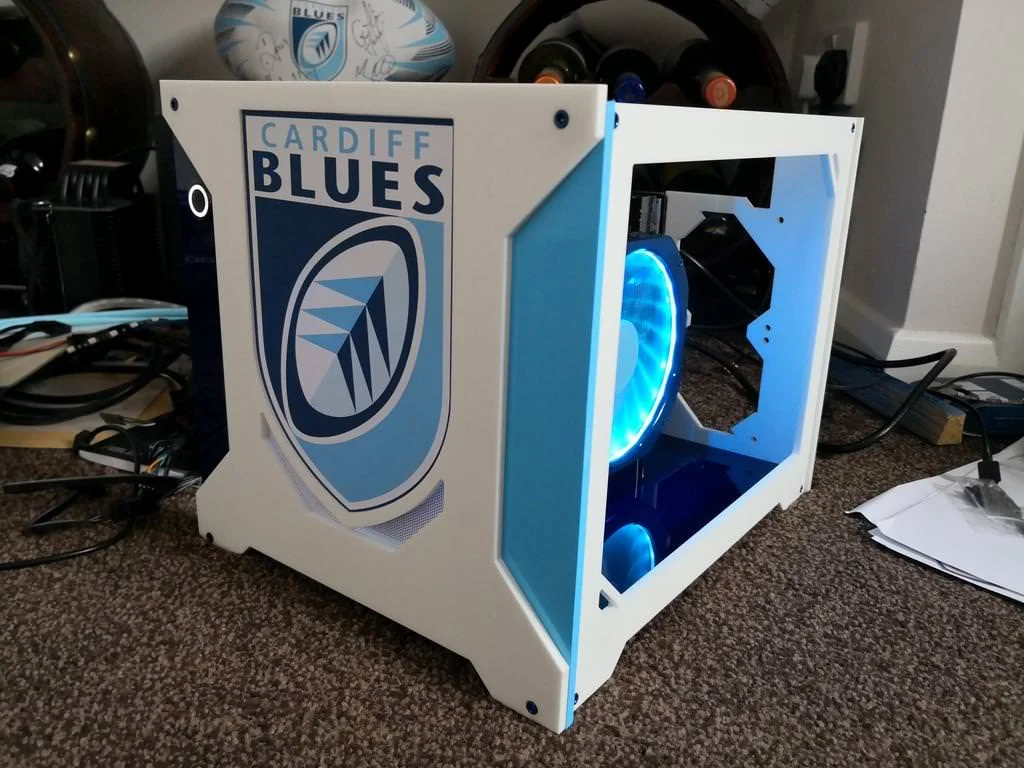

Only a tiny bit more progress for now, but I've mounted the LED strip properly with a diffuser.
I was originally going to mount it to the roof using strong double-sided tape, but then I noticed something... Yep, if you screw a bolt into each block it fits perfectly into the cavity on the ends of the strip, and holds it perfectly flat against the side and roof panels :)

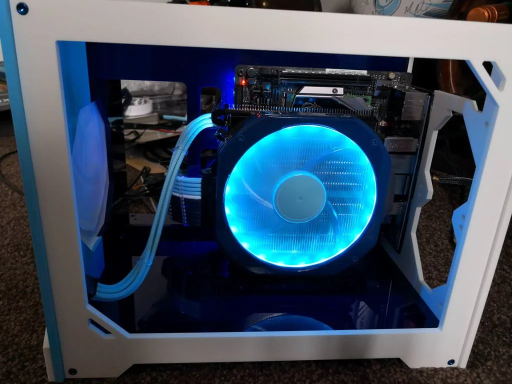

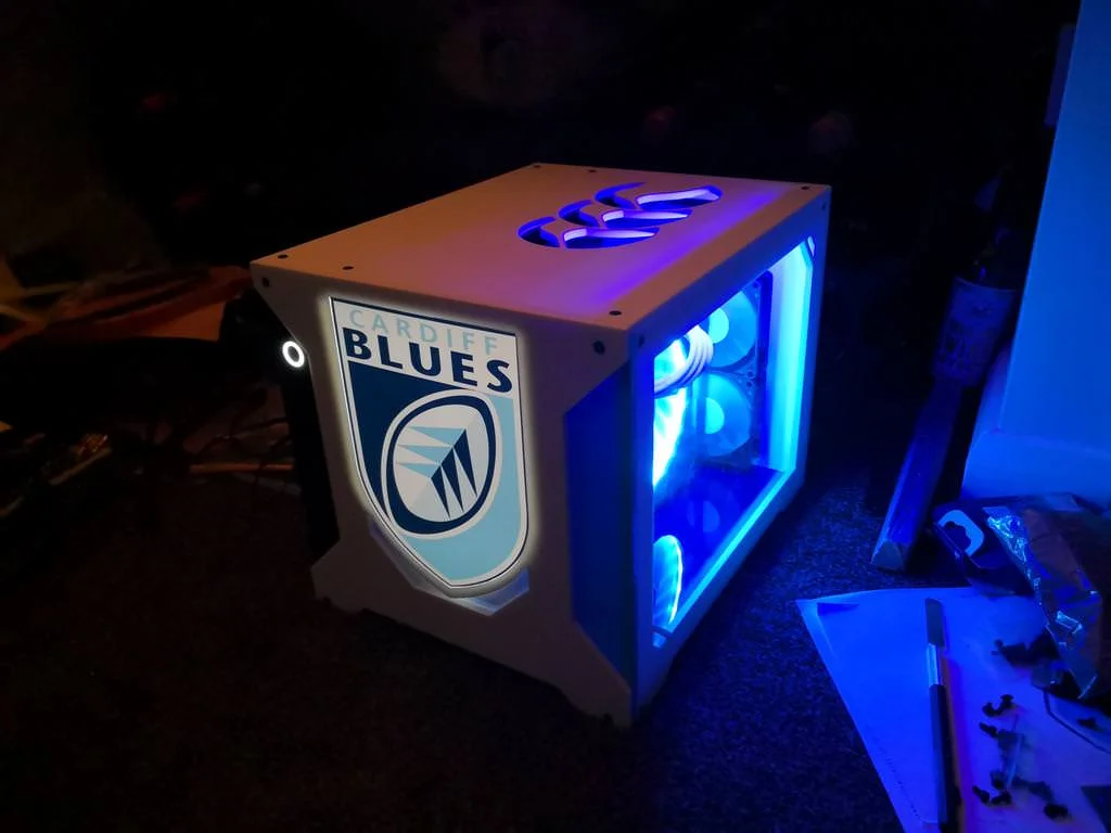

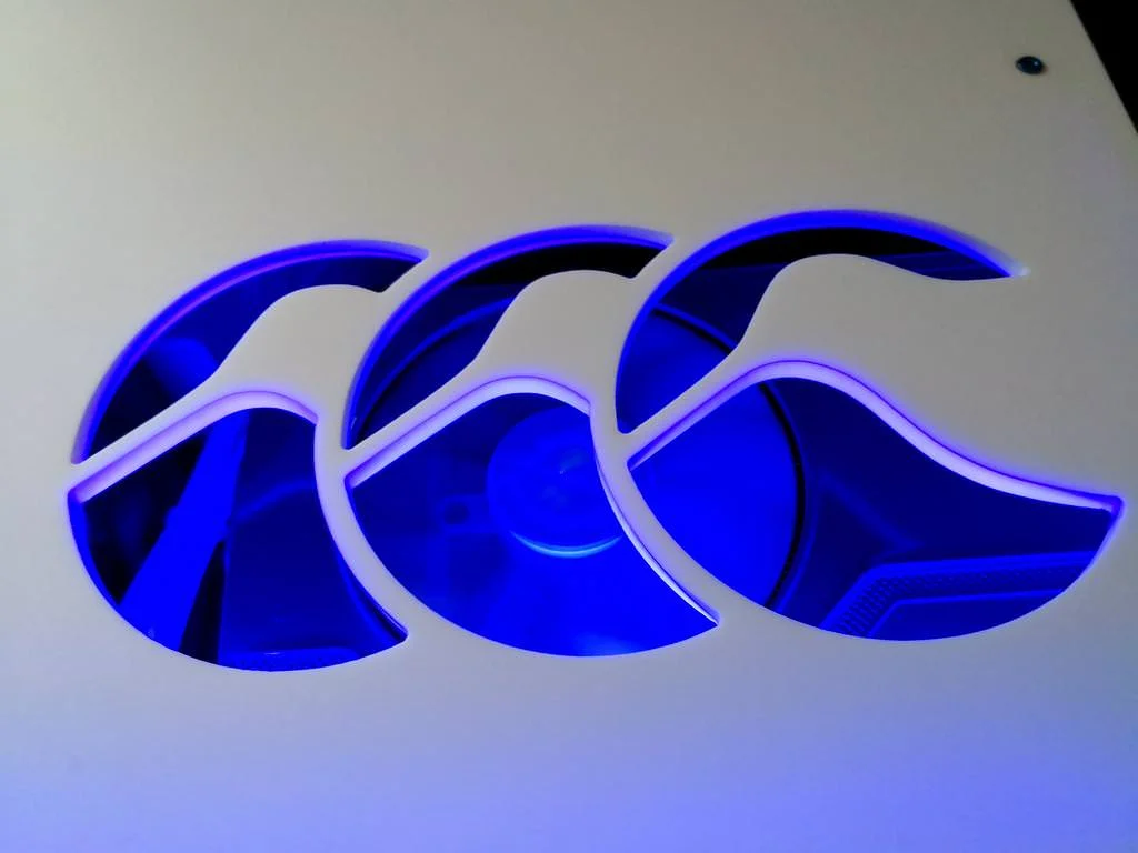

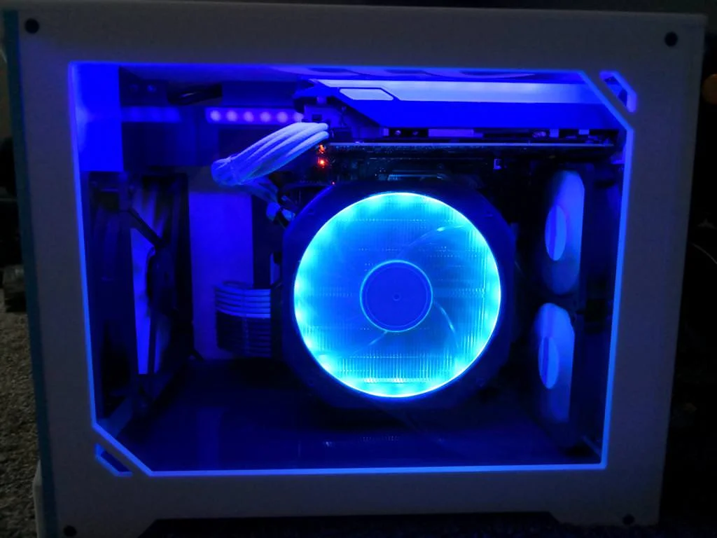

Didn't get time to set the lighting up properly (Speedway was on again!) but set it to blue and gave it a quick try.
Still loving the Halos :)
And I think this has made my mind up... Going to leave it open.

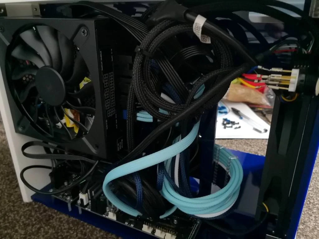

Only had a spare few minutes today between jobs but found time to fit this.
A few mm further over and this could have been an issue, but luckily it fitted perfectly :)

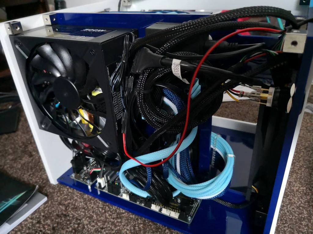

Even if it did mean even more wires around this side!
Getting a bit cramped now...

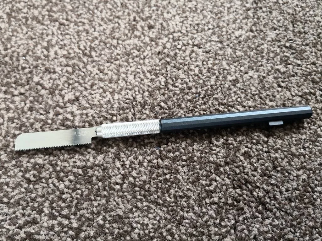

Also found the perfect tool for cutting acrylic accurately: This little beauty made by Tamiya for modifying plastic models

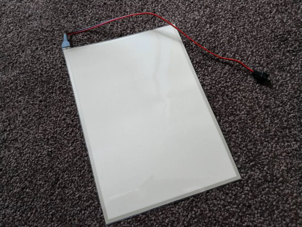

Once it's dark I'll test the EL Panel and have a play with the lighting (needs to be very subtle as it'll be under the TV and don't want it to be distracting), then it's headache time again as I try and figure out what to do with the front fan. Laters :)

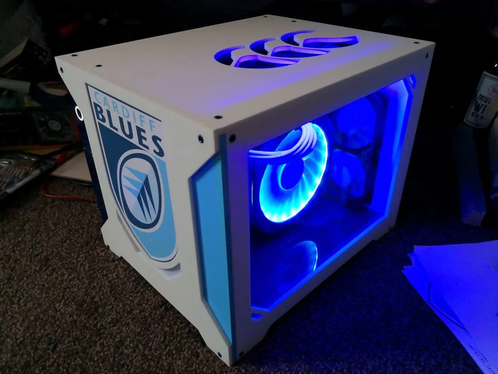

Tested the EL Panel last night at 5v so it's properly dim (none of the lighting is anything like as bright IRL as it looks in the picture) but still had this happening:
BALLS. Was hoping the light wouldn't shine through the white plastic but once it's properly dark in the room it shows through. Now the easy / common sense solution would be to cut the EL Panel to the exact size needed, but unfortunately due to the positioning of the wire and the cube holding the top of the case to the mid-wall that can't be done, so on to plan B: Cover the rear of the front panel in black acrylic, leaving only the badge + fan vent clear. Hopefully this will stop the light getting through but guess we'll find out later, if not will try it with some reflective tape instead.
