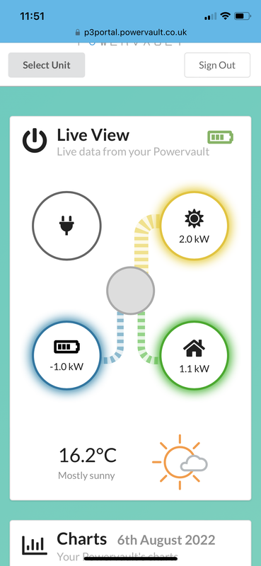

How does it know when to charge up?
Mine has a clamp meter so it detects flow of electricity going back to the grid then the BMS determines wether the battery can accept it or not and at what rate it can charge the battery.
For example.
