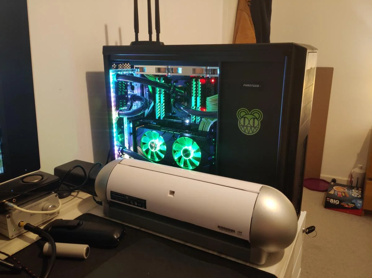

Good news. The CPU block LEDs didn't die at all, they are just completely blocked by the black coolant haha. I spent ages peeling the decals off the PSU, designed new ones and etc then thought "Sod it, looks better like that".

Being the weakest GPU I have it doesn't run terribly hot tbh. It's also much more of an office PC than my others. You can probably tell from the setup (plotter, enormous great A3 printer etc). I do have plenty of fittings left over too, so if something does come up it will be a ten minute job.

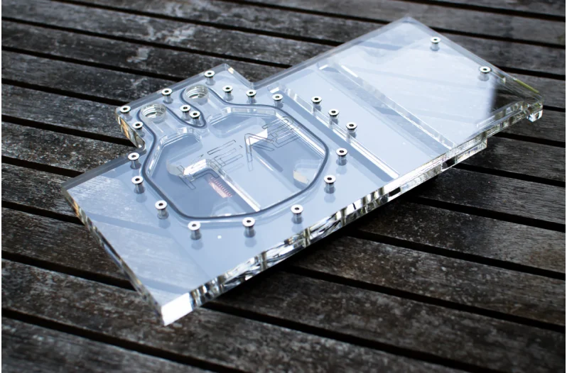

Ever annoyed I decided to pummel a few search engines trying to find a block for the GPU. It kept taking me to the site in France, so I decided to do some detective work. Turns out they make blocks for where blocks don't exist. I contacted the owner, got it all sorted and ordered. I got the clear finish acryl with the black Duraluminum block. It's basically copper alloy, 30% copper and 70% alu. Normally I would want full copper, but it adds 50 euro. Still, at least they are honest about that. I bet lots of Byskski and so on use that too. I would be concerned, but this card is not what I would call a hot sausage. It's much more cucumber like.
Should come with DPD some time next week.
Aluminium isn't a bad heat conductor but as @Chaos666 said, you have the potential (no pun intended) for galvanic corrosion. The further the metals are apart on a chart of galvanic potential, the worse the corrosion is going to be. I can't find much info on a 70/30 alloy but a chart shows "aluminium alloys" to be quite far apart from copper. Aluminium bronze is fairly close but that is only 5-10% aluminium, not 70. Unless the surface of that block is sealed and stays sealed, I think you may have corrosion issues if you have any copper, brass or nickel in the loop. All very common metals used in water cooling fittings and blocks and all very close in galvanic potential - ie won't set up a galvanic cell and corrode.
Could be that it's very well coated but it may be worth at least asking the question. It looks like the aluminium will corrode but also, I think you'll get build-up on the other metal parts - or it could just fill the coolant with the debris.

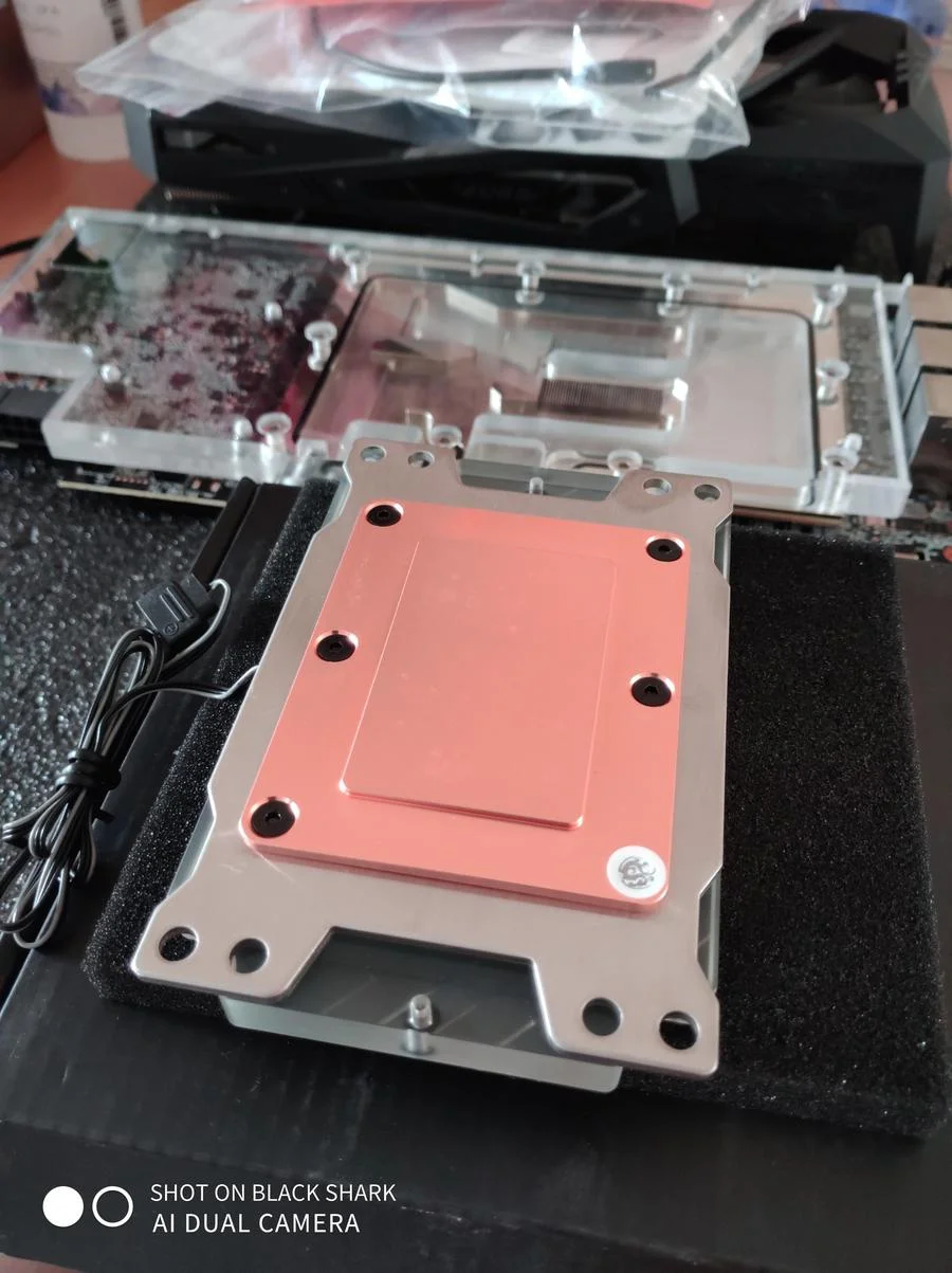

The copper option cost nearly half what I paid for the card tbh. I mean, at least they are honest. I bought this Bitspower block lately for my other TR rig...
Yeah, ain't never seen no copper look like that before..... This is what X1 states..

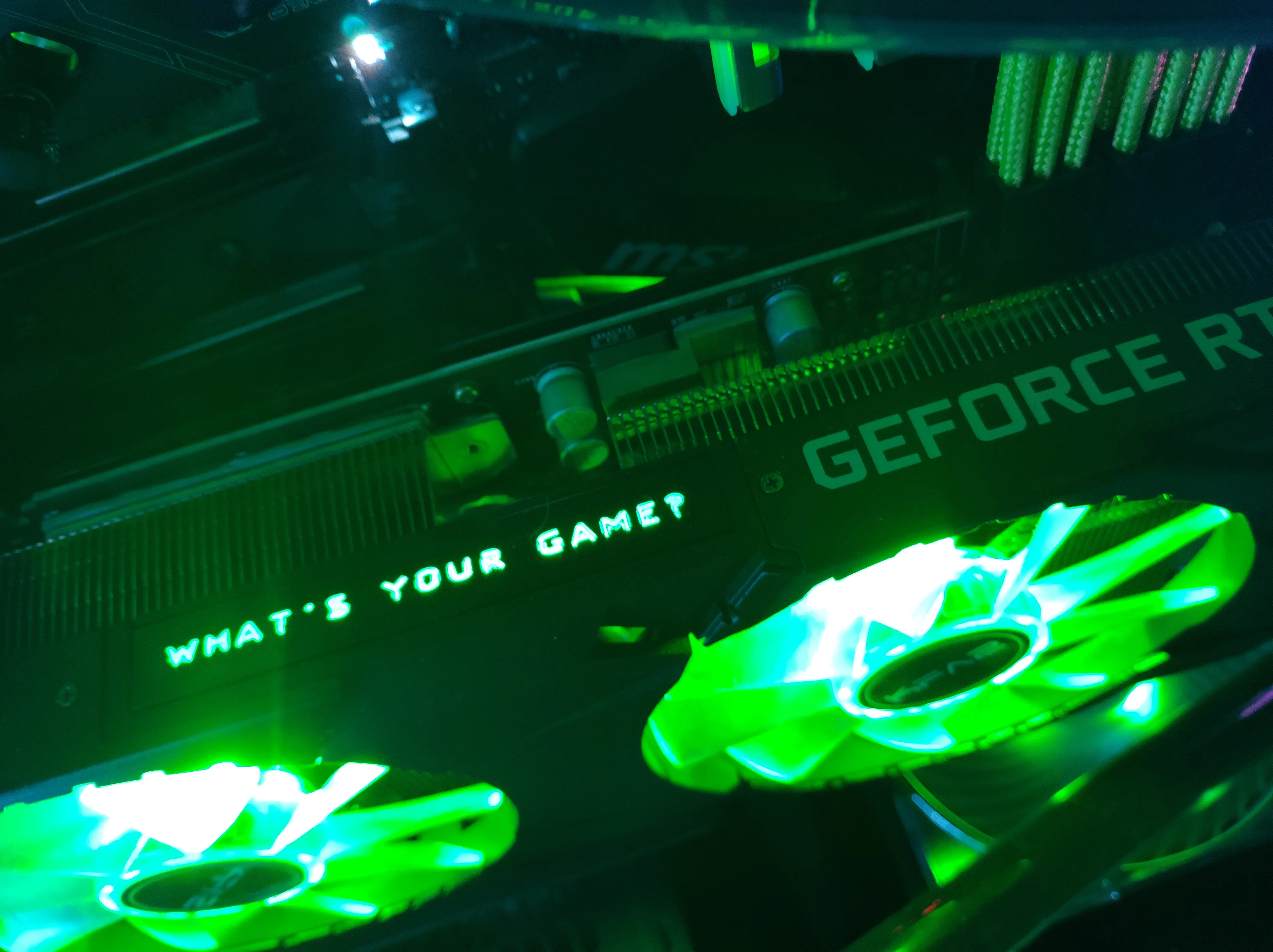

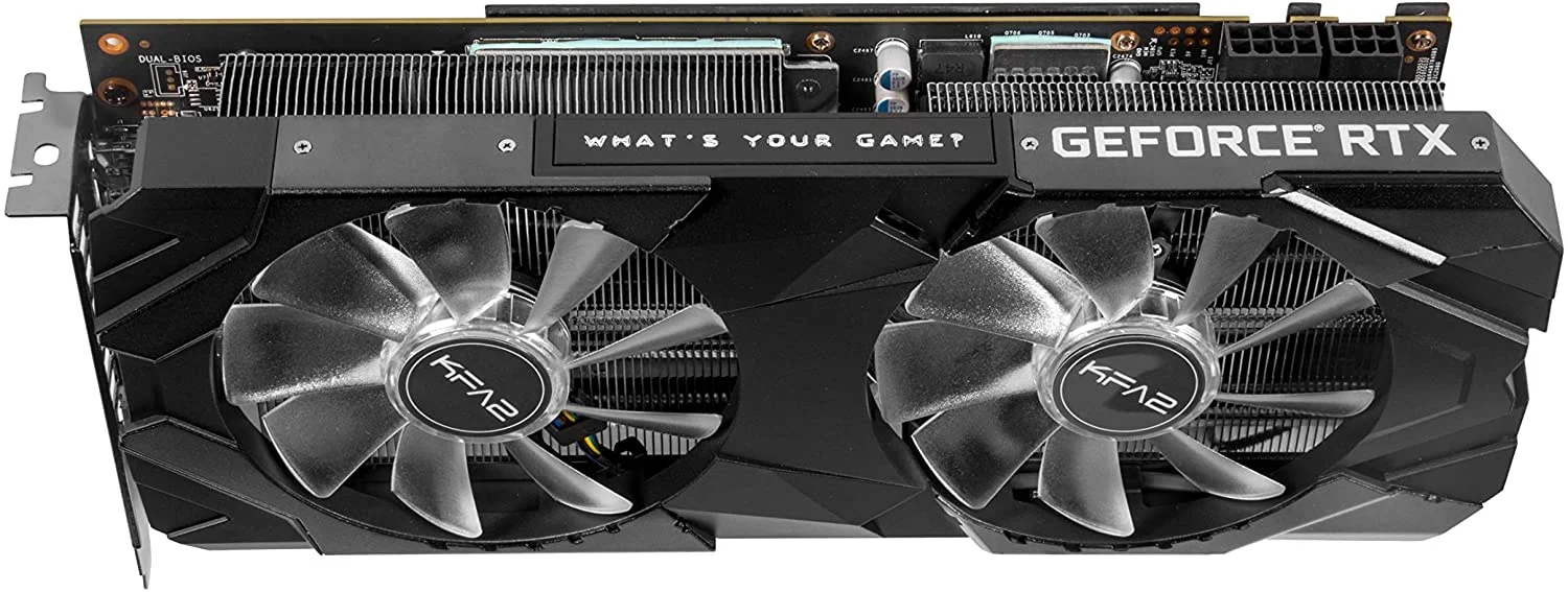

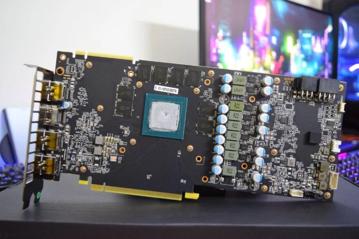

Remember how I said I hated 20 series GPUs because of the water blocks? well times that by a ****** MILLION. So I check and double check the website for my GPU. This is the GPU I have*
As listed on their website, hnyar.
https://www.kfa2.com/kfa2/graphics-card/kfa2-geforce-rtx-2070-super-ex-1click.html

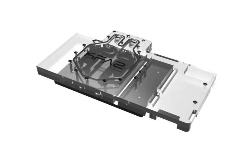

OK, so simply match the dimensions, buy the block for my card et voila !
Totally sorted. NOT. Tonight by off chance I glanced into the rig.
Eh? that looks totally different. That is because IT IS. So I go back to KFA2.
So one SKU of card on the page for it shows two completely different PCBs. The one I thought I had.
And the other one I didn't think I had.
Un bloody believable. Thankfully he does actually have the actual block that actually fits this actual Fing card. Or that would have been one hella expensive return back to France.
Looks like it may just be a matt finish to that copper. Have a look where it's been chamfered around the screws and it looks more like what you're used to. Also, perfectly possible to get different compositions (alloys) of "copper" in the same way you get different compositions of steel. Just changes the properties a bit. For ease of machining, you wouldn't want the copper to be too gummy as it just fouls the tooling so doping it with something that makes it machine better would help cut down on costs and improve the finish.
Possibly. Normally I would assume with Bitspower it would be pure copper, but tbh? their new stuff seems way cheaper than their old, and it felt pretty light. That said whatever that is? it works much better than whatever Bykski used on their nickel plated one I have in this rig now.

Nobody makes a block for this card. No company, other than this guy in France who seems to be very talented. I mean dang, you wanna see some of the stuff he creates man. Some of it is just pure art. He also has a service where he charges 130 euro for making a completely custom block. He seems to get off on making blocks for cards that you are otherwise screwed on.
https://hybridcooling-modding.fr/home/125-waterblock-rtx-2080-msi-lightning-z.html
For example. Only Bitspower made one that actually worked (Bykski's one wouldn't even fit lmao) and BP wanted £250 for theirs.
I have had the card about 11 months now (checked the order earlier) and never could find a block for it.
