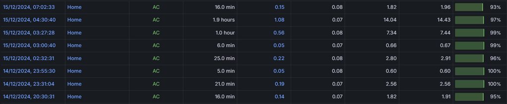

Anyone else getting Octopus iGo constantly splitting overnight charging to lots of slots?
I'm using Teslamate since I got the Model Y to track everything, and in the Octopus app it will charge from 23:30 - 05:30 but in 3-6 slots
Here's the last charging stats reported by the car earlier this week:
The one at the bottom is just plugging in the car, 16 mins before it realises.. but then 6 distinct charging slots.. then the last one is just the Mrs waking the car up before she goes out, so its heating the cabin..
I'll have to capture the Octopus app and correlate it, but it's never just one slot overnight anymore.. it's usually 3-6 from memory
[edit] actually 8 slots is the worst example I can find over the last 3 months..
