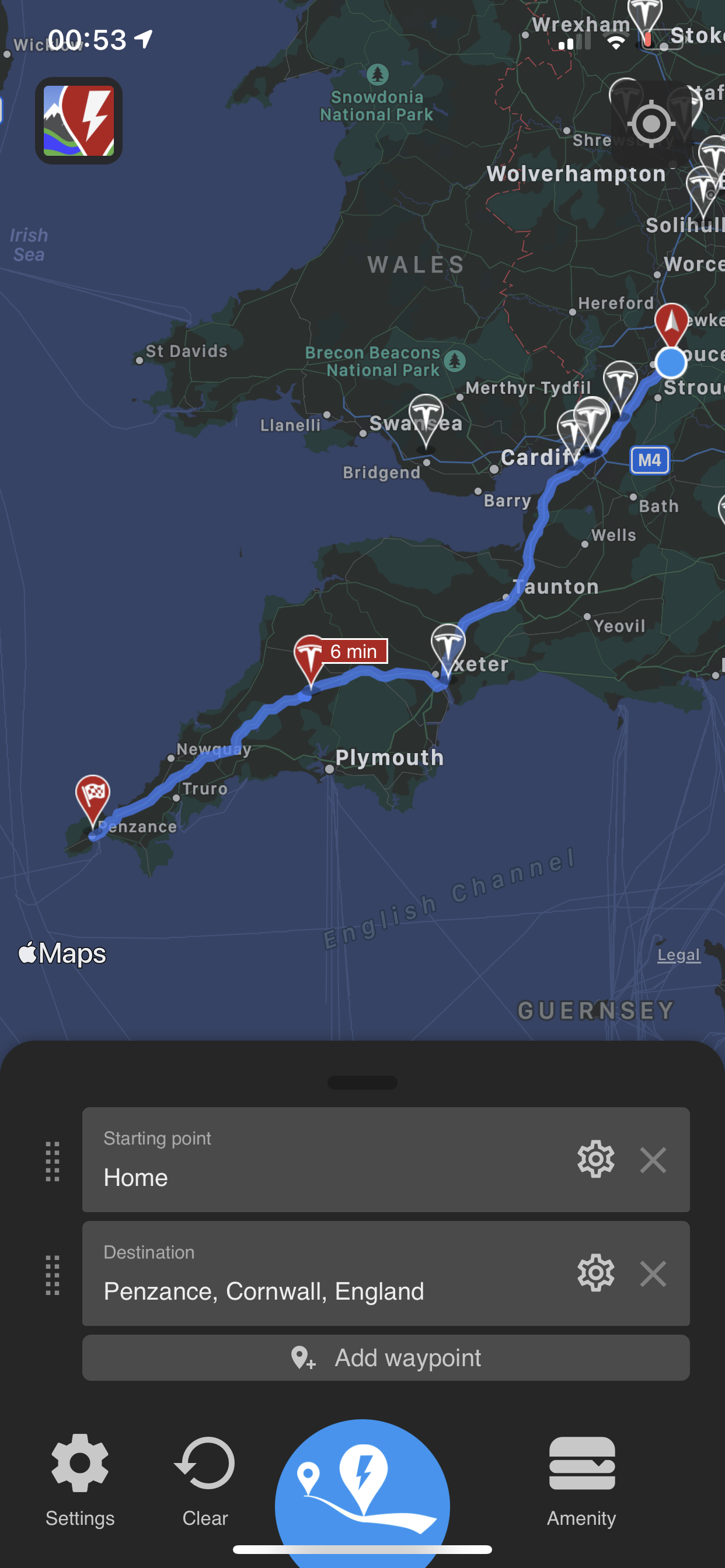

Range anxiety is being conflated with range flexibility. Without not so insignificant compromise, they can't do the quintessential British escape -> 100 mile journey to somewhere pleasant, pootle around to local sites, 100 miles back.
what's not flexible about this?
