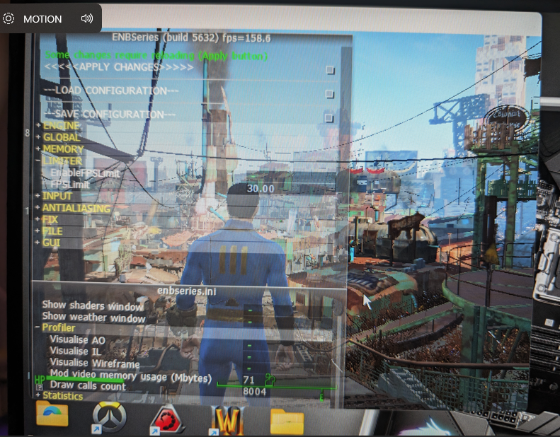

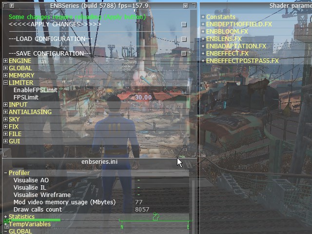

I tried with just the ENB, but there seems to be some modifications that I can't figure out. My draw calls are about half of what they should be.
Edit -- I see they were uploaded!
Preliminary run:
That's about the best I can do for now. Windows 11...
GPU is RTX 3060
CPU is 7800X3D 2200FCLK, -30 CO offset (makes no difference as CPU runs 5050Mhz regardless), 6230MT/s 28-35-36-28 memory 1.45V

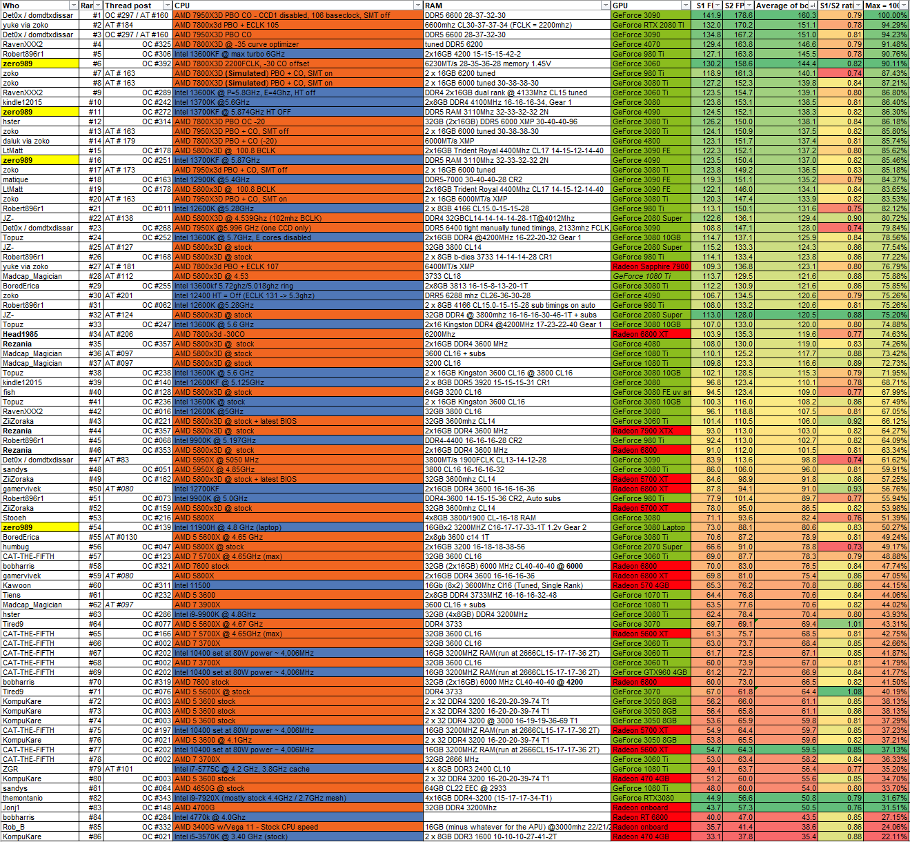

That gets you to position #6, and here's the top 11 (see we get to see your 13700KF run too):
Or filtered for only your results:
and all Zen 4 3D results:
Finally, the full results table in a spoiler although I had to zoom out a lot for that:

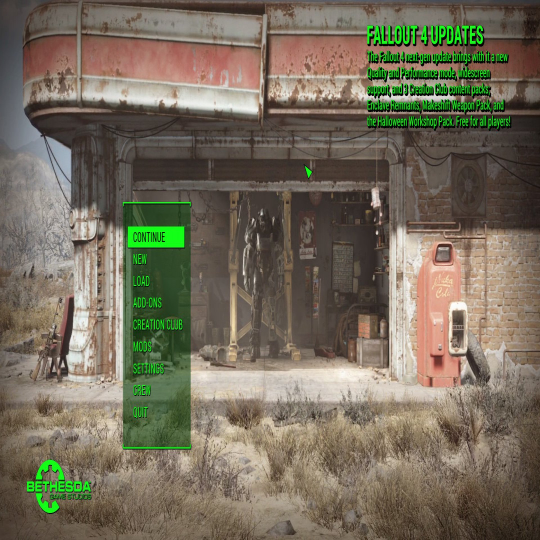

GameGPU tested the new update:
The Nvidia dGPU bias seems to still be there,but AMD CPUs seem closer to the Intel one?

Its a 20 year old game engine, Nvidia do better with these ancient broken unoptimized engines for the same reason AMD do better with modern DX12 engines, it's software asynchronous threading on Nvidia GPU's which AMD don't support and hardware asynchronous threading on AMD GPU's which Nvidia do not support.
They are not testing any of the X3D chips, with the 14900K being 5% ahead of the Ryzen 7600X, i'm always a bit suspect of people reviewing every CPU from the past couple of generations except the best ones from AMD.
I don't really trust anything that's on there.

Not sure about the CPUs.
Taking the 4090 for instance, current vs next gen and Intel 13900 vs AMD 7950X is:
current FO4 = 185 vs 173 = Intel was 7% faster.
next gen FO4 = 177 vs 155 = Intel is 11% faster.
Core scaling looks a bit better although a pity that they use a smaller selection of CPUs for that.

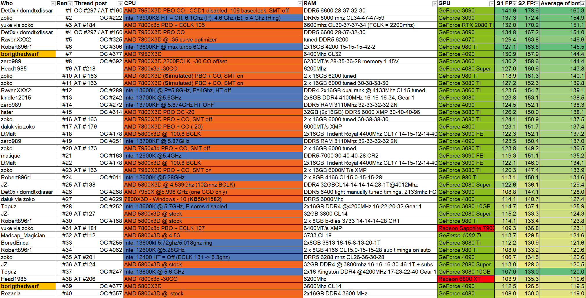

Your 7950X3D score puts you in the top 10 at number #7.
While the 5800X3D score is at #39
Filtering to only 7950X3D and 5800X3D:
And finally just your two scores:
Average of both went up a bit over 20%.
