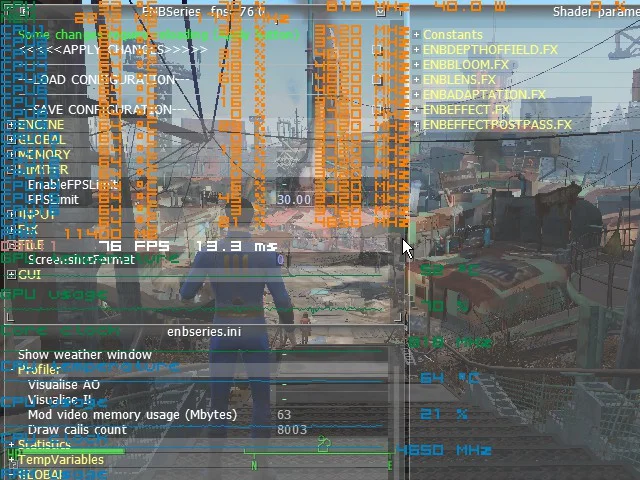

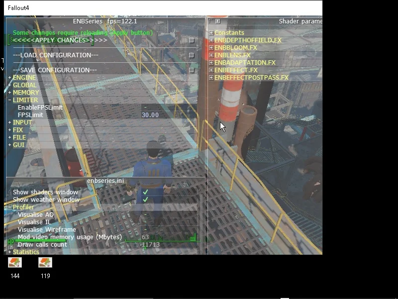

Corvega gives me 84.6 at 11711 draw calls
Diamons city gives me 98.9 at 8000 draw calls on the dot
still the lowest score of the bunch but its still a slight bump, always check the Bios :P

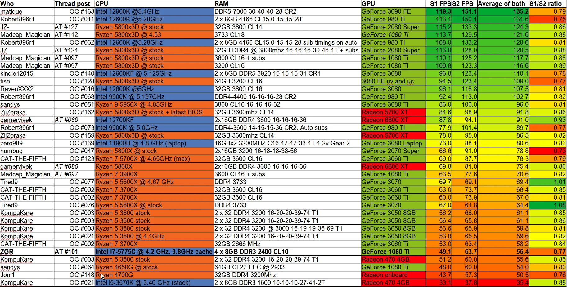

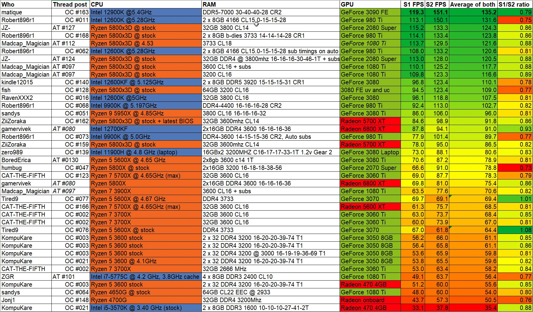

Well, that's definitely the top score so far:
Still, I'd rather suspect your 12600K rig was a bit cheaper!
I suspect the reason why the Ryzen 7 5800X3D is underperforming with an RX5700XT is down to the game prefering Nvidia dGPUs and increased AMD driver overhead. Also look at the Ryzen 7 5800X and RX6800XT results compared to the Ryzen 7 5800X3D results and the RX5700XT numbers. There is about a 21% to 22% increase in performance using a Ryzen 7 5800X3D with a much slower dGPU. I will add some results with an RX5600XT with my Ryzen 7 5700X and see how it performs. Then hopefully I can do the same with a Core i5 10400.

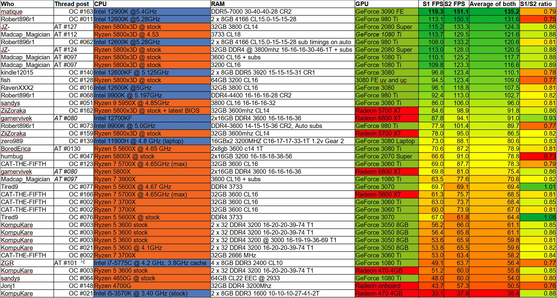

Ok,benchmarked game with an RX5600XT. I used the latest supported driver.
I used an average of three results for each scene.
Corvega=61.33FPS(11709 Drawcalls)
Diamond City=75.67FPS(8022.67 Drawcalls)
At some point might try the Core i5 10400 with the GTX960 4GB and RX5600XT to get some more data for the table.
So with the rest of your system being the constant, your two Ryzen 7 5700X results do vary by around 13% or so:
meaning your two R7-5700X entries on the leaderboard have a few gaps of other scores in-between:

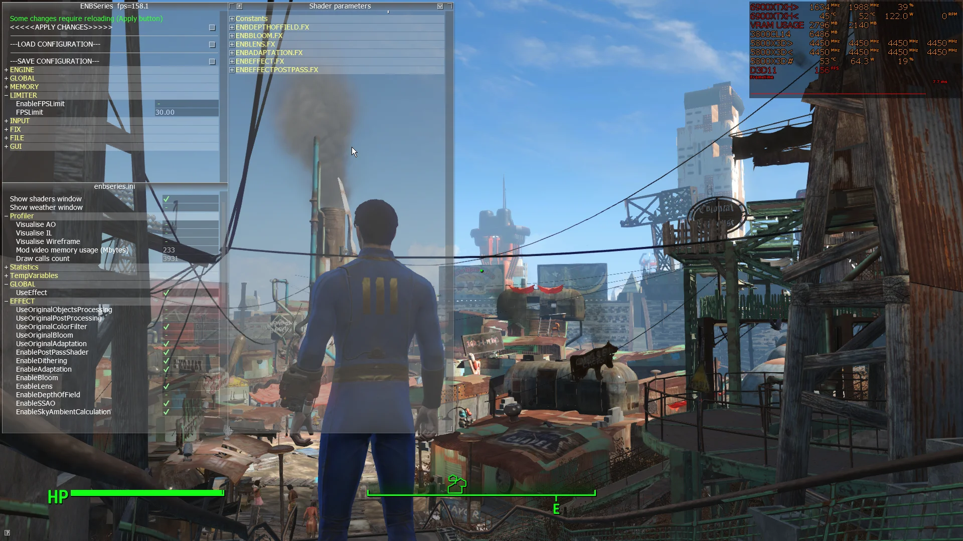

Hi folks. Trying to run this now, but I seem to be getting higher FPS than everyone else so wondering if I am doing anything wrong?
Do i need to change resolution, or can i just follow the instructions in the OP and use the default settings as chosen by the ini files? That's what I've done below but this methodology for benchmarking seems a little odd to me.

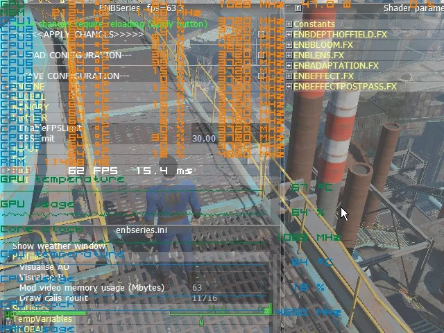

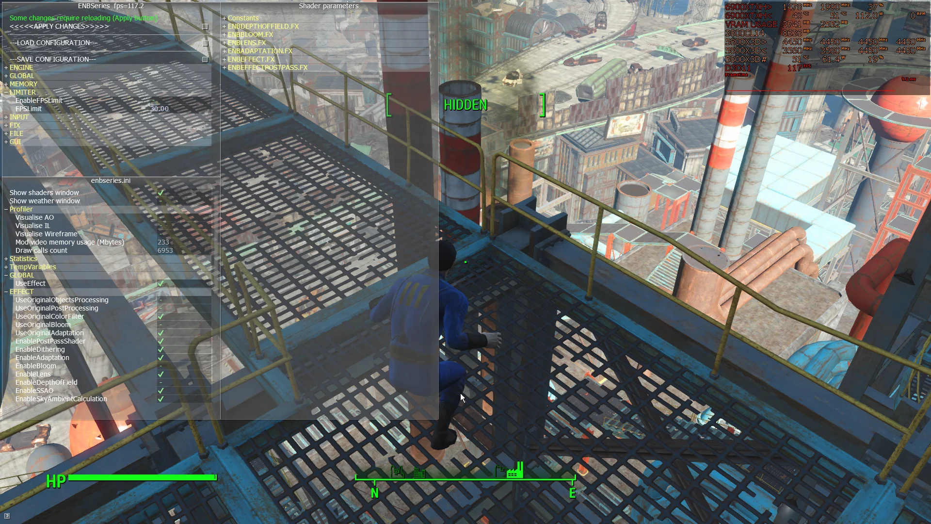

Also I tried to copy the exact area where some results were submitted, but my draw calls were way lower than the amount you need to take the result, so I had to position the camera in a different spot to get the desired number of draw calls. See my example below.

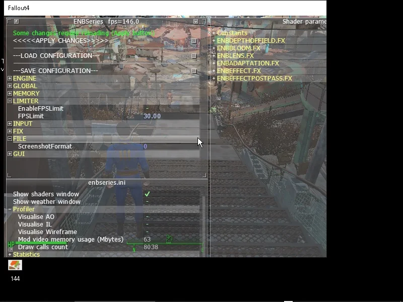

Here's the highest draw calls I could get in this area where trying to position the camera in a similar area to others.

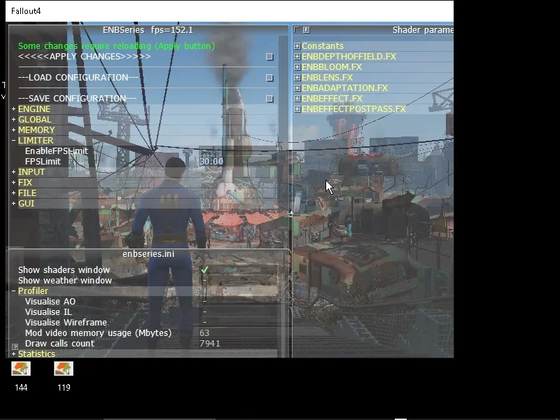

Second area - I can't even get over 3900 draw calls, and getting 3850+ is almost impossible.
Am I doing something wrong? I was under the impression you take a screenshot once you have the desired number of draw calls on screen.

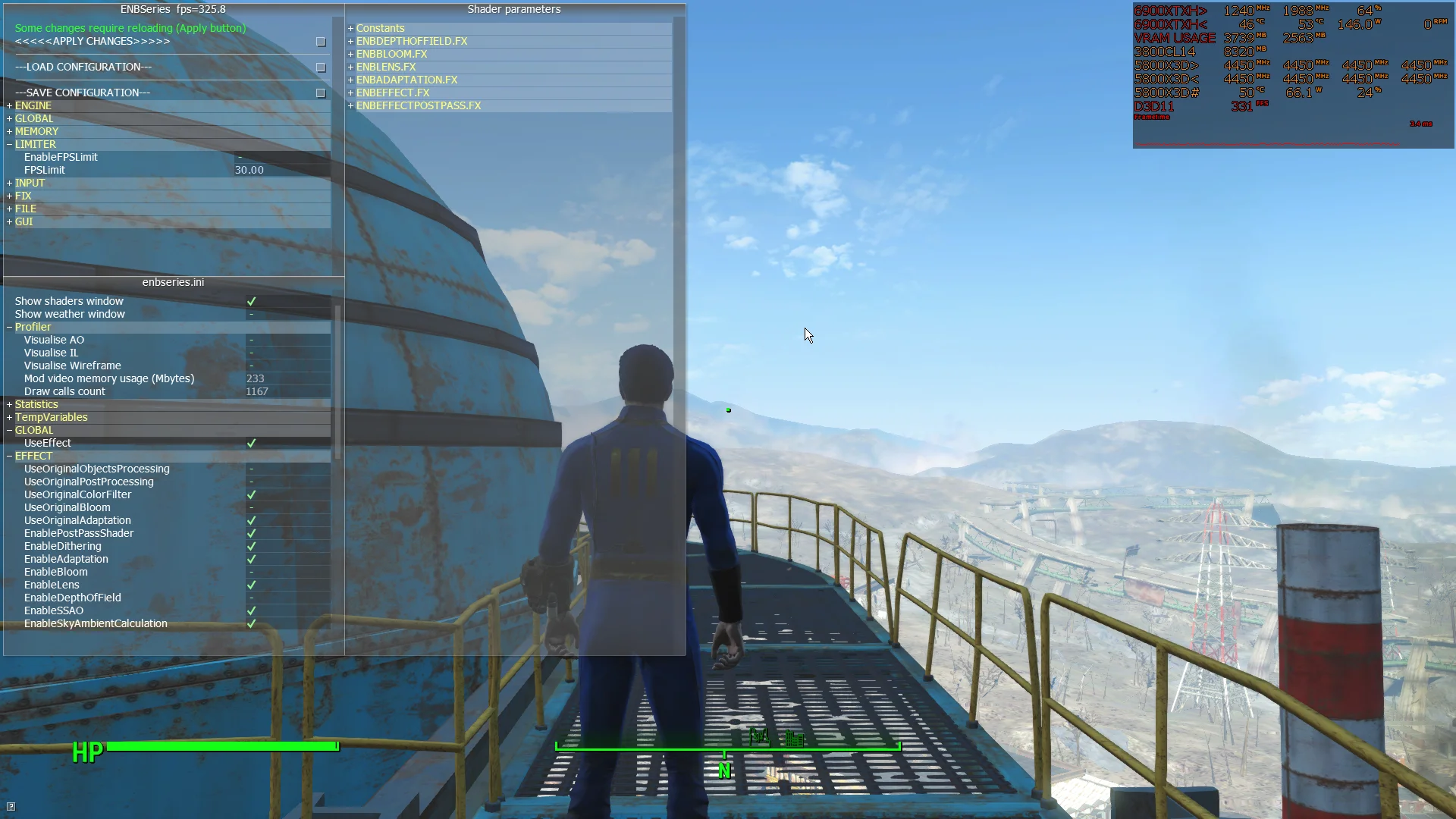

Some more scores, can probably improve on these if I push past my current overclock settings (shown in spoiler below).
Can't get anywhere near the required draw calls, guess it's an AMD driver thing in this game, so I just tried to get as high a draw call count as I could in the same areas as others took screenshots of.
5800X3D @100.8 BCLK
2x16GB Trident Royal 4400Mhz CL17 running at 14-15-12-14-40
6900 XT
22.5.2
Results

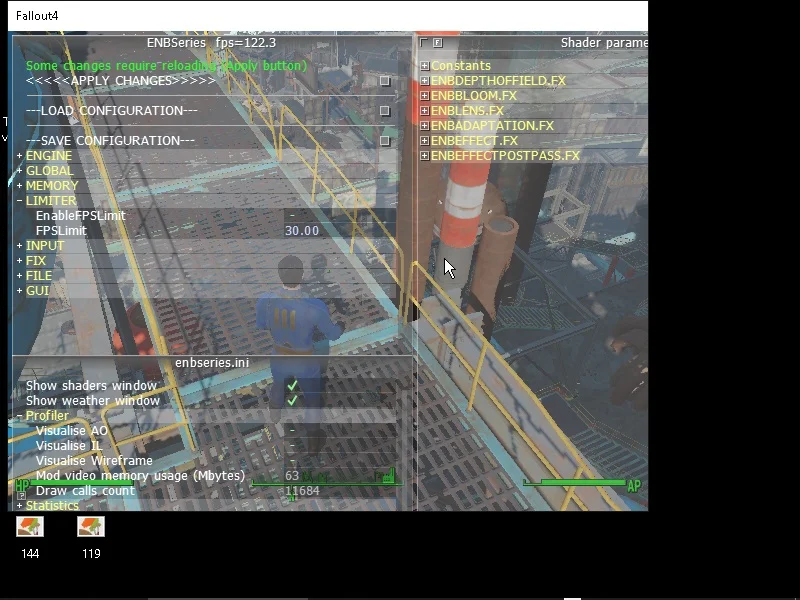

Yes, the benchmark resolution should be 480P windowed. The only thing some of us had to change was our desktop resolution so we could see something; yes eventually we took a screenshot but the save does not point to the correct place to get the 11,700 or 8,000 drawcalls so some moving of the camera (but not the character) is required - which is hard to do precisely in a 480P window in a 1440P or higher monitor. The various screenshots through should give you a hint of the angle the camera needs to be.
